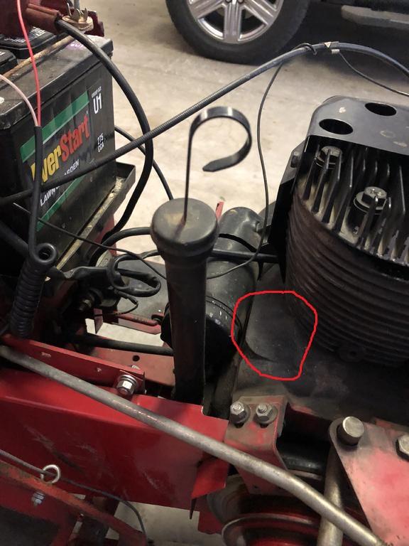

Jim anderson 77 #1 Posted January 14, 2019 So I want to start with fresh lubricants so I have a good baseline for the recent acquisition. The owners manual calls for engine oil of SAE 5W-20 or 5W-30 when operating below 32F, SAE 30 above 32F. For the transmission on an 8 speed it is calling for SAE 140. I know oils have changed since the manual was published, so i’m wondering if these are still the preferred types, or are people now running different grades or synthetics etc. Basically my question would be: what do the experts on this site recommend I be putting in the tractor? Current use will be cold weather for plowing snow. I appreciate the help in advance! Jim 2 Share this post Link to post Share on other sites

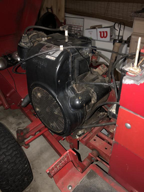

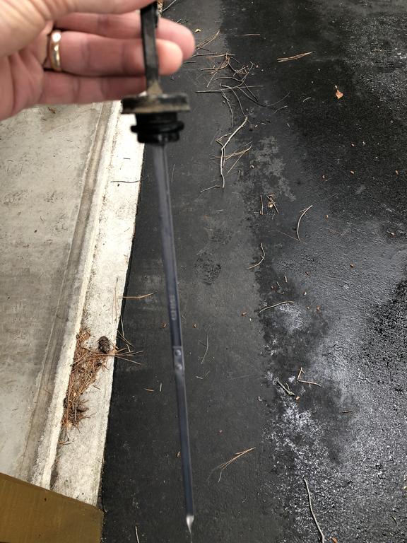

tunahead72 2,662 #7 Posted January 15, 2019 Hey Jim, I'm puzzled about something in your first photo. The oil dipstick on my 1981 C-105 engine doesn't have a handle, it's just a screw-in plug with a measuring rod that reaches inside the engine. I wonder if your engine has been modified, or replaced. Does your engine rest on a cradle, with rubber isolation bumpers to reduce vibration, or is it mounted directly to the frame of the tractor? This won't affect what weight of oil you put into it, but it could affect how much you need to do an oil change. My K241AS Kohler engine has a smaller oil pan and only takes 1-1/2 quarts, while the K241S on my 310-8 takes 2-1/2 quarts. I don't know for sure how much your K301 is supposed to take, you should check your manual if you have one, or download one from here. Share this post Link to post Share on other sites

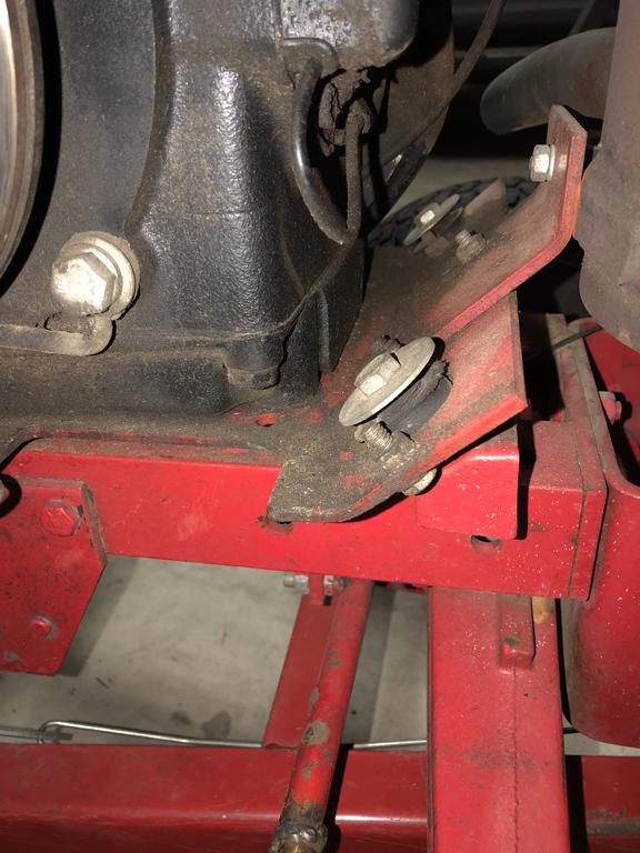

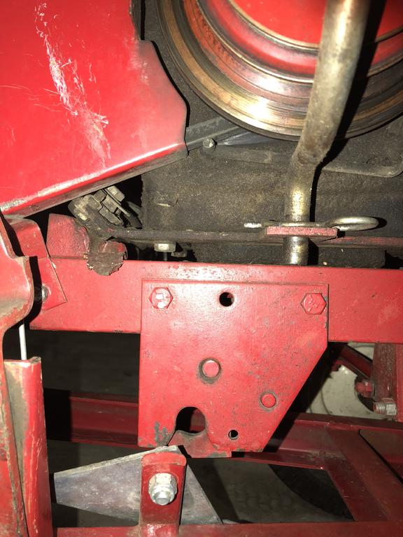

Jim anderson 77 #8 Posted January 15, 2019 Tunahead72- We’ll, I’m as big a newbie as one can be to this world, so I certainly don’t have the answer as to if the engine is new or a replacement. Here is a pic on the front right side of the engine mounts. Apparently I’m out of room to upload another pic of the rear mount, but it seems similar. Looks to me like the engine is direct mount to the frame, I’d love to hear some of the experts chime in prior to my oil change. The owners manual I got with the tractor calls for 1 1/2 quarts, so I figure I can start with that and if I come up short on the dipstick, just add a bit at a time until it reads full. Share this post Link to post Share on other sites
roadapples 6,987 #9 Posted January 15, 2019 That's a cradle mount.. 1 Share this post Link to post Share on other sites
gwest_ca-(File Mod) 12,483 #10 Posted January 15, 2019 This link will get you to two pages from the lube chart. These contain the latest recommendations for lube so may be different than the operator manual. Click on the picture and again on the next page. Garry 1 Share this post Link to post Share on other sites
tunahead72 2,662 #11 Posted January 15, 2019 Yep, cradle mount, which is the way it would have come from the factory. As opposed to what I was calling a direct mount, where the engine is bolted directly to the horizontal rails of the tractor frame, with no cradle or rubber bumpers. So 1-1/2 quarts is the right capacity. I usually start with a little less than that when I change the oil on my C-105, just in case I didn't get all the old oil drained out. Then start it up and let it run for a few minutes to warm it up and let the oil circulate, and check for leaks. Then let it cool down, and check the level and top up from there. I'm still curious about the dipstick. Can you send a photo of that when you get a chance? If you hit a limit again trying to upload a photo, some kind soul here on the forum will probably suggest gently that you can become a Supporter for a small annual fee, and get unlimited uploads as one of the benefits. That person wouldn't be me, of course. 1 Share this post Link to post Share on other sites

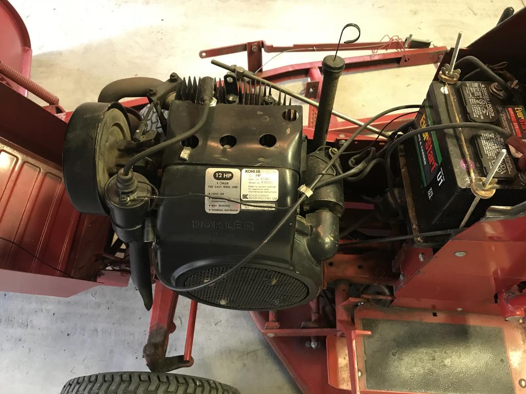

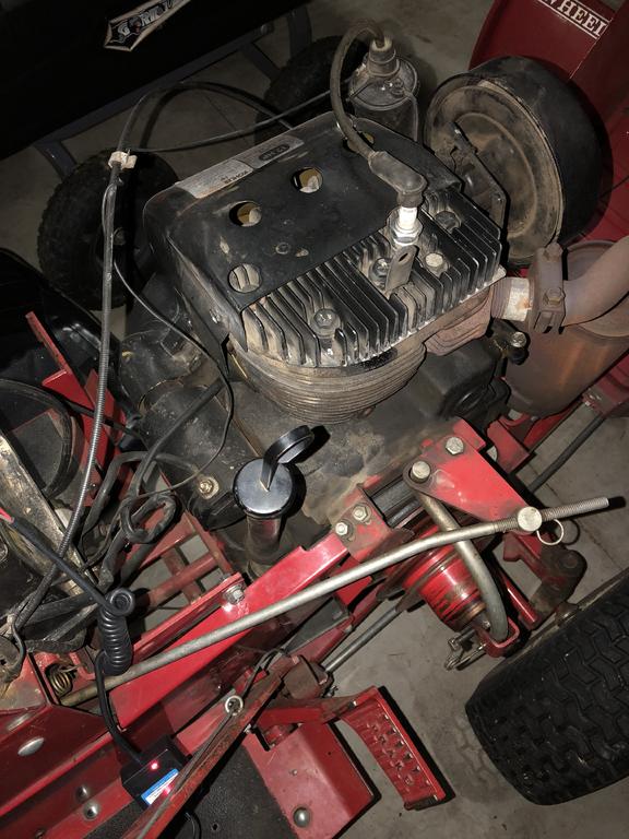

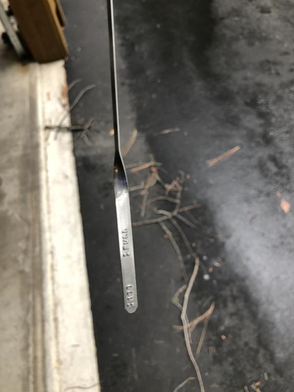

Jim anderson 77 #12 Posted January 15, 2019 Well tunahead, I took the gentle prod and became a supporter. I know I’ve certainly spent money much more foolishly, and with all the knowledge and free support here I’m sure it is well spent! To the previous subject, thanks for the advice on how much oil, and I am now able to post extra pic of the engine rear mount and oil dipstick as requested. The 90 degree twist at the bott9m of the stick necessitates a 90 degree turn to finish inserting in the engine, but seems about as stock as can be. 2 2 Share this post Link to post Share on other sites

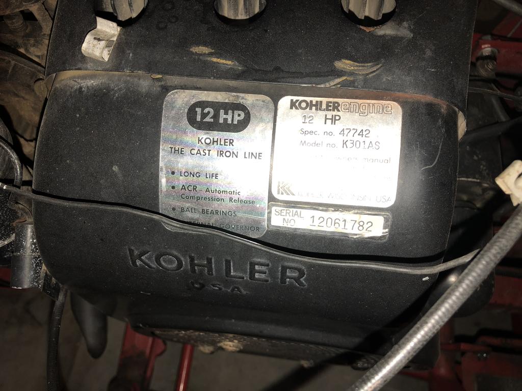

WHX?? 58,052 #13 Posted January 15, 2019 (edited) 14 hours ago, tunahead72 said: it's just a screw-in plug Sounds like you have an older motor Ed. Or maybe someone used an older block to replace a ventilated one??. All of my k's have the plug dipstick but all are pre '68. even the 241's with the short base pans. I'm thinkin sometime in the late 60's early 70's they did away with the plug style. If your dipstick is on the circle it's gotta be an older block. Get us a shot of your motor If you would. Does your C still have the shaker plate? Thanks for becoming a supporter here Jim, helps keep the lights on and ad free. Edited January 15, 2019 by WHX21 1 1 Share this post Link to post Share on other sites

tunahead72 2,662 #18 Posted January 15, 2019 3 hours ago, WHX21 said: Sounds like you have an older motor Ed. Or maybe someone used an older block to replace a ventilated one??. All of my k's have the plug dipstick but all are pre '68. even the 241's with the short base pans. I'm thinkin sometime in the late 60's early 70's they did away with the plug style. If your dipstick is on the circle it's gotta be an older block. Get us a shot of your motor If you would. Does your C still have the shaker plate? That possibility never occurred to me @WHX21, but it is quite possible. I bought this tractor in 2001 from a neighbor who used to work at one of the local Wheel Horse dealers. He told me at the time that the engine had recently been rebuilt, but I didn't ask enough questions to learn exactly what that meant. All I knew was that I trusted him, and the tractor and mower were in really good shape and reasonably priced, so I bought it. My dipstick sits exactly where your circle is, and I do still have the shaker plate. I'll try to get a photo tomorrow. At some point I'll also look at a parts manual to see how closely this engine matches what was in there originally. And @Jim anderson, thanks for the additional photos, and for becoming a Supporter. I know you've only been here a short time, but it's clear you've already seen how valuable this place is. Have fun with your tractor! 2 Share this post Link to post Share on other sites

WHX?? 58,052 #21 Posted January 16, 2019 Jim .... Not to steal your thread here but yes Tuna would like to see your engine. Gotta be a PO swapped blocks. Would be interesting to see where the points station should be. Points & plug dipsticks would have been long gone by the year of your tractor. Be interesting to see if ther is a blank off plate ther or what. Share this post Link to post Share on other sites

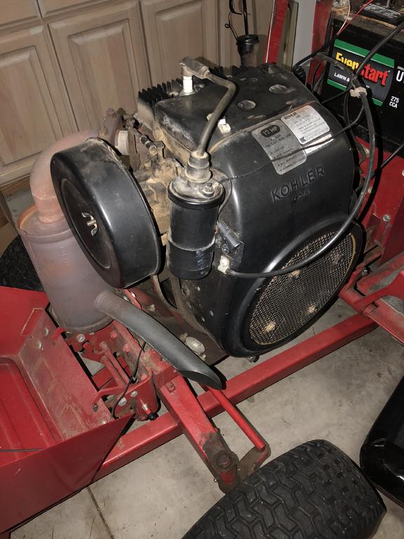

Howie 900 #22 Posted January 16, 2019 IN picture #8 one can see a points cover on the engine. Share this post Link to post Share on other sites

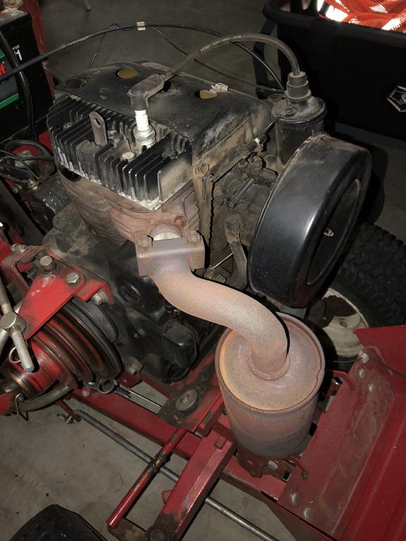

Jim anderson 77 #23 Posted January 16, 2019 WHX21- Now I just feel like I’m in bonus territory! The chance of getting extra info on my horse beyond the original intent. Ok, if my engine is a reboot from a different tractor I’m sure someone can give me the rundown. Here are additional pics, all 4 engine quadrants, and the serial plate. Waiting to see what info shows up! BTW: This horse is starting to get expensive! It is for my cabin and not my primary house. So far on my list of tools for the horse: welder, cutting wheel, air compressor, drill press, metal drill bits, vise grips, grease gun, and some small stuff. All for fluids change, snow plow blade repair, plus tire leak fixes etc.... I always love a reason for new tools!!!!! Jim Share this post Link to post Share on other sites
tunahead72 2,662 #24 Posted January 16, 2019 40 minutes ago, Howie said: IN picture #8 one can see a points cover on the engine. That's what mine looks like too. In fact, @Jim anderson's engine looks almost exactly like mine, only difference I see right now is the dipstick. Sorry, didn't mean to stomp on this thread. Share this post Link to post Share on other sites
WHX?? 58,052 #25 Posted January 16, 2019 (edited) No no Tuna, Jim has got the info on what he needs to properly get the oil changed on his horse. Aside from the guys who thought he might had a hydro instead of a gear jammer. Hopefully we got that cleared up! Jim your always in bonus territory and good company around here when you want to learn about ! You want to learn extra about yours you have certainly come to the right place! Your tractor is correct it's Tuna's we suspect that may be awry. Sorry for the confusion.... Pics Ed of that block! Oh and BTW Jim these tractors need not get expensive just for duties around the cabin. Your list of tools is not uncommon for folks here. You don't have to explain to us a reason for tools! Edited January 16, 2019 by WHX21 1 Share this post Link to post Share on other sites
