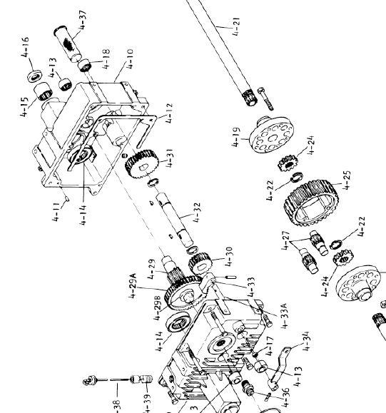

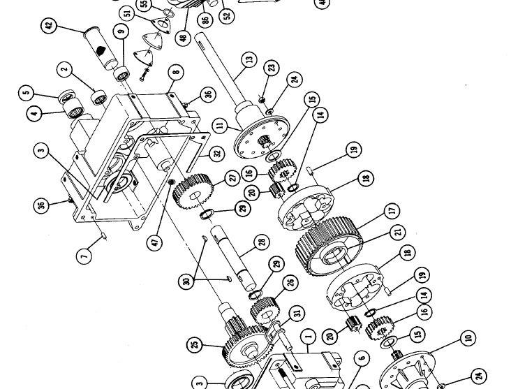

pfrederi 21,274 #1 Posted January 10, 2019 I was putting a Piston to Piston Sundstrand into a transaxle that had previously had a hydro gear. Should have been straight forward..open the case swap out the #5964 33 tooth gear (#27 picture 1) for a # 101885 44 tooth gear (#4-31 picture 2). Close the case and slide in the piston unit. Not so fast. Couldn't get the case half's to close up. After a lot of screwing around found that the bigger 44 tooth gear hit the Left Hand case side. I am not sure where the transaxle came from but it had worked OK with the hydro gear. After a lot more head scratching I noticed the casting number on the left side was I think 5967 (it was a bit worn down). All the left sides I have or could look up are 8047. The 5967 looks exactly like the 8047 and mates up perfectly with a 8046 RH IF you have the hydro gear input 33 tooth gear. All I can figure is the casting is thicker in that area than the 8047. Any one Know where the 5967 might have been on originally??? 1 Share this post Link to post Share on other sites
