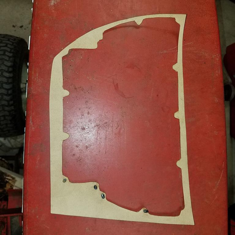

moe1965 774 #1 Posted January 9, 2019 I have been working on a restoration of a 1964 854. The other day my fuel tank decided it wanted to leak. Anyone know where I can find a replacement gasket. Share this post Link to post Share on other sites

moe1965 774 #5 Posted January 9, 2019 I started making a gasket out of some Fel-Pro gasket material that I had I'm going to put a product called high-tech on both sides of the gasket that is saposed to be gas resistant and I think just because I've gone this far I have some extra red kote product that I used on a tank repair sometime ago and I think I'll put that in the tank as well just for added insurance 3 Share this post Link to post Share on other sites
