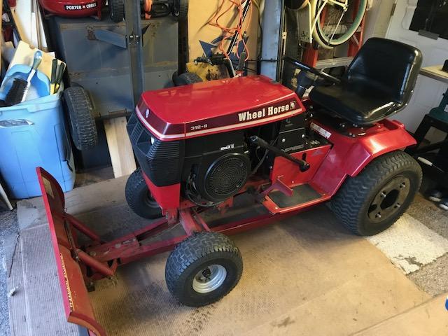

MAWHguy2019 23 #10 Posted January 12, 2019 Thank you everyone. This is quite the welcome! See attached for my 312-8. It is such a great machine. These were made in time when things were truly built to last. All the 310's have gone on CL but I will be looking for a nice parts tractor for a 312. What parts do you all consider to be the most important to have on hand for replacement? Hardest parts to find that need to be replaced? Thank you 2 1 Share this post Link to post Share on other sites
