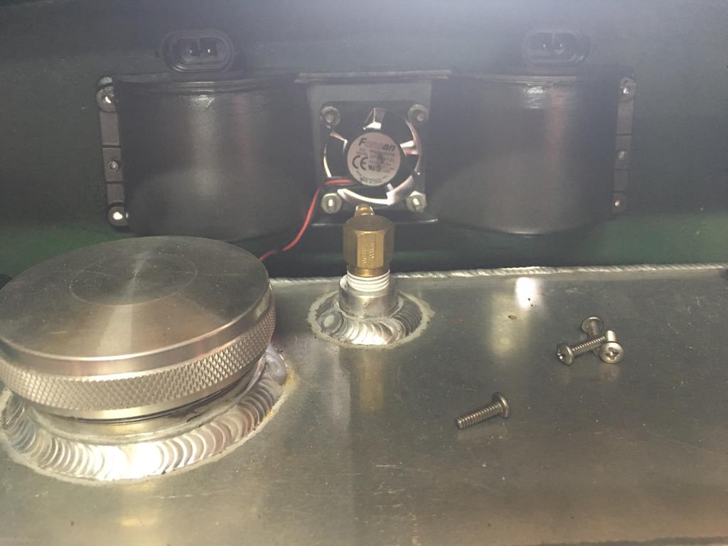

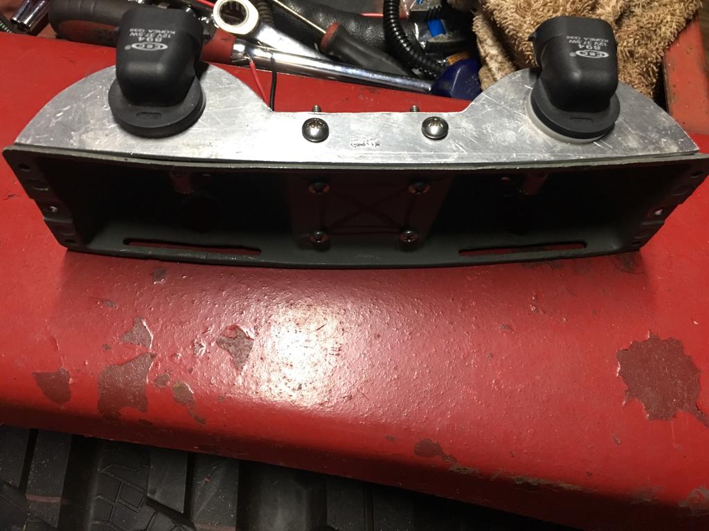

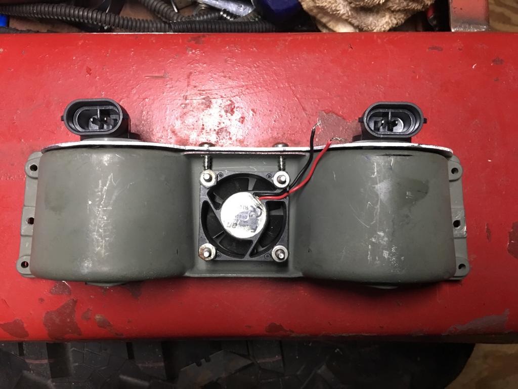

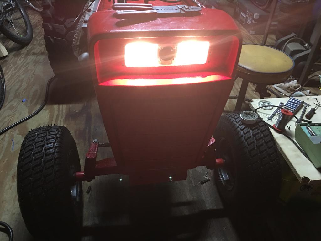

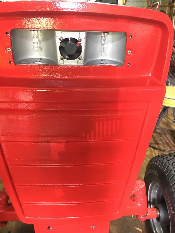

19richie66 17,863 #10 Posted December 31, 2018 7 hours ago, rjg854 said: @19richie66 Got to know more about what you've got going on there, please. These are 894 halogen bulbs I put in the gt14. To keep the lense from getting hot, i put a brushless computer fan in the space between the lamps. It actually works pretty good. Not as bright white as an led but I can get led replacements and they will just twist into the top plate. I had to cut off the lamp sockets to clear the fuel tank we made. 2 1 Share this post Link to post Share on other sites

Sarge 3,470 #12 Posted December 31, 2018 There used to be a replacement socket base available that had a nut and nylon washer to repair bad sockets in most lamp housings - be darned if I can find them now, maybe they don't make them anymore. There are generic ones with fingers that expand to hold the socket in place and those should work fine. Be aware, if you want to convert to led you'll run into an issue with light scatter unless the chips are rear firing toward the reflector. This is a common issue with conversion bulbs used on automotive applications - I've tried several myself and without a rear-firing lamp, it's a waste of money. Most of the conversion bulbs do a great job at lighting up trees, the ground, however - not so much. Great idea using the modern lamp bases for auto halogen bulbs - but at a common 110 watts per pair it is a pretty good draw on the electrical system. Sarge 1 Share this post Link to post Share on other sites
19richie66 17,863 #13 Posted December 31, 2018 Eventually I would like to install the LED cluster bulb with the 894 base. I just figured I would use what I had until then. The LED’s in the front of the fenders do good enough I don’t need headlight.👍 Share this post Link to post Share on other sites
