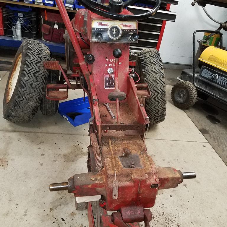

moe1965 774 #1 Posted December 25, 2018 I purchased this tractor about a month ago and put a few posts up that some of you might have read and responded to a few of my questions. Thank you all by the way. Here is where I am at now I was told that the engine was running about a year ago I doubt that because of the things I have found wrong with it such as the exhaust valve was stuck in the open position I have corrected that problem among a lots of other things lap the valves and today I fired it up for the first time it's at and purred like a kitten. I rewired the ignition switch and put in a solenoid which was a chore for me because I'm not that good with electrical. I'm trying to work out as many bugs as I can before spring such as I have to replace all of the seals in the rear end which is my next project come springtime it's going to get a total paint job pictures to follow. Here is another question what spark plug is correct for this engine it currently has a j19lm Champion spark plug in it. Thanks in advance Merry Christmas to all. 6 2 Share this post Link to post Share on other sites
ebinmaine 81,048 #2 Posted December 25, 2018 Nice looking ride and good work so far. Plug should be a J8C I believe. Replacing transmission seals will be easy enough. Just be sure to put a piece of electrical tape or something over the groove of the shafts when installing the new seals to prevent cutting them. Pulling the hubs can be quite a challenge. Not sure if you have attempted that yet. 1 Share this post Link to post Share on other sites

Pullstart 71,482 #5 Posted December 27, 2018 @moe1965 it’s your ride, do as you wish.... but if it were me I’d try to clean up that patina and let it be.. Share this post Link to post Share on other sites

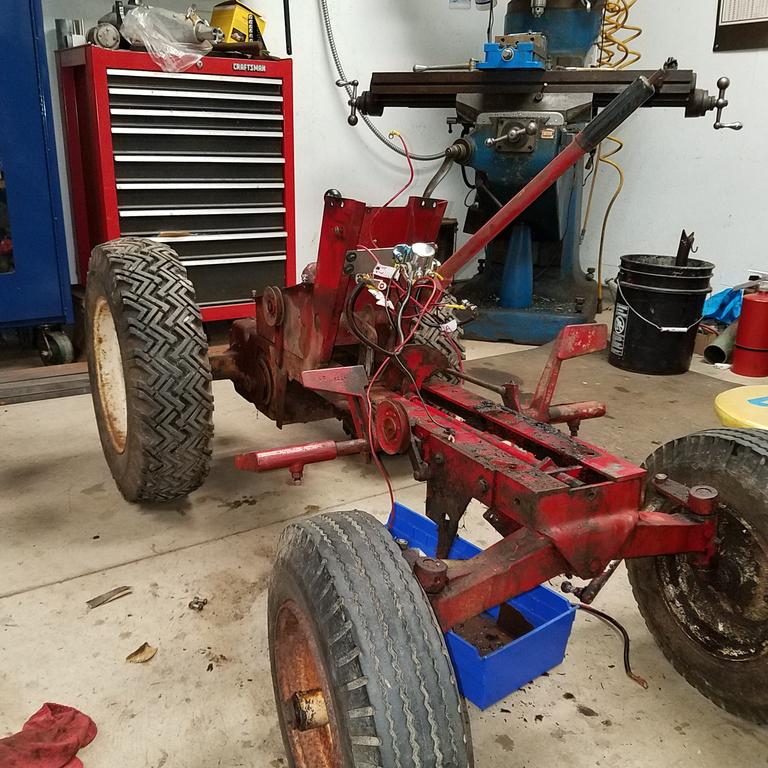

moe1965 774 #11 Posted December 31, 2018 All this because my oil pan gasket was leaking then I found the steering was sloppy might as well fix that and I have an O-ring in my fuel bowl shutoff that was hard to get at to replace so I just took the tank off to make things easier I think I'm crazy 1 3 Share this post Link to post Share on other sites
ebinmaine 81,048 #12 Posted January 1, 2019 A never ending process..... I need to remove this to get to that.... Might as well fix these too... While I'm here I'll just take those off too.... 1 Share this post Link to post Share on other sites
WHNJ701 4,173 #13 Posted January 1, 2019 4 hours ago, moe1965 said: All this because my oil pan gasket was leaking then I found the steering was sloppy might as well fix that and I have an O-ring in my fuel bowl shutoff that was hard to get at to replace so I just took the tank off to make things easier I think I'm crazy looks good so far definitely makes it easier to degrease and start rubbing that Johnson paste wax into that frame 1 Share this post Link to post Share on other sites

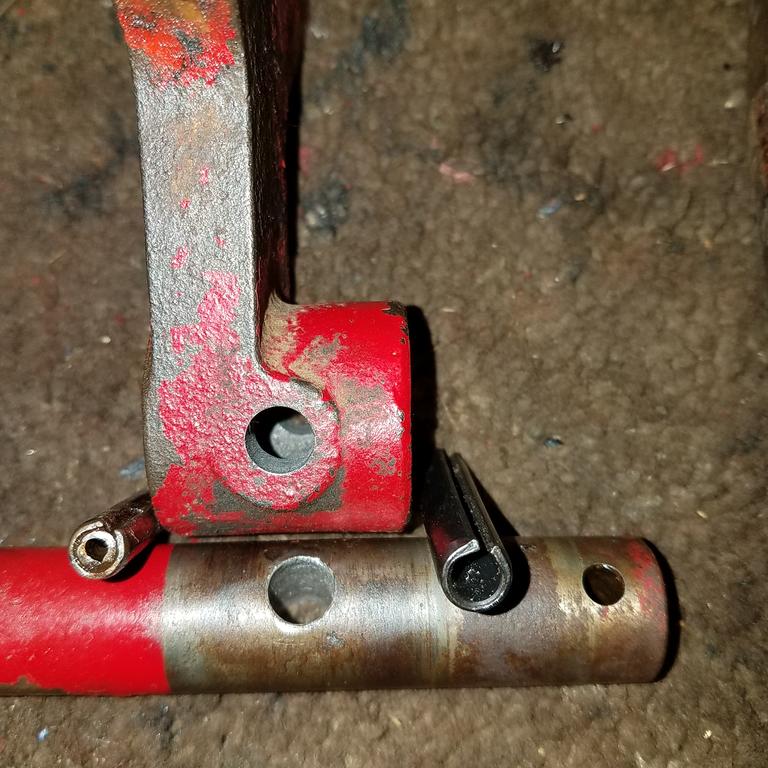

moe1965 774 #14 Posted January 1, 2019 Steering issue solved ended up being a little bit of slop in the roll pin it's amazing how little slop transfers to a lot of slop on the other end I just jumped up one size in a roll pin seems to be enough meat on the cast iron part I don't think I'll have any issues now 1 Share this post Link to post Share on other sites
