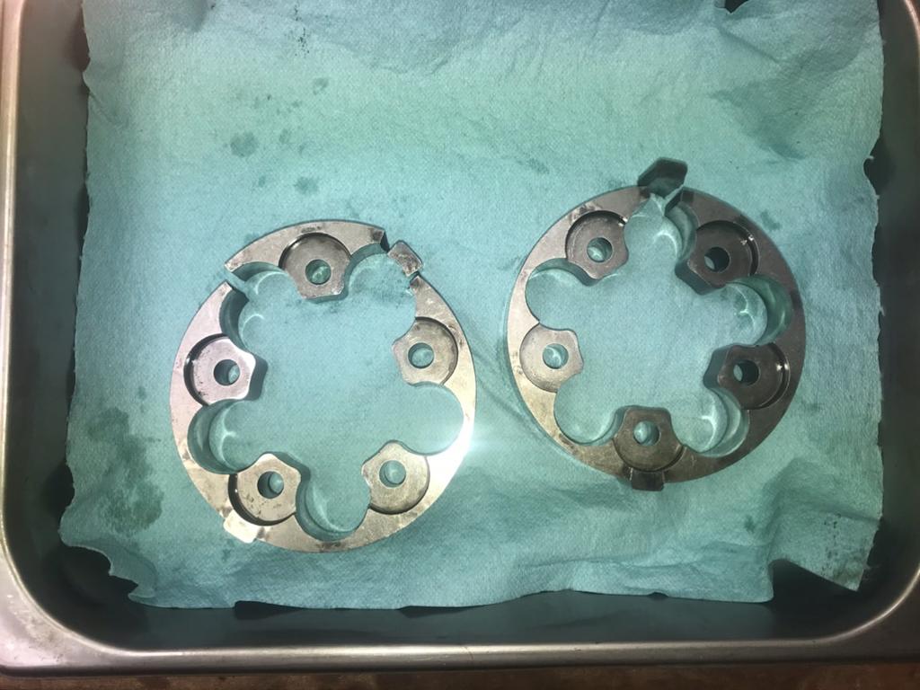

McGrew 461 #60 Posted December 30, 2018 Eric asked what goes wrong with the 10 pinion LS differentials. I have no idea what the common failures are, but this is what i found when I opened up the 5073 in my 71 Raider 10: I am certain it had never been opened up before, and mine had cast iron (steel?) end caps. This tractor got a lot of hard use by my Dad (plowing) and other than needing new bearings, seals and the pinion carriers, everything else looked good. FWIW, I drove the tractor for several hours before tearing into the trans, and never had a clue the diff was broke... Danny 2 1 Share this post Link to post Share on other sites

McGrew 461 #62 Posted December 30, 2018 953, Exactly! The fit between the bull gear and the pinion carriers is incredibly tight. When I purchased new ones I was surprised at how little clearance there was. Danny Share this post Link to post Share on other sites

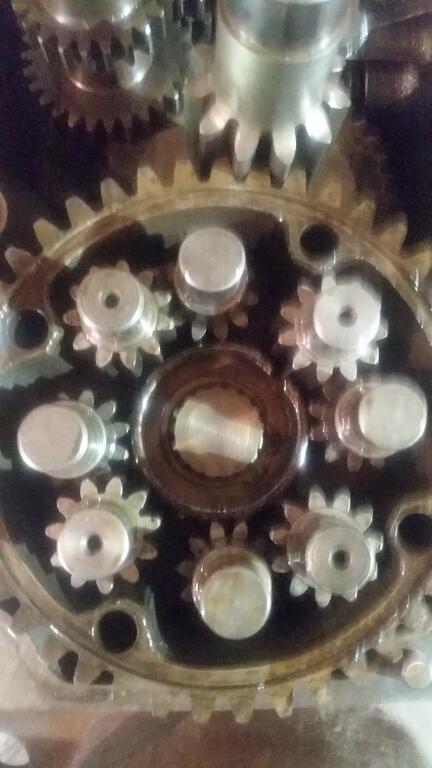

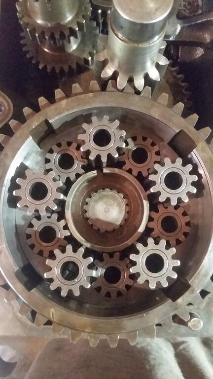

tntatro 184 #72 Posted July 7, 2020 Here are pictures of an 8 pinion and 10 pinion with a spring in them. If I loosely assemble the 8 pinion I can still turn the axles in opposite directions by hand, I can't do that with the 10 pinion even thought the spring is weak. 1 Share this post Link to post Share on other sites

oilwell1415 563 #75 Posted July 8, 2020 18 hours ago, tntatro said: Here are pictures of an 8 pinion and 10 pinion with a spring in them. If I loosely assemble the 8 pinion I can still turn the axles in opposite directions by hand, I can't do that with the 10 pinion even thought the spring is weak. Quoted just to have the pics..... I just read the entire thread. The reason this works in the 10 pinion unit and not the 8 is just like was said early in the thread. The gears in the 8 pinion unit run on shafts and the gears in the 10 pinion unit don't. The reason you get LSD action from the 10 pinion unit is not the friction of the spring against the gears, it is the friction between the gears and the housing. You don't have any of that in the 8 pinion unit. The only friction there is from the shafts and that's not much. In theory you could put a huge spring in there and generate enough friction to make it work, but a spring that large would probably cause it to wear out pretty quickly. 1 1 Share this post Link to post Share on other sites
