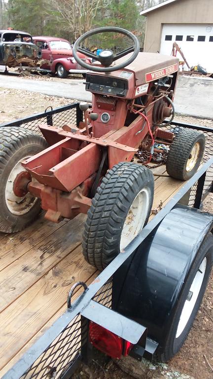

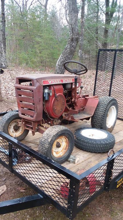

tom coffey 42 #1 Posted December 24, 2018 (edited) I'm an old grandpa of three boys and we like old garden tractors. I just bought our first WH. A C-160 8 speed, Kohler powered. I got it for just a little above current scrap metal value. It is missing a few pieces including the carb, deck, seat/pan & fenders, and RH running board. I know someone that has a carb and deck. Meanwhile I can borrow a carb off of another Kohler engine I have to try out this engine. I did get the mule gear with the tractor. I plan to restore it. Merry Christmas and Happy New Year to all. Edited December 24, 2018 by tom coffey 10 5 Share this post Link to post Share on other sites

953 nut 69,127 #9 Posted December 24, 2018 I too am from North Carolina, just a couple hours west of you. You did a nice introduction, but failed to tell us anything about your '40 Stovebolt Chevy in the first photo. One of the beautiful things about tractors is the interchangeability of parts. The running-board from any garden tractor model from 1968 to 2002 (300, 400 series) should bolt right up. The same is true of the steering and most of the PTO parts you mentioned. 1 Share this post Link to post Share on other sites

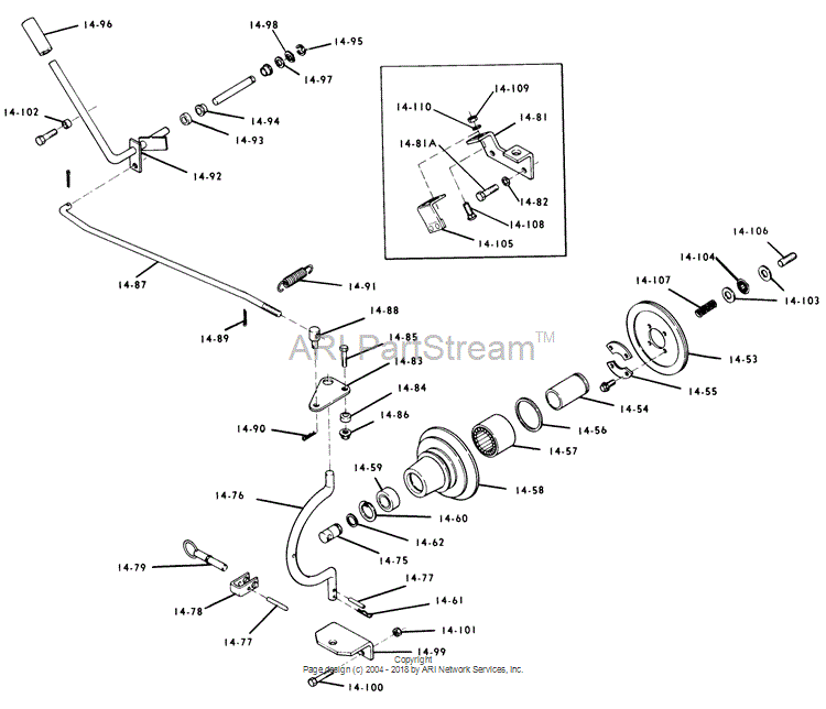

daveoman1966 3,884 #14 Posted December 24, 2018 (edited) Here is a schematic of the C-160 PTO assembly. Will be much easier for you to identify what parts you need from this pic, rather than "I need everything else". Just list the item # from this pic.... Edited December 24, 2018 by daveoman1966 Share this post Link to post Share on other sites
oliver2-44 11,732 #16 Posted December 24, 2018 I have a C-160 Auto and it is a capable hard worker. You will enjoy yours for work or show. They are good looking tractors. It looks like you have close to everything for the PTO assembly. it looks like the Horseshoe part 14-76 is quite worn out of round on the top end. It will work to get it running, but you may want to replace it or weld it up and grind it back round. 2 hours ago, 953 nut said: You did a nice introduction, but failed to tell us anything about your '40 Stovebolt Chevy in the first photo. There are some great detectives on this site, they don't miss anything, even if it's in the background. 1 Share this post Link to post Share on other sites
