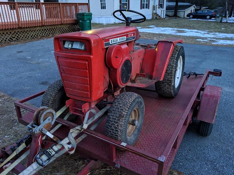

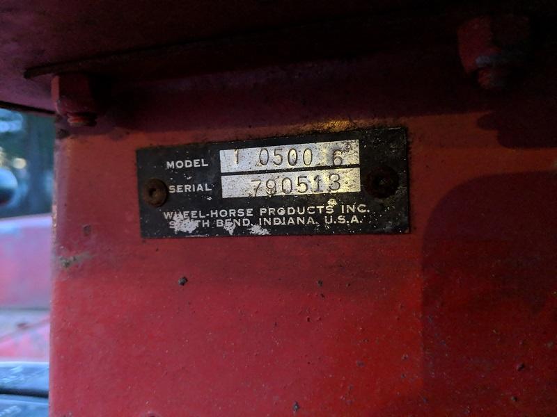

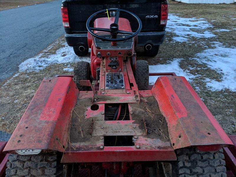

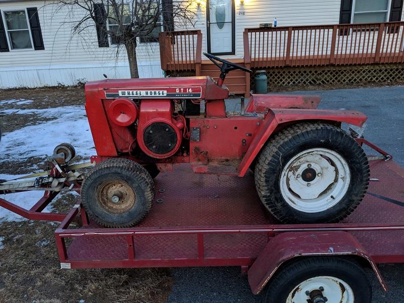

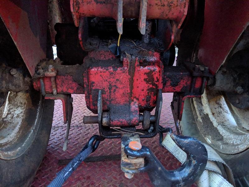

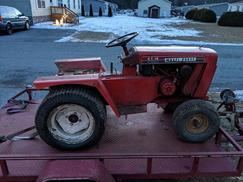

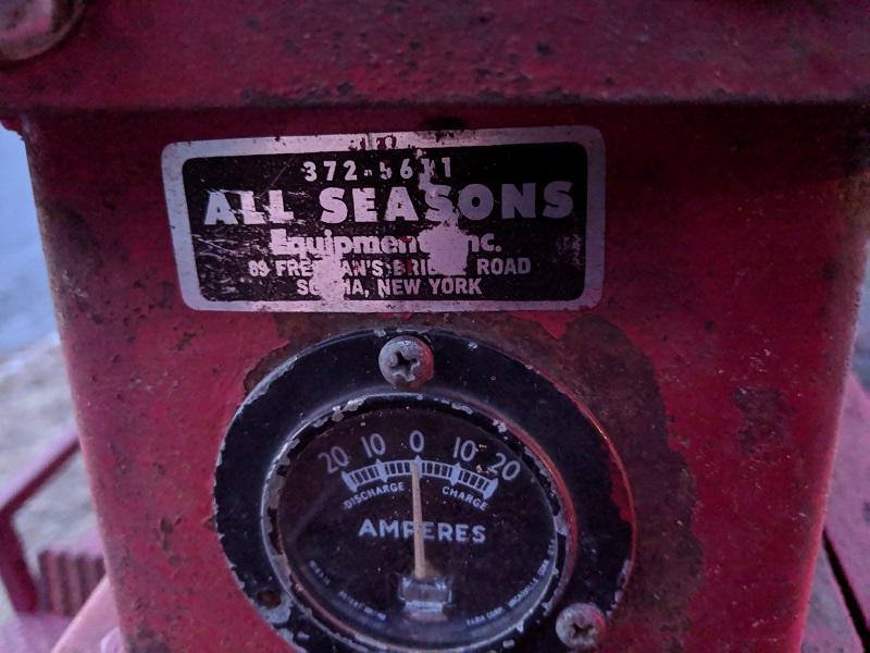

WildmanC120 613 #32 Posted December 19, 2018 OK...The moment we have all been waiting for!!!!! Here it is the GT14 I was hoping to get when I started this thread. Its in OK condition. Will need some work and some small things fixed. It runs and drives although I have not driven it yet myself. Turns out when I arrived if was a kid selling it (10-13 yo) in that range. He drove it right up on the trailer for me. Probably one of the coolest things about the tractor is it stayed local. Came from a small local shop named All Seasons Equipment in Scotia NY. I picked up the tractor literally only a few miles from that dealer. About the only thing concerning to me is the oil leak on the rear end. It does look like it is coming from the top/fill area so may not be an issue. 2 3 Share this post Link to post Share on other sites
953 nut 65,134 #33 Posted December 19, 2018 Very nice! It is a 1971 and after a good bath you can get a better idea of the fluid situation. Share this post Link to post Share on other sites

Herder 2,355 #35 Posted December 19, 2018 Very nice. With a little time and some MONEY you will have a really great tractor. I been searching for a while for the right GT. Still in search of. Share this post Link to post Share on other sites
19richie66 17,858 #36 Posted December 19, 2018 Good looking specimen there. I agree that a good bath will do wonders. I wonder if the transmission is overfilled. I had a transmission that when sat out in the sun, the fluid would come out from the dipstick cap. It was way overfilled. Strange but true👍 Share this post Link to post Share on other sites

Sarge 3,470 #41 Posted December 20, 2018 Clean off the area around the dipstick and pull it out. There is a breather vent that runs through the handle on that stick - if plugged, it can cause leaks and I've seen quite a few plugged. On models with those larger cylinders for the hydraulic lift, if there is any slight leakage in the cylinder, hoses or fittings that fluid can run back into the case and overfill it - causing the same problem. Sarge 1 Share this post Link to post Share on other sites

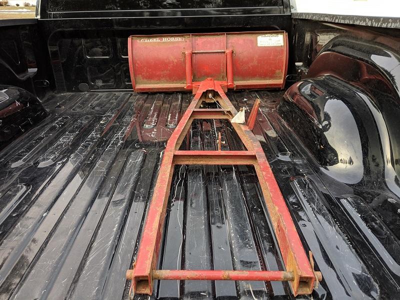

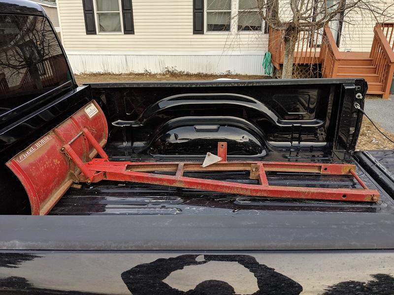

WildmanC120 613 #42 Posted December 20, 2018 Went outside earlier to take the GT14 off the trailer and bring it out back. Went to start it and battery was dead. I was expecting that since it was jumped yesterday. I open the hood to find this gem of a battery connection haha. It fired right up and the engine sounds pretty good. Shame it has a healthy haze of oil coming from the exhaust. Guess I will just have to rebuild it or replace with a 16hp. I would prefer the 16hp option. I didn't really get to test the hydro today. The lift works so that's a plus. It does drive under its own power but I couldn't run it much above idle since one you disconnect the jumper cables it spits and spudders due to the battery situation. It probably wont be until about April now till I get to work on it. Just too cold around here till then unfortunately. I forgot to mention before, but it came with this plow. I am unsure if its the right one for it though. 1 Share this post Link to post Share on other sites
19richie66 17,858 #43 Posted December 20, 2018 If the plow fits, it’s the right one 😂. Good that it will start and run on its own. I put a 16hp in mine also. Share this post Link to post Share on other sites
