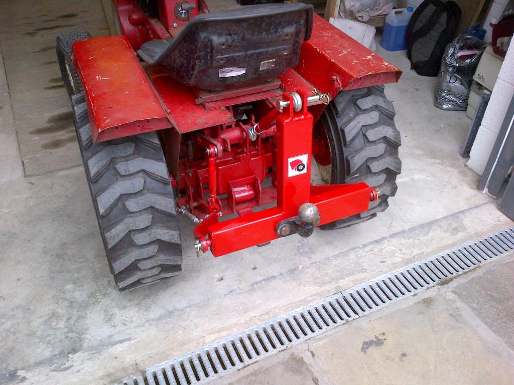

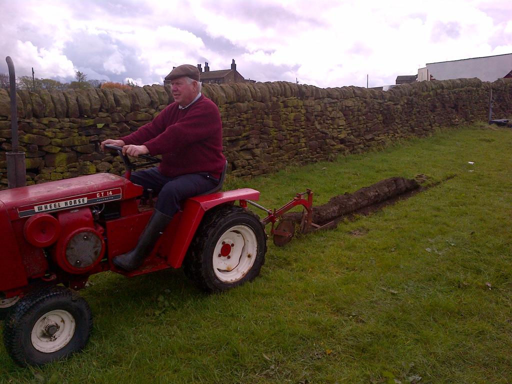

meadowfield 3,028 #20 Posted December 18, 2018 Love my GT14s great piece of kit and the rear three points have downforce too! One of mine has a modified D series three point, the other is a copy I made 4 3 1 Share this post Link to post Share on other sites

meadowfield 3,028 #23 Posted December 18, 2018 rear mount looks like this 1 1 Share this post Link to post Share on other sites
Aldon 4,832 #24 Posted December 18, 2018 3 hours ago, meadowfield said: rear mount looks like this That is the correct bracket for the dependent style that uses the draw bar over transmission tunnel. Basically it shares the cylinder that lifts the deck or blade implements. The independent set up is slightly different I believe. That allows a separate second cylinder that allows independent use. 2 1 Share this post Link to post Share on other sites

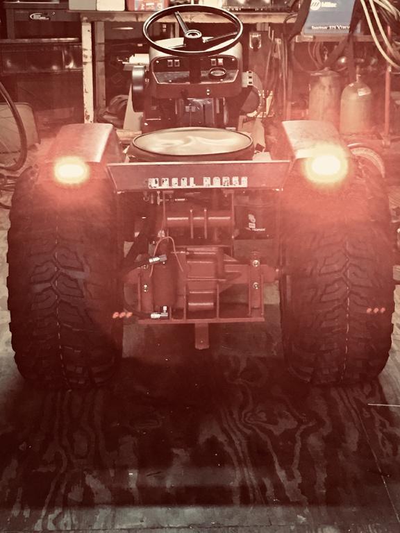

Rob R 989 #25 Posted December 18, 2018 5 hours ago, 953 nut said: Very light duty home made unit.The factory mount has a lot beefier setup and doesn't connect to the axle bracket. I own and built the bottom Rear axle attachment and I can assure you that is NOT light duty I have used this set-up for years lifting connecting an aerator (it weighs at least 100lbs with added 100lbs of lead weights) and a lifting platform on which I lifted hundreds of pounds of material with NO issues, the two inch receiver makes a multitude of attachment easy to hook on to, additionally I pulled heavy loads and remove medium size tree stumps hooking directly to the cross bar and lifting and pulling with the hydro and Tractor again NO issue(s). 3 Share this post Link to post Share on other sites
