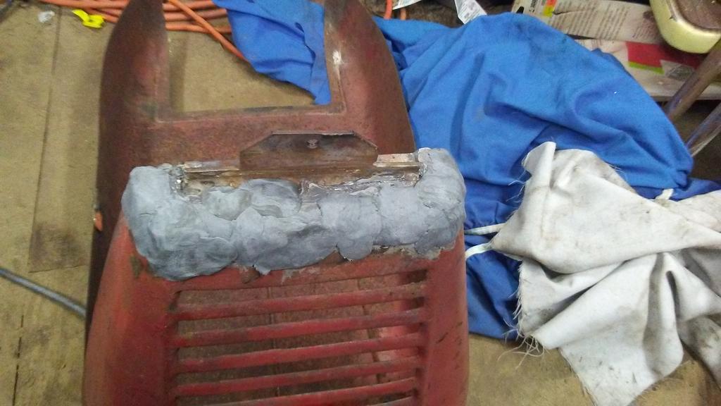

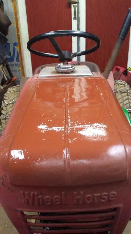

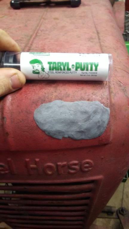

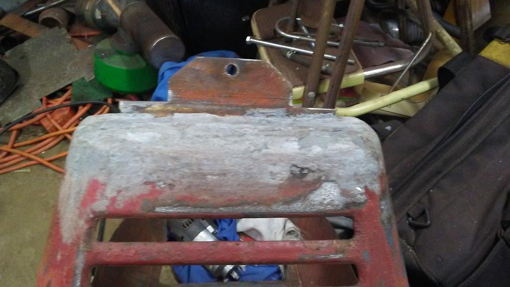

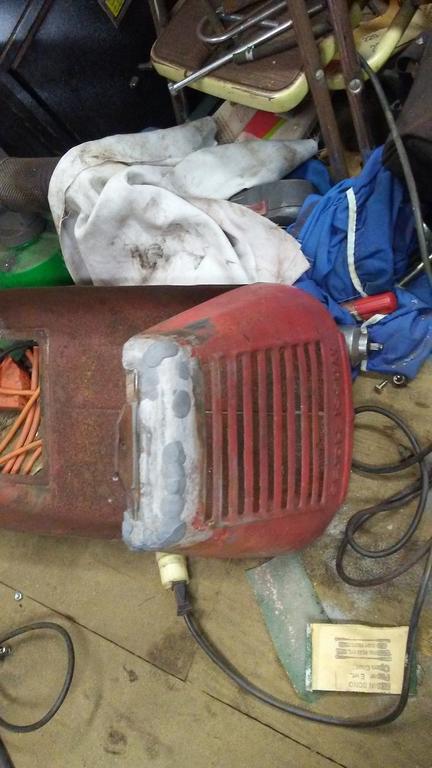

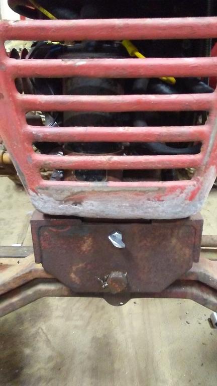

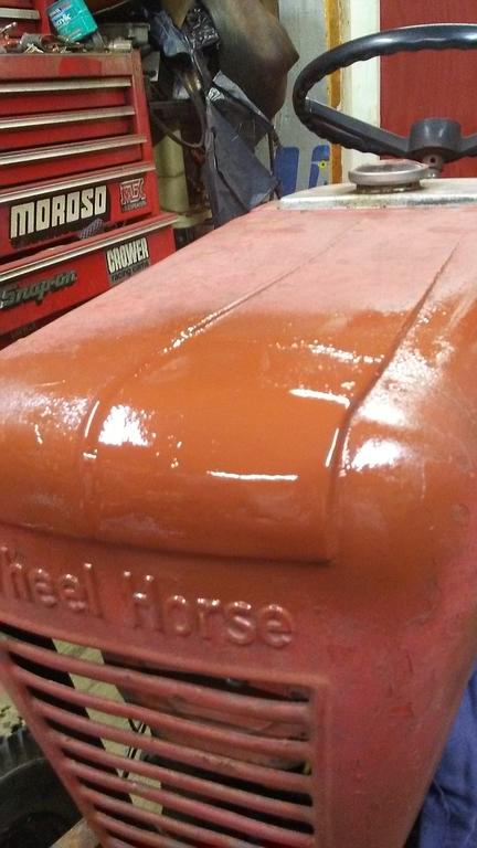

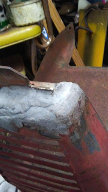

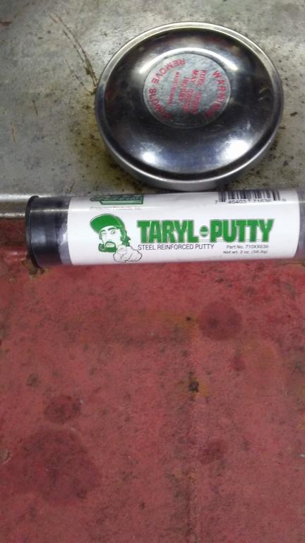

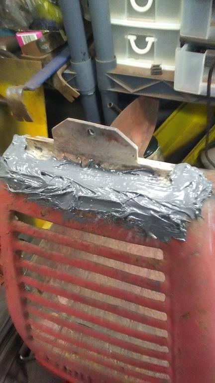

Elkskin's mower junkyard 1,117 #1 Posted December 14, 2018 Been working little on hood testing things on the 552. Bottom of hood I used mix of jb weld and Taryl putty. Top of hood is mainly jb weld. Front of hood had a dent and that's filled with taryl putty. I don't use bondo because of cracking risks plus it traps moisture. So what do you guys use for body filler. Sorry pics are out of order Maybe lol 4 Share this post Link to post Share on other sites
WHX?? 58,327 #2 Posted December 14, 2018 I use body filler for dings that won't dolly out but my real choice is fill it in with patch/welding and grind/sand as required. Especially on stress points like that hood to frame or where the orginal metal is totally gone. . Since we aren't flying these things at 33,000 ft or looking to win any trophies tho I say go with what works for you, your skills and budget. Anyone here is not going to tell you what you are doing is wrong...thank you for even trying to save! 4 1 Share this post Link to post Share on other sites
Elkskin's mower junkyard 1,117 #3 Posted December 14, 2018 3 minutes ago, WHX21 said: I use body filler for dings that won't dolly out but my real choice is fill it in with patch/welding and grind/sand as required. Especially on stress points like that hood to frame or where the orginal metal is totally gone. . Since we aren't flying these things at 33,000 ft or looking to win any trophies tho I say go with what works for you, your skills and budget. Anyone here is not going to tell you what you are doing is wrong...thank you for even trying to save! I cut out bottom of this hood because the good hoods bottom was shot. Welded it in with my Chicago electric 125 amp flux core welder but ummm I ain't a pro lol Share this post Link to post Share on other sites
Elkskin's mower junkyard 1,117 #4 Posted December 14, 2018 In fact I flunked welding class in school darn book work 3 Share this post Link to post Share on other sites

Mike'sHorseBarn 3,704 #10 Posted December 14, 2018 @craftsmanmowerfreak how do you like that taryl putty? I've been meaning to try some for a special little project. Share this post Link to post Share on other sites
Elkskin's mower junkyard 1,117 #11 Posted December 14, 2018 3 minutes ago, Mike'sHorseBarn said: @craftsmanmowerfreak how do you like that taryl putty? I've been meaning to try some for a special little project. Does good job. I even pieced a junk engine together from junky parts. And patched a hole in the block with the putty and it held no leaks. I have used it on other things too. I like it. 1 Share this post Link to post Share on other sites
Elkskin's mower junkyard 1,117 #12 Posted December 14, 2018 Ran that engine around put it under loads. Nothing broke patch held. Funny thing is I know how to do engine rebuilds but bc this was just a test I put a used piston with used rings in the 7hp Briggs block didn't even hone it. It didn't smoke 2 Share this post Link to post Share on other sites
