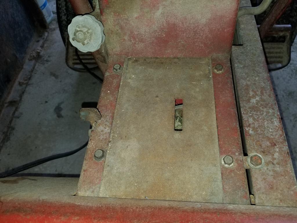

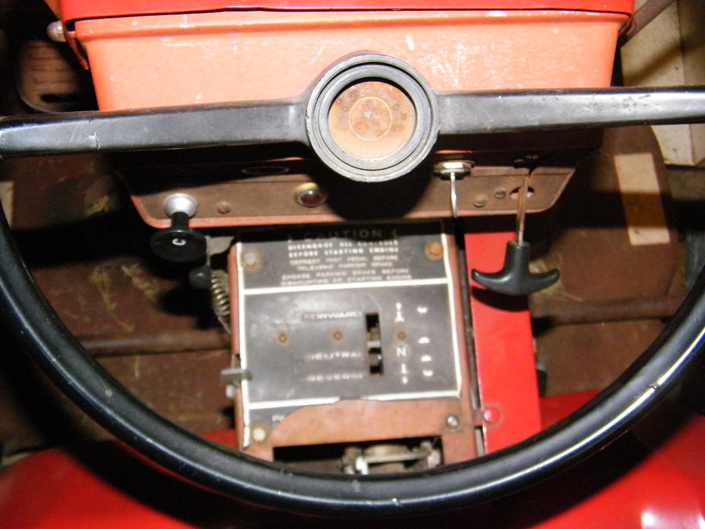

stevasaurus 23,841 #29 Posted December 14, 2018 I figured I should add a picture of the console. It is missing a part toward the seat. 2 1 1 Share this post Link to post Share on other sites

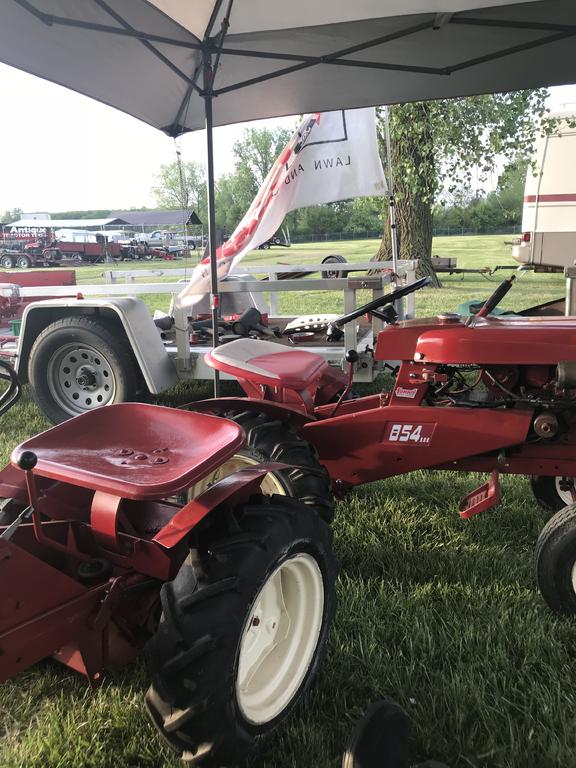

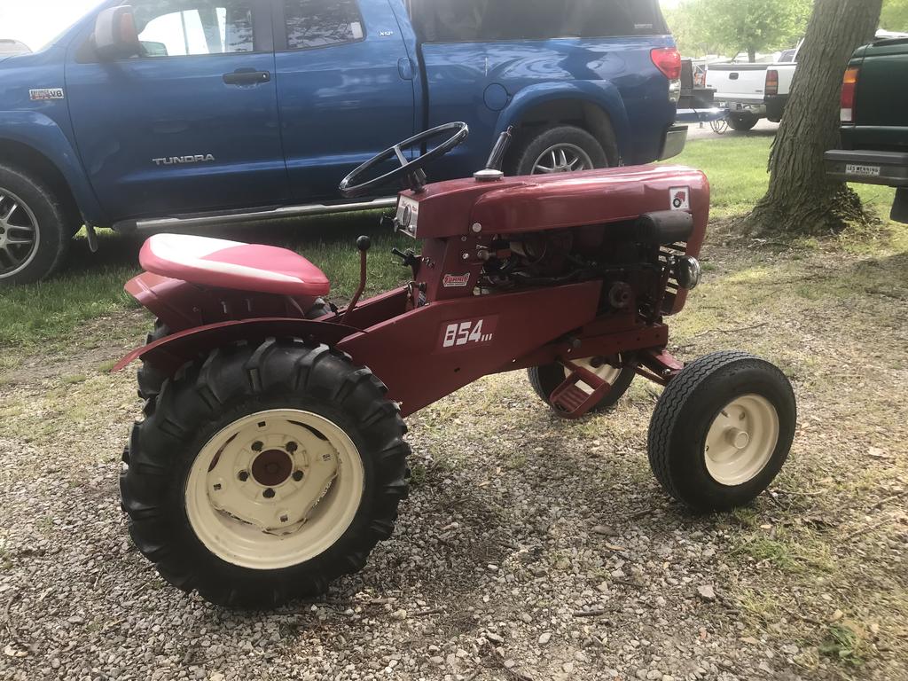

Lane Ranger 12,094 #30 Posted December 14, 2018 Some more 854 and 856 Wheel Horse photos! 3 Share this post Link to post Share on other sites

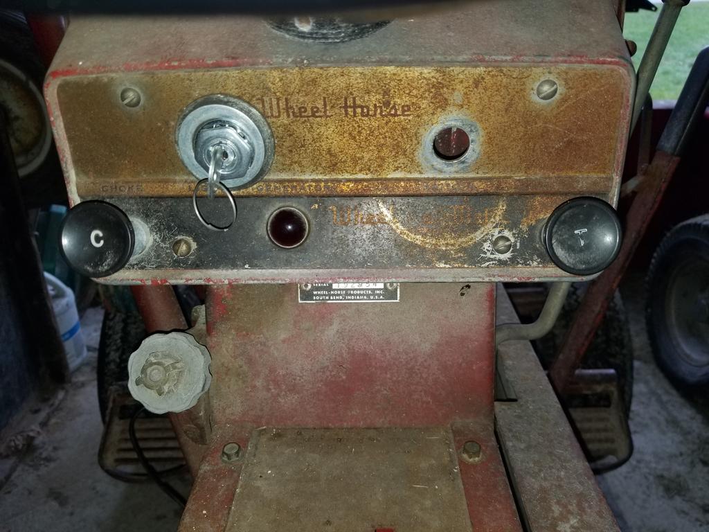

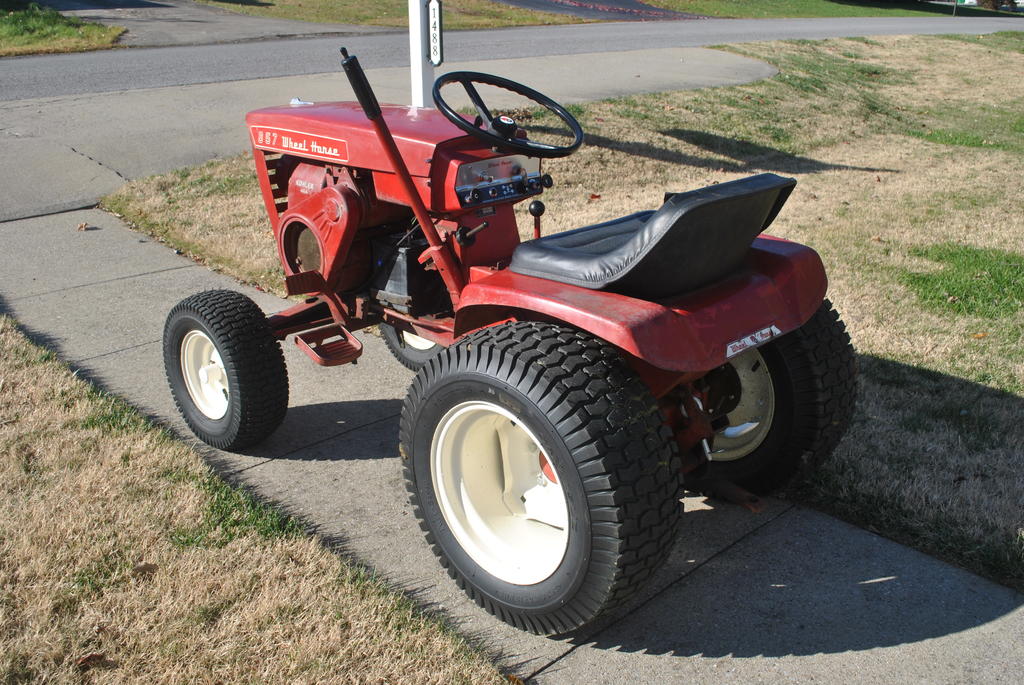

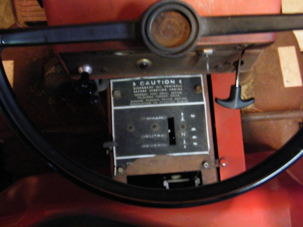

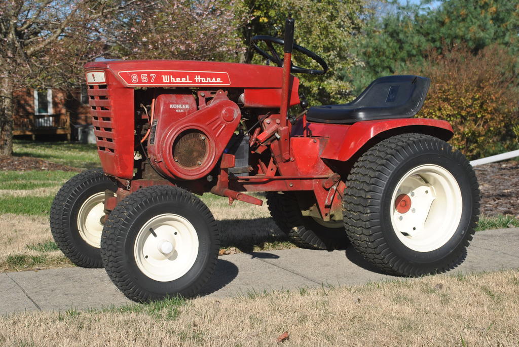

cafoose 3,836 #32 Posted December 15, 2018 On 12/13/2018 at 12:36 PM, stevasaurus said: The 1965, 1966, and 1967s are basically the same horse. Most like the K-181 Kohler 8 hsp engines, and some came with the Tecumseh 6 hsp engines. Here is my 857...8 hsp electric start 1967 This is my 876 8hsp automatic trans 1966 On 12/13/2018 at 1:23 PM, Vinylguy said: Steve Your 876 appears to have the extruded plastic console? What year did they change to the metal console plate with screen printed lettering? On 12/13/2018 at 1:40 PM, stevasaurus said: Terry, I do not know the answer to that question. Here is the dash plate and console on my 876 I bought at an auction in the early 90's. I believe it's original I'd love to restore the console plate but can't find any decals 2 Share this post Link to post Share on other sites
Sarge 3,473 #33 Posted December 17, 2018 Get with @Vinylguy (Terry) and he can hook you up on new vinyl covers for those two areas, as well as the correct and new woodgrain decals. The surfaces of those plates must be cleaned very well and made perfectly smooth or the pits and such will show through. WH originally did those parts in an inked silkscreen process that no one can really duplicate these days without a tremendous expense. There are a lot of examples that have Terry's vinyl on them during restoration work, the parts look new if they are done correctly. Sarge 2 Share this post Link to post Share on other sites
cafoose 3,836 #34 Posted December 17, 2018 34 minutes ago, Sarge said: Get with @Vinylguy (Terry) and he can hook you up on new vinyl covers for those two areas, as well as the correct and new woodgrain decals. The surfaces of those plates must be cleaned very well and made perfectly smooth or the pits and such will show through. WH originally did those parts in an inked silkscreen process that no one can really duplicate these days without a tremendous expense. There are a lot of examples that have Terry's vinyl on them during restoration work, the parts look new if they are done correctly. Sarge Just ordered the dash decal from @Vinylguy a couple days ago but can't find anything for the console I got the rest of the decals at the BIg Show Share this post Link to post Share on other sites

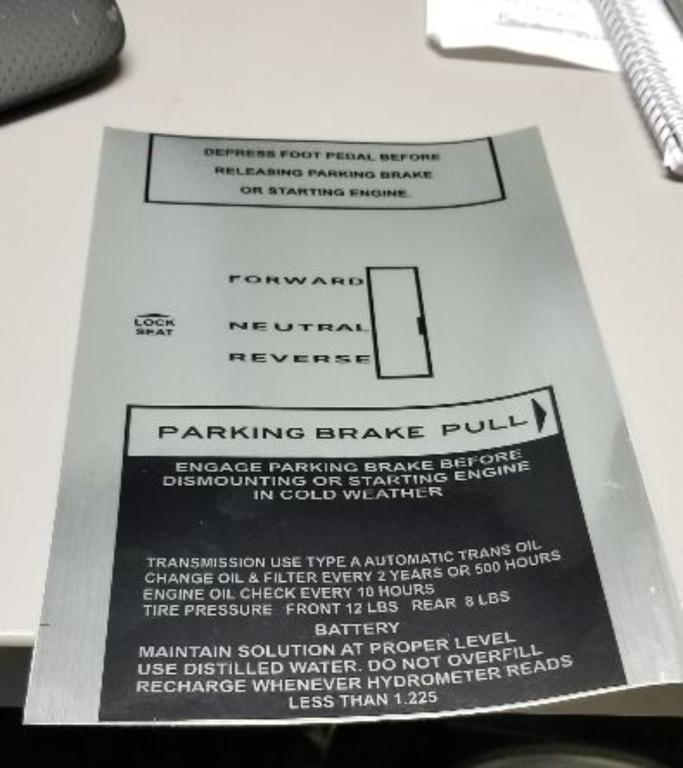

Vinylguy 4,796 #35 Posted December 17, 2018 33 minutes ago, cafoose said: Just ordered the dash decal from @Vinylguy a couple days ago but can't find anything for the console I got the rest of the decals at the BIg Show Charles Now that I know who you are I have added your account to the support group. Next time you log in to your redoyourhorse.com account all prices you see are 15% lower than normal retail on 95% of the items listed. I do make the brushed chrome decals for your console and have one with a few very small flaws that I will be sending you with you previous purchase so do not order one at this time. Let me know if it works for your restore and please post pictures and comment on any install issues you may have found. Customer feedback is important in helping improve my products. Thank you for your support of the world's greatest Wheel Horse forum. https://www.redoyourhorse.com/875-1075-876-1076-and-1276-model-console-decal/ 1 1 1 Share this post Link to post Share on other sites
cafoose 3,836 #36 Posted December 17, 2018 13 minutes ago, Vinylguy said: Charles Now that I know who you are I have added your account to the support group. Next time you log in to your redoyourhorse.com account all prices you see are 15% lower than normal retail on 95% of the items listed. I do make the brushed chrome decals for your console and have one with a few very small flaws that I will be sending you with you previous purchase so do not order one at this time. Let me know if it works for your restore and please post pictures and comment on any install issues you may have found. Customer feedback is important in helping improve my products. Thank you for your support of the world's greatest Wheel Horse forum. https://www.redoyourhorse.com/875-1075-876-1076-and-1276-model-console-decal/ Thank you very much Terry I really appreciate it! I will be sure to post pictures and any comments I may have I really appreciate all that you do for 1 1 Share this post Link to post Share on other sites

Jay Wellwood 29 #38 Posted December 25, 2018 Would one of you fine gents with an 856 post a pic of the dash/controls are? My dash has long since lost the decals on it and looking at the OM, I'm not certain I know which knob/cable assembly is which (choke vs throttle) as I have one of each, which are no longer labeled. Share this post Link to post Share on other sites
ebinmaine 80,600 #39 Posted December 25, 2018 As sitting in the driver's seat the choke should be on the left 2 Share this post Link to post Share on other sites
Ed Kennell 47,254 #40 Posted December 25, 2018 All my tractors are choke = left and throttle = right. 2 Share this post Link to post Share on other sites
