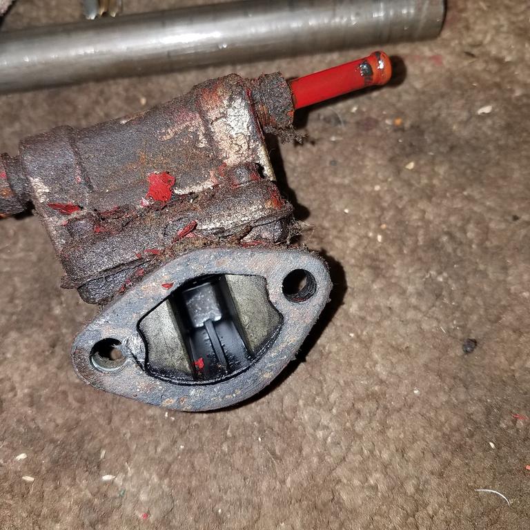

moe1965 774 #1 Posted December 9, 2018 I just took off the fuel pump and to me it looks like something's missing is there supposed to be a arm that sticks off the back of the pump and goes in the engine to actuate the pump Share this post Link to post Share on other sites
953 nut 70,304 #2 Posted December 9, 2018 Nothing missing. The smaller engines used a "Pulse Pump" which moves the diaphragm by using the pressure change created in the crank case as the piston moves up and down. Share this post Link to post Share on other sites
The Tuul Crib 7,354 #3 Posted December 9, 2018 (edited) There is an arm supposed to be on there that runs off the camshaft or not I always thought there was Edited December 9, 2018 by The Tool Crib 1 Share this post Link to post Share on other sites

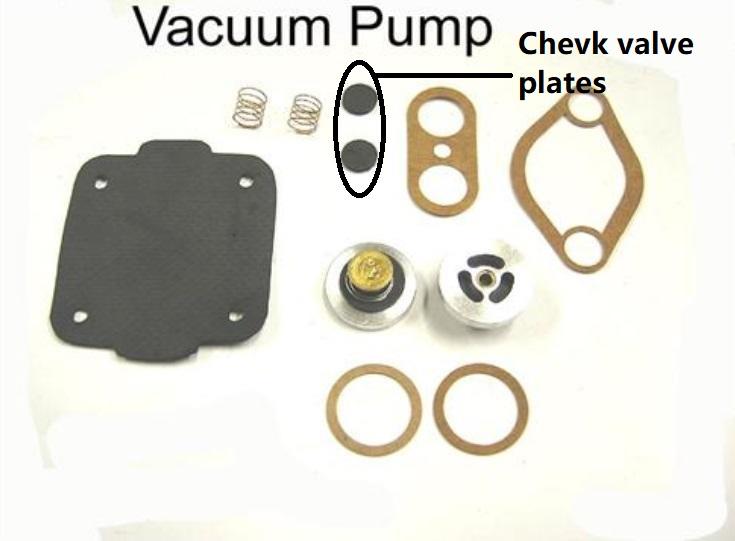

953 nut 70,304 #4 Posted December 9, 2018 These are the parts you will find in your pump. Share this post Link to post Share on other sites
KC9KAS 4,746 #5 Posted December 9, 2018 41 minutes ago, The Tool Crib said: There is an arm supposed to be on there that runs off the camshaft or not I always thought there was 42 minutes ago, 953 nut said: Nothing missing. The smaller engines used a "Pulse Pump" which moves the diaphragm by using the pressure change created in the crank case as the piston moves up and down. Vacuum/pressure operated pump. 1 Share this post Link to post Share on other sites

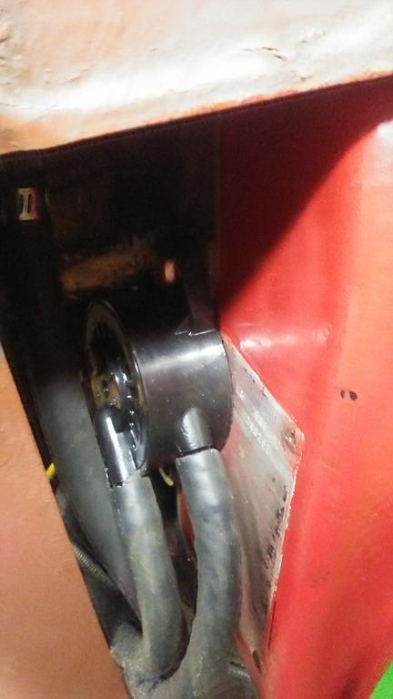

Elkskin's mower junkyard 1,117 #6 Posted December 9, 2018 I just go visit Taryls shop he makes me a plate that's tapped and has a nipple in it and I run a Briggs pulse pump. Its his way of fixing it and all 4 of the round hoods are like this 1 Share this post Link to post Share on other sites
Elkskin's mower junkyard 1,117 #7 Posted December 9, 2018 Don't know if you can see it. U need pump above the nipple or oil will get into pump. Share this post Link to post Share on other sites
moe1965 774 #8 Posted December 10, 2018 43 minutes ago, craftsmanmowerfreak said: Don't know if you can see it. U need pump above the nipple or oil will get into pump. Thanks I have heard of using this as a option to replace the fuel pump but have never tried it Share this post Link to post Share on other sites
Elkskin's mower junkyard 1,117 #9 Posted December 10, 2018 5 minutes ago, moe1965 said: Thanks I have heard of using this as a option to replace the fuel pump but have never tried it Works really good. On my k160 on the 753 it went from having to use spray to get it to start to one or 2 pulls with choke on. I have a 1958 bolens engine on the 753. The one in pic is the 8hp I put on the 552 Share this post Link to post Share on other sites

953 nut 70,304 #11 Posted December 10, 2018 If you only replace the diaphragm you can get a little extra life out of the check valves by removing the check valve plates and inverting them presuming this is the type valves you have. This is going to make them seat a bit better. Share this post Link to post Share on other sites
