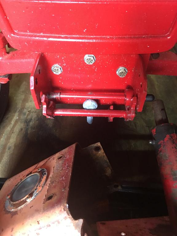

"D"- Man 827 #5 Posted December 7, 2018 I purchased a used 1054 with a Wheel Horse attachment bracket thingy on the front but not sure if this is what you are referring to. Excuse the poor picture due to lighting conditions and it is sort of tucked away in my garage. 2 Share this post Link to post Share on other sites
TravelinJavelin 621 #6 Posted December 7, 2018 yup that is it huh looks like its bolted on from underneath? thanks for the pic on this .......if its not alot of trouble i'd be currious how that is mounted and wondering if that came off from D series tractor? Share this post Link to post Share on other sites

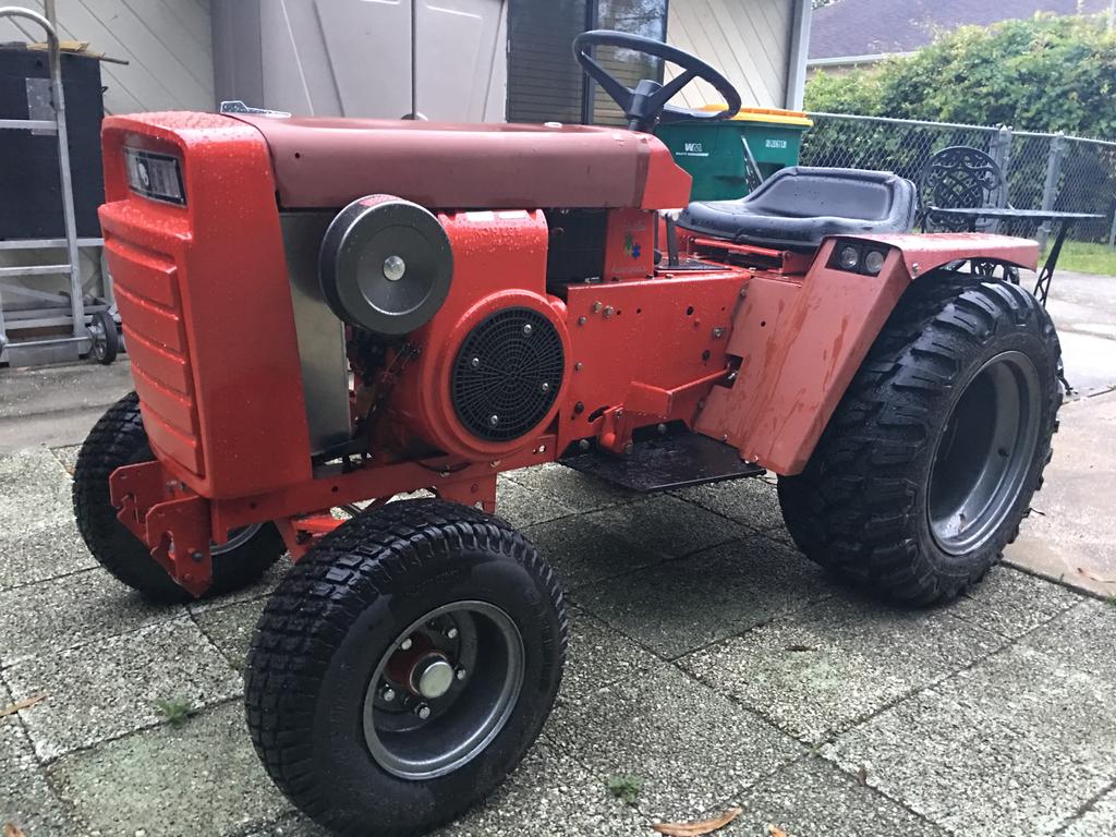

19richie66 17,932 #7 Posted December 7, 2018 (edited) Here is mine. 3 bolts through the front plate. My 953 and the 1054 will get them too. You can weld chain links to a piece of 5/8” rod and use it as a front tie down point also. Edited December 7, 2018 by 19richie66 3 4 Share this post Link to post Share on other sites
oliver2-44 11,694 #8 Posted December 7, 2018 2 hours ago, 19richie66 said: You can weld chain links to a piece of 5/8” rod and use it as a front tie down point also. @19richie66 Thats a great idea, thanks for sharing it. The fronts are always hard to tie down without the straps or chain scuffing some paint up. 1 Share this post Link to post Share on other sites

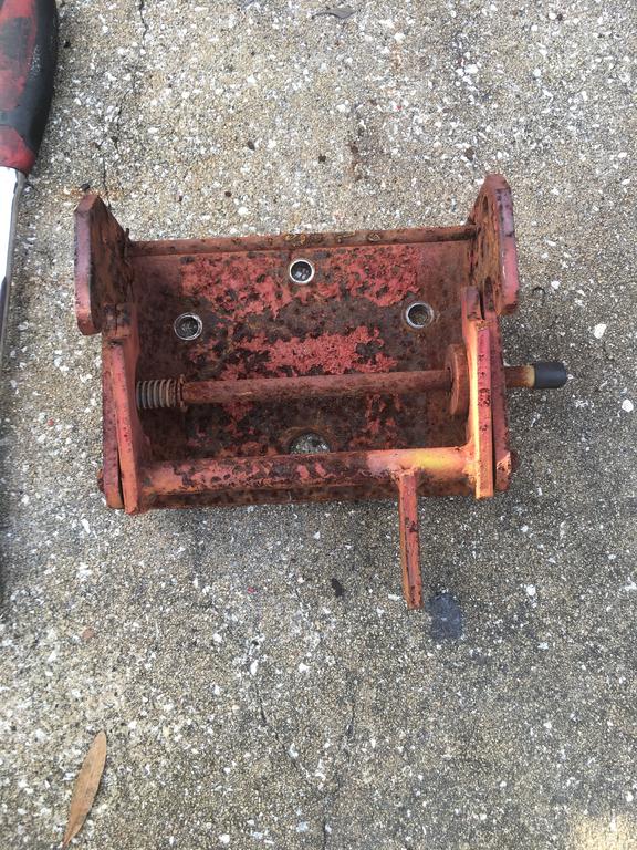

19richie66 17,932 #12 Posted December 8, 2018 (edited) Someone had put this on mine before I got it. There were three holes in the plate and bracket. I can’t say whether it was like that or if someone drilled it. I just removed it, welded the plate back on right and reinstalled it. I’ll try to get a better picture tomorrow. Edited December 8, 2018 by 19richie66 Share this post Link to post Share on other sites

19richie66 17,932 #19 Posted December 8, 2018 (edited) This is what is on mine. The bottom one is off of a 418-A. I use the axle pivot pin hole for a tie down point. Edited December 8, 2018 by 19richie66 3 Share this post Link to post Share on other sites

19richie66 17,932 #21 Posted December 8, 2018 (edited) I just took this off a frame I stripped out. I would have given it to you. Dang🙈 Edited December 8, 2018 by 19richie66 1 Share this post Link to post Share on other sites
