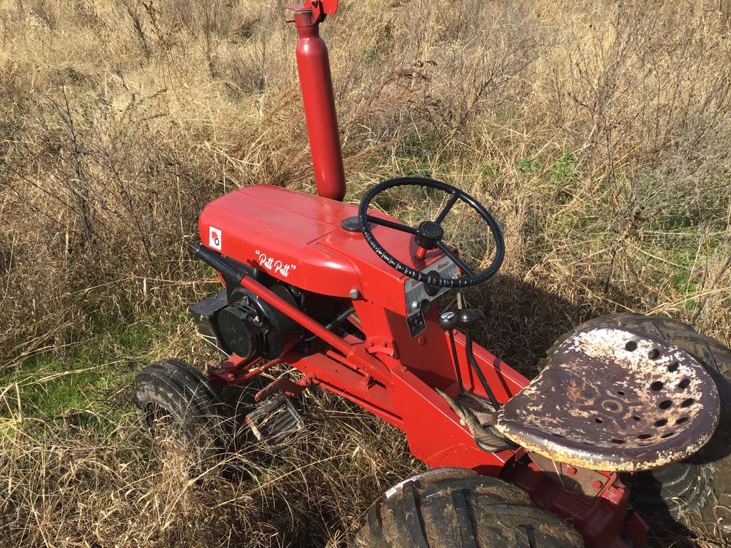

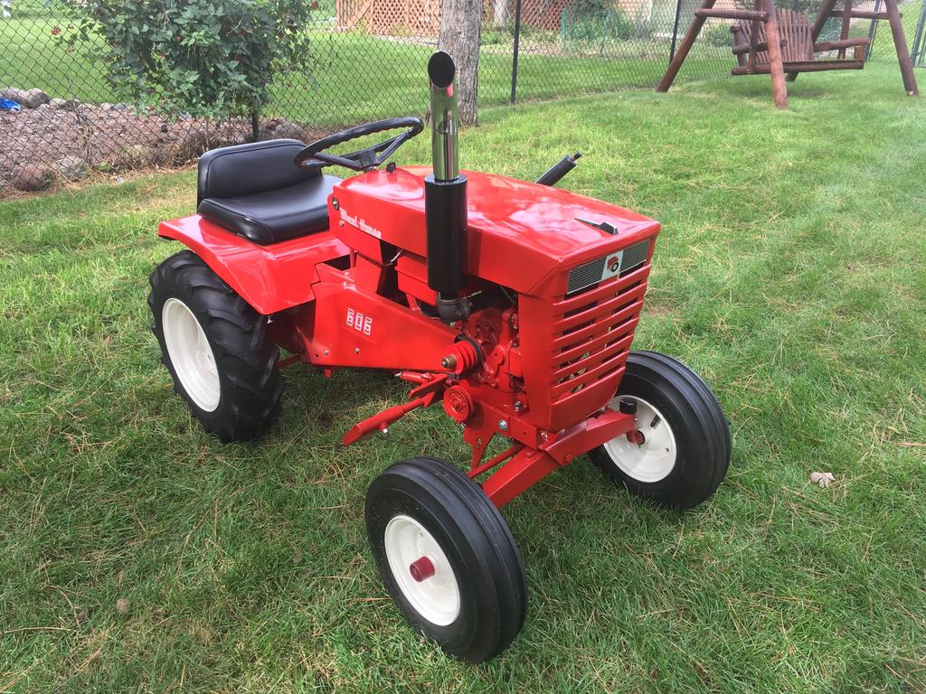

International Harvester Red looks good on my tractors!6022EAA4-041A-4980-9E36-7E08E0B3B1D9.jpeg
  • Like 8

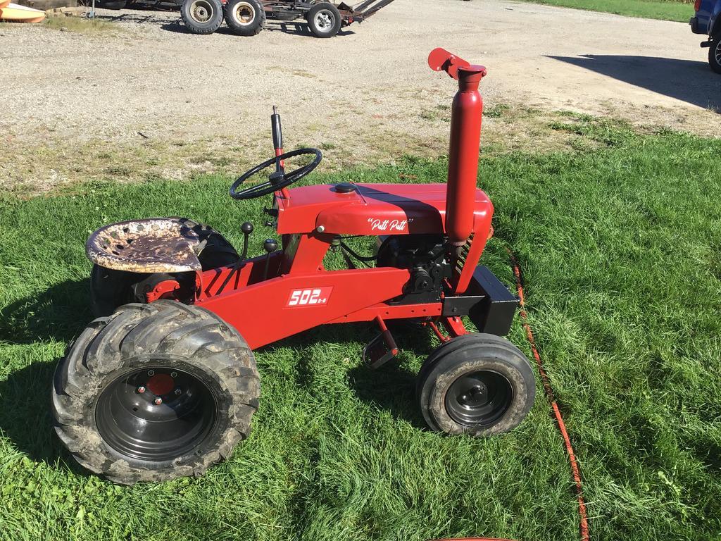

  The three common standard paint colors a fair amount of members use on here are IH Red, Rustoleum Regal Red and Rustoleum Sunrise Red.  As far as which is closest to original depends on which piece of buffed out old pain you compare it to.   I used Rustoleum Regal Red, (with hardener) on my 312-8  it is a tiny shade darker than Sunrise Red. It's been 3 years since I restored it, for my son to use as his weekly mowing tractor, and the paint has held up excellent .

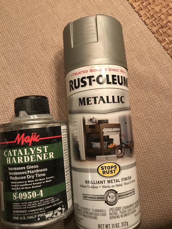

If you buy have a spray gun, consider adding some hardener. rustoleum doesnt make a hardener, so I use the hardener Majic Catalist Hardenenr sold at Tractor Supply. (I don't use the Majic paint, as in my opinion it seems to fade quicker)

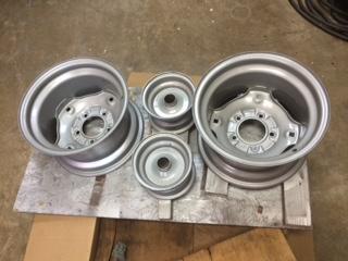

For the silver rims I used  Rustoleum spray can Metallic Matte Silver.
Good luck on your project. While we all have opinions on color, the most important thing is to make it your own!

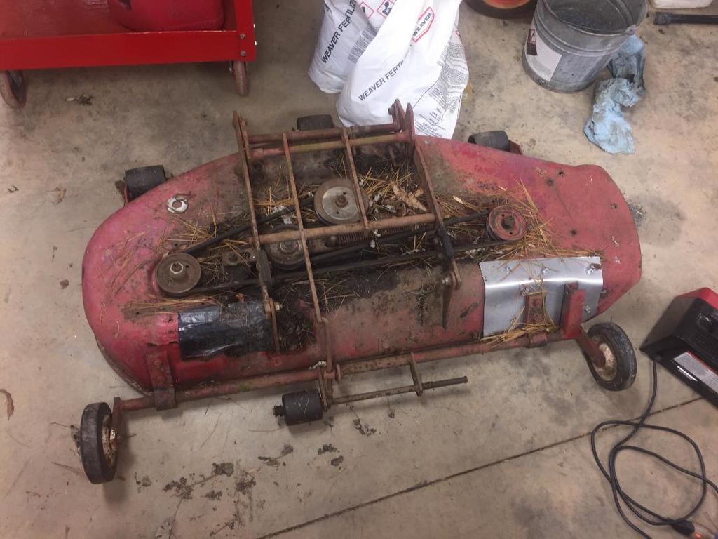

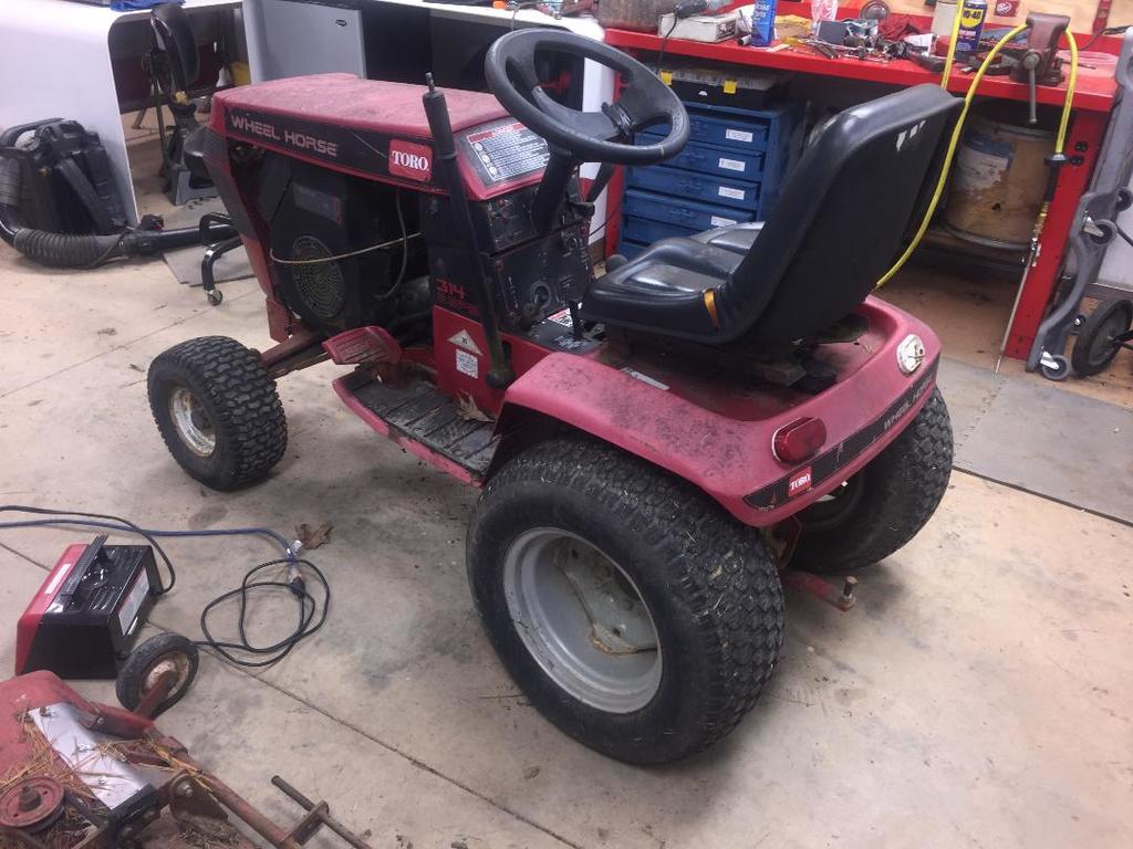

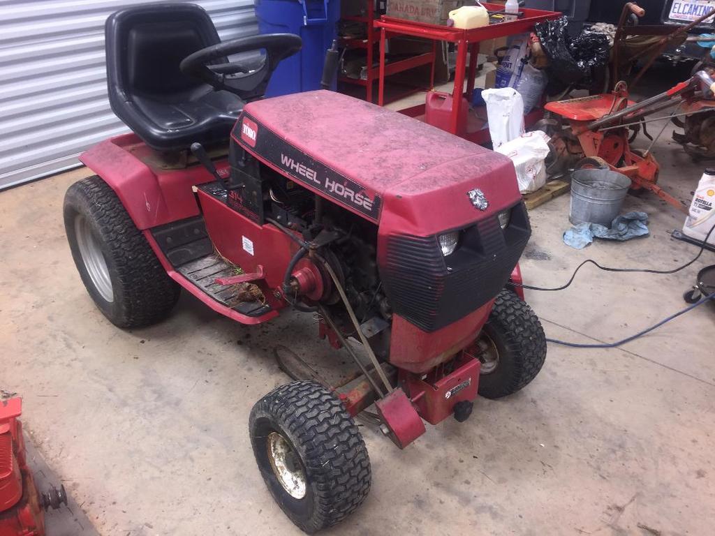

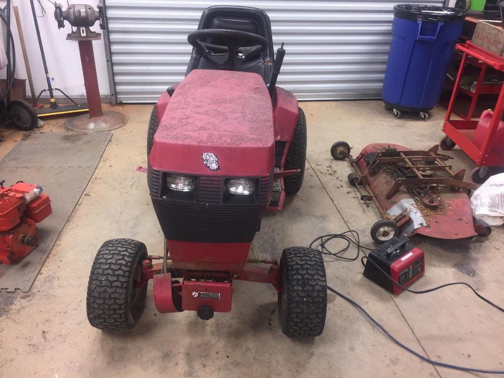

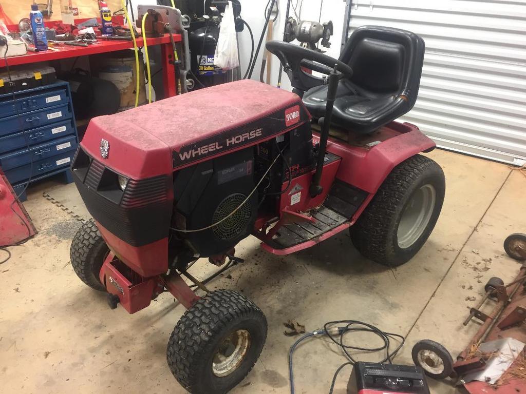

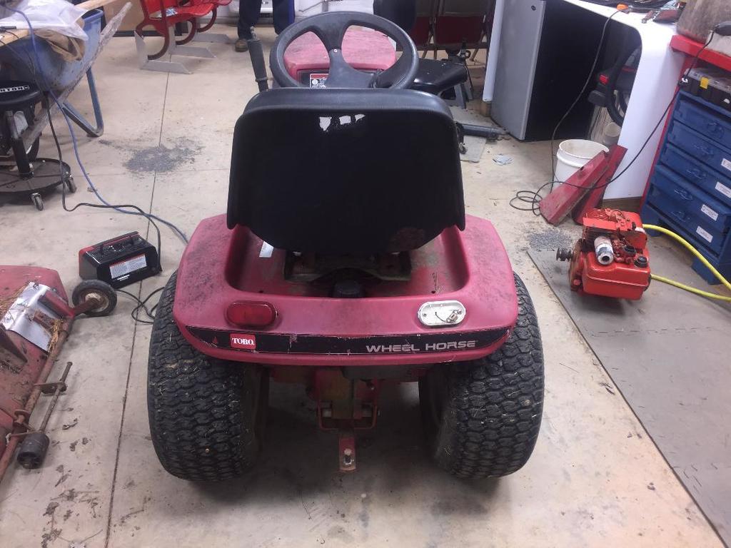

OK, here are the much requested pictures!  Just got it yesterday for $250 bucks.  Did I get burned?  Runs and pulls like a dream!  I might be in need of a deck and some original front hubs.  lol.
