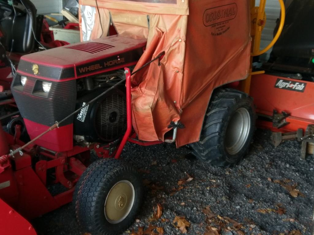

WVHillbilly520H 10,378 #27 Posted December 6, 2018 (edited) On 12/4/2018 at 5:04 PM, wallfish said: Once you get the cab on you'll see why a motorized rotation is better. My hand kept hitting the cab door even though mine has the big bump outs in the doors for the extra room. It's nice to have the glass windshield with widow wiper too! Also hooked up a small 12v heater to blow on the window as a defogger. It doesn't really add any heat to the cab but it does work for defogging the window. https://www.harborfreight.com/12v-auto-heater-defroster-with-light-60525.html Rain X stuff works good as well. I fabbed up an extension for both getting the chute rotator handle closer inside the cab and to push it closer to the the console away from the door (see pics)... I too bought one of those HF defrosters just never mounted it up in the 520 and cab but have it on stand by in the old C30 I got back in the summer. Edited December 6, 2018 by WVHillbilly520H Share this post Link to post Share on other sites

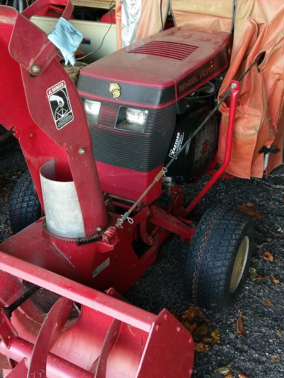

formariz 12,379 #28 Posted December 6, 2018 I see also that you have a short extension on the inside of chute. Does it help throw it further? Mine has a sort of wire attached there. I see also the roller chain on front wheels. Something else on my list. I have them on the Electro with plow. Share this post Link to post Share on other sites
WVHillbilly520H 10,378 #29 Posted December 6, 2018 10 hours ago, formariz said: I see also that you have a short extension on the inside of chute. Does it help throw it further? Mine has a sort of wire attached there. I see also the roller chain on front wheels. Something else on my list. I have them on the Electro with plow. Yes that "deflector" actually does help throw the snow farther (increases the velocity like reducing water or air line size) which Toro still has available #19 https://www.partstree.com/parts/toro/snow-blowers-snow-throwers/79362-toro-42-snowthrower-for-300-series-garden-tractors-sn-270000001-270999999-2007/chute-and-rotation-assembly/ , and no roller chain on the front tires that's just the manufacturing stripes on the new tires that's about to be changed out for matching front AGs shortly. Share this post Link to post Share on other sites

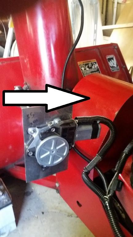

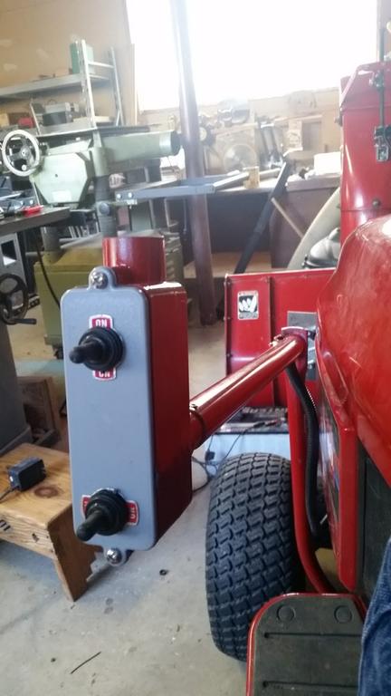

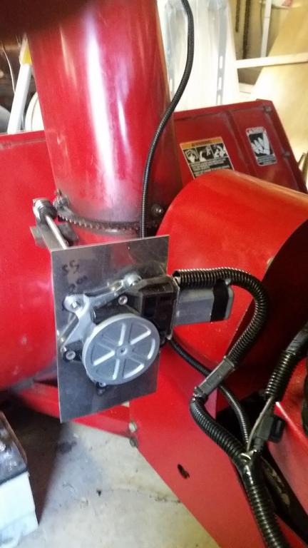

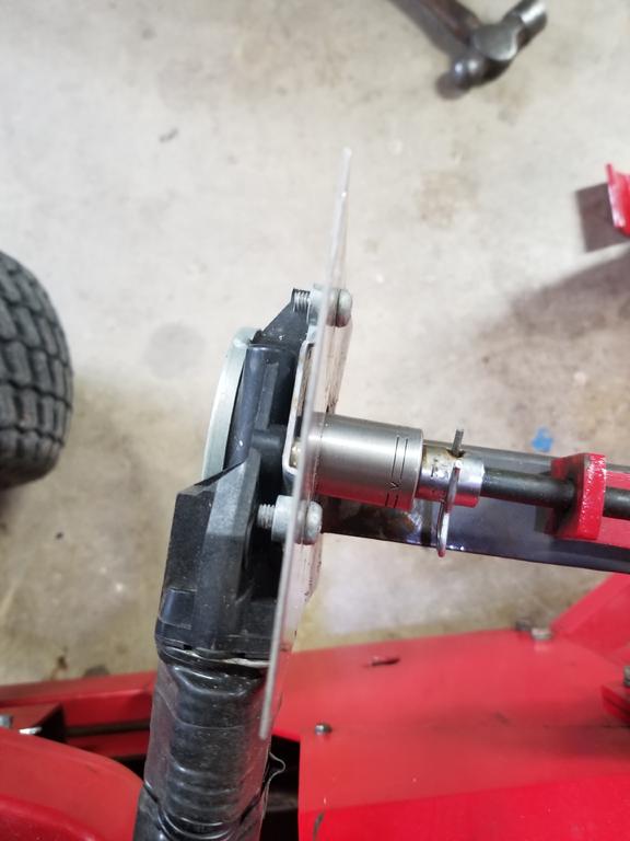

Xearl 132 #30 Posted December 8, 2018 Upper is Rover power seat motor . Rotator is a 2001 Chevy Silverado window regulator motor . I found a 3/8" 12pt. socket to fit over the gear and a 3/8" to 1/4" fit over the worm gear shaft . . Made a mount for the controls that fastened to the shaft support . Ther is a 20amp fuse in the power source .The whole set up come off very easily . ED Share this post Link to post Share on other sites
peter lena 9,941 #31 Posted December 8, 2018 that's a neat set up, as you are finding out , it needs some tweaking to make it easier / smoother. you might try some " SUPER LUBE SYNTHETIC GREASE " on your iced up gears , probably make it a non issue. thank you for the show and tell. pete Share this post Link to post Share on other sites

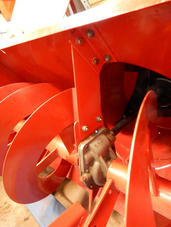

wallfish 20,219 #32 Posted December 8, 2018 6 hours ago, Xearl said: Upper is Rover power seat motor . Rotator is a 2001 Chevy Silverado window regulator motor . I found a 3/8" 12pt. socket to fit over the gear and a 3/8" to 1/4" fit over the worm gear shaft . . Made a mount for the controls that fastened to the shaft support . Ther is a 20amp fuse in the power source .The whole set up come off very easily . ED Nice setup. What's this cover for? Share this post Link to post Share on other sites

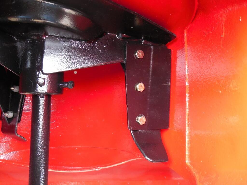

WVHillbilly520H 10,378 #33 Posted December 9, 2018 53 minutes ago, wallfish said: Nice setup. What's this cover for? John, that's the drive unit cover because of the xi series longitudinal mount engine and PTO vs the classic transverse mount side PTO. Share this post Link to post Share on other sites
wallfish 20,219 #34 Posted December 9, 2018 11 hours ago, WVHillbilly520H said: John, that's the drive unit cover because of the xi series longitudinal mount engine and PTO vs the classic transverse mount side PTO. Ah Ha, never noticed that was for the xi. I was hoping it was some kinda cool mod to the blower. Share this post Link to post Share on other sites
