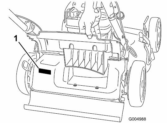

Digger 66 3,530 #15 Posted November 27, 2018 8 hours ago, gwest_ca said: Mind posting the Toro model number of this unit? I'm curious. Garry There is no "model #" on any of the decals but there is a SKU # . It's 21038 20074 and it's in the pic . Share this post Link to post Share on other sites
gwest_ca-(File Mod) 12,478 #16 Posted November 27, 2018 Using 20074 found this for the VIN location. A 2007 model. Sometimes deep into Toro you can find service manuals but only on the transmissions for this one. The operator manual mentions lead-acid battery so this may be the wrong one. Also noticed the fuse is 40 amp. Garry 1 Share this post Link to post Share on other sites
