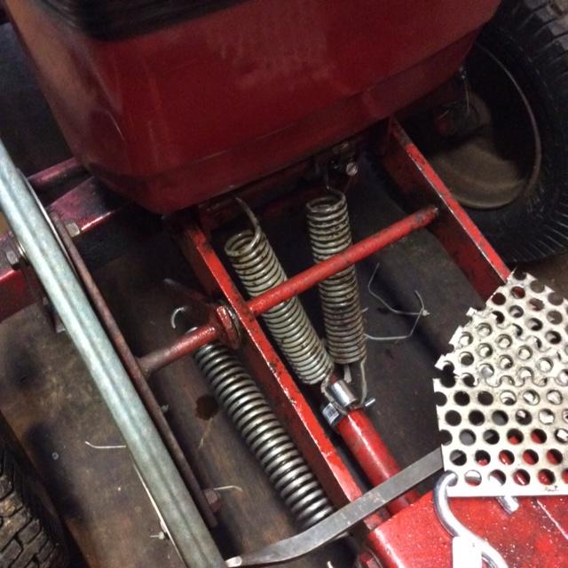

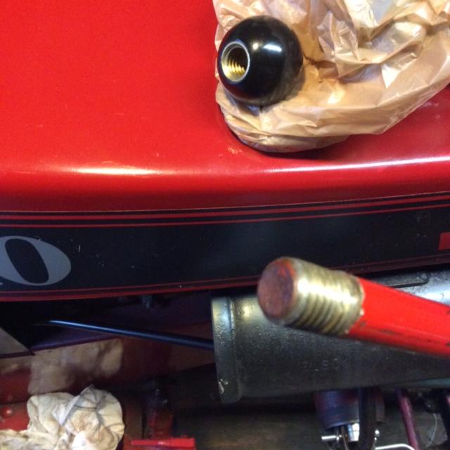

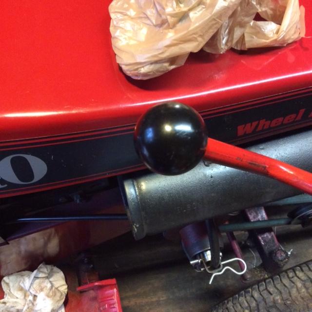

peter lena 9,603 #1 Posted November 25, 2018 just added a screw on round plastic knob with brass threaded insert to my snow blower chute turn rod , only a matter of threading with die nut on the end of the rod handle. picked up knob at my local true value store, nice smooth improvement. next I added two heavy springs to my blower lift rod , pulling just under the lower front hood area, on frame head , much easier to lift, these assist the back of rod spring. still moving things around to get it like I want. pictures to show 6 4 1 Share this post Link to post Share on other sites
ebinmaine 76,170 #2 Posted November 25, 2018 Nicely done Sir. Impressive how something so simple and inexpensive makes a chore so much more enjoyable. Thanks for posting. Share this post Link to post Share on other sites

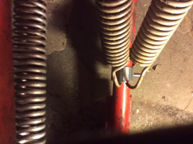

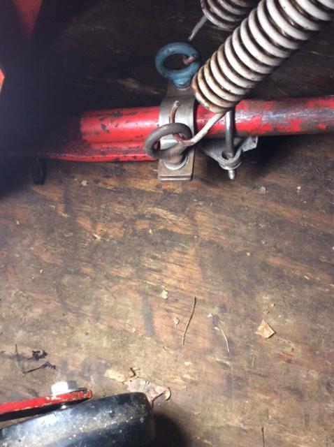

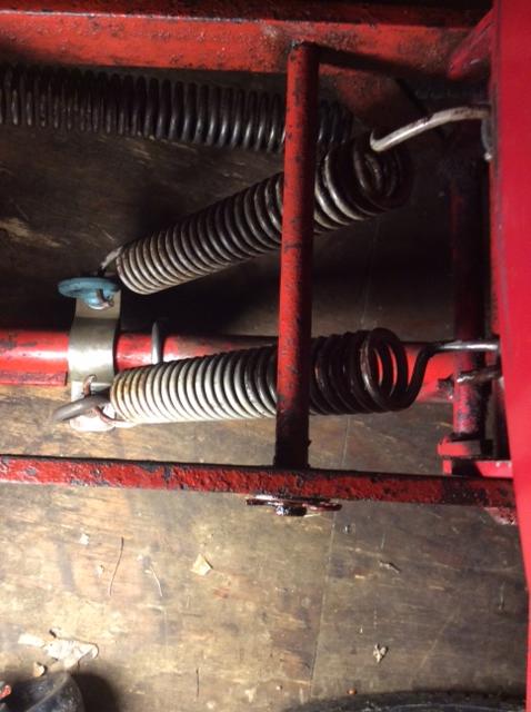

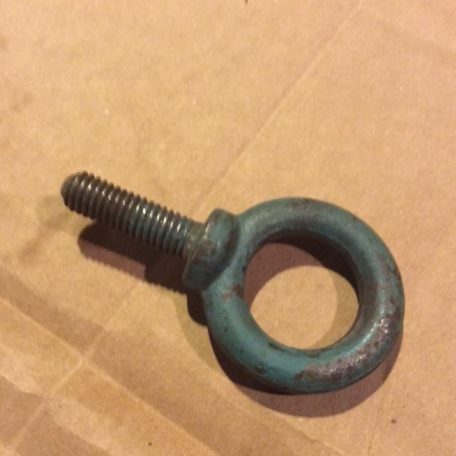

peter lena 9,603 #3 Posted November 27, 2018 adding to this, I said I was moving things around to get it better, I used a 1_ 1//2" fence post squeeze clamp to put on lift rod, also used a korn clamp that holds piping 2 ways, to back up the squeeze clamp. used 2 , 3/8 " threaded eye bolts at bottom of hood mounting holes. eyes inside of frame , under lower front hood edge. once I got it all in place , I backed off the lift rod clamps, just snug, with blower raised, now hammer tap the two clamps forward , hitting the rear clamp, on the bottom horizontal face, to push the other to increase spring tension. found this to really make the blower lift ,a non issue. the eye bolts really secured and separated the lift springs. just an idea that makes blower lifting easy, pete 6 3 Share this post Link to post Share on other sites

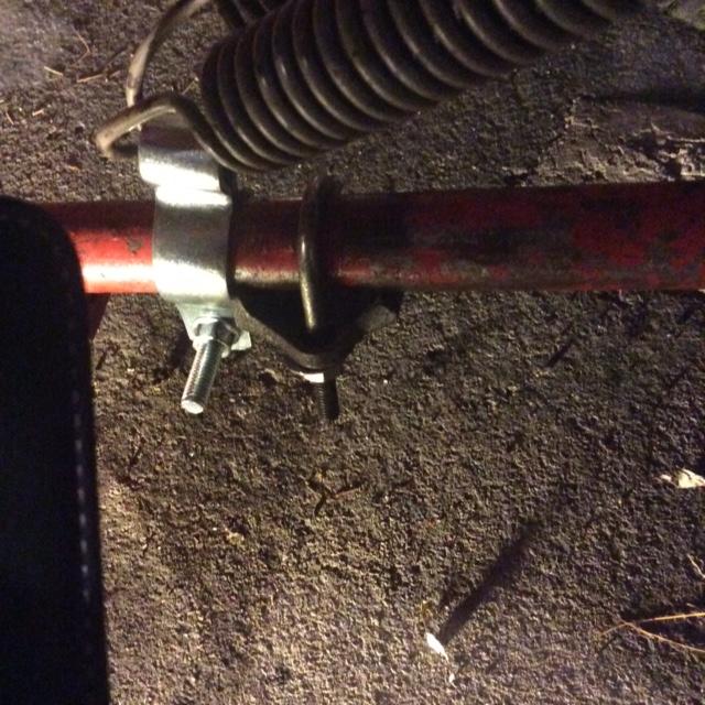

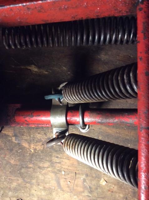

peter lena 9,603 #4 Posted December 1, 2018 as all trials go ,I also tried a " riser clamp " 1 1/4" https://www.mscdirect.com/product/details/02163897 in place of the post clamp, to hold springs , cut off the excess side width, after the bolt holes. used eye bolts in place of bolts to hold springs. I still use the " korn clamp " conduit bracket to back up the riser clamp ,as a good driving tension point. I will send a picture ,asap, going eye to eye with spring tension is much smoother , blower weight lift now is about 20 lbs., on lift handle. dr Franken horse. Share this post Link to post Share on other sites
peter lena 9,603 #5 Posted December 1, 2018 pictures of riser clamp, with eye bolts for spring lift to raise snow blower. just adjusting with the change made it easier, lubricated all friction points. without question, springs closer to heavy blower make for an easier lift, pete 5 1 Share this post Link to post Share on other sites

peter lena 9,603 #7 Posted January 2, 2019 hello kcuhc , glad to have you onboard, as you can see we all have issues and improvements to make on our horses. there are nagging areas, and other spots that you just want to improve. that snow blower lift area , will definitely test your left arm strength in use. interesting, since I added the springs and adjusted its cycle function , its much smoother ,and lift effort is a non issue. I was looking at the fix from every angle, it was hiding in plain site. the chute angle ball ,was another , improvement , that works easily with mittens. adjusting the lift springs to the end of the lift tube skid , really takes advantage of basic leverage, I just kept making changes till it worked with very little effort. I regularly talk about lubrication, at friction points, because it works. if I can help , let me know , or ask the site , good wrenching , pete 2 Share this post Link to post Share on other sites

peter lena 9,603 #13 Posted November 22, 2021 @ebinmaine thanks for the memories ! car hood springs , remember those ? if you can get some they are like the perfect lift for a plow set up . also help out on a blower , use an eye bolt for a solid mount spot , pete 1 Share this post Link to post Share on other sites
