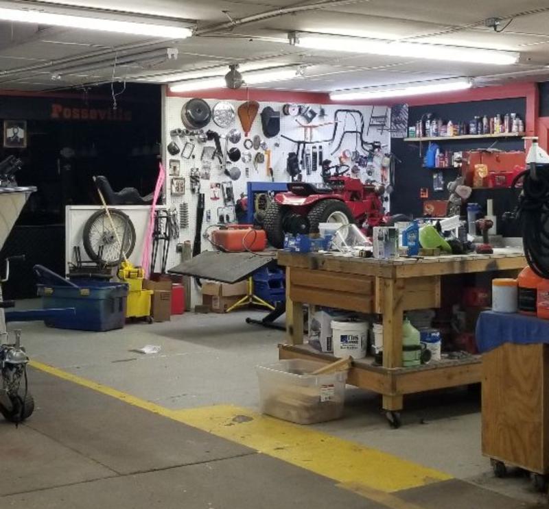

Vinylguy 4,797 #2 Posted November 20, 2018 I like the width of yours once the tractor is up as it makes access underneath a bit easier. Gary's bike lift is great but is a bit wider. Here is a poor image of it. 1 Share this post Link to post Share on other sites
peter lena 10,109 #3 Posted November 20, 2018 that is a great piece, if I had a shop like that ,it would be tuff going back in the house, good set up , pete 1 1 Share this post Link to post Share on other sites

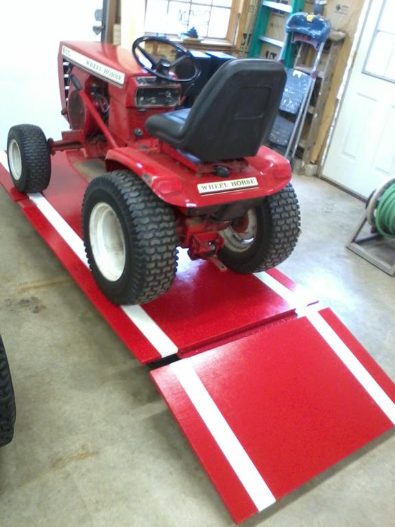

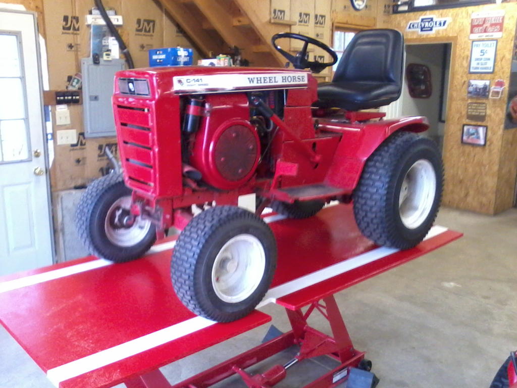

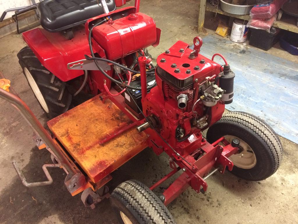

jay bee 915 #4 Posted November 20, 2018 Got mine this past summer for $279. Put a wider board on it. Use it for everything now cause I'm too old to bend over and work on things on the floor!!! 7 4 Share this post Link to post Share on other sites
Marv 996 #5 Posted November 20, 2018 22 hours ago, jay bee said: Got mine this past summer for $279. Put a wider board on it. Use it for everything now cause I'm too old to bend over and work on things on the floor!!! That's why I got mine. I like the painted platform. I wanted to do that but started using it right away and never got it done. Nice job. Marv 1 Share this post Link to post Share on other sites
Tankman 3,528 #6 Posted November 21, 2018 23 hours ago, jay bee said: Got mine this past summer for $279. Put a wider board on it. Use it for everything now cause I'm too old to bend over and work on things on the floor!!! Great setup! I'm going to get one, I'm 71+ and bending working low 'bout ready to start wearing knee pads along with my headlamp. That's one reason I hired a crew. 2 1 Share this post Link to post Share on other sites
Daron1965 644 #7 Posted November 21, 2018 On 11/19/2018 at 7:46 PM, jay bee said: Got mine this past summer for $279. Put a wider board on it. Use it for everything now cause I'm too old to bend over and work on things on the floor!!! Is that plywood on the deck and ramp? How wide did you make it? It looks very nice. 1 1 Share this post Link to post Share on other sites
jay bee 915 #8 Posted November 21, 2018 (edited) 1 hour ago, Daron1965 said: Is that plywood on the deck and ramp? How wide did you make it? Yes, it is 3/4" plywood. The deck is 40" x 88" and the ramp is 40" x 24". The cycle lift has raised sides on it, so I put 3/4" x 2 1/2" runners under the plywood so there is no side to side movement. But before I attached them I put pins down through them and drilled out the deck of the cycle lift accordingly so that when in place the deck board can't move forward or backward. This allows me to just lift the deck board off which makes it easier to store when needed. I actually borrowed most of this idea from fellow RS Member @Texas Todd after reading one of his posts. Just one more reason I love this forum and it's members!!! Edited November 21, 2018 by jay bee spelling 3 1 Share this post Link to post Share on other sites

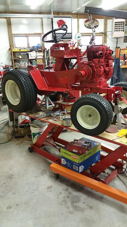

19richie66 17,950 #10 Posted November 21, 2018 Hope to one day make this stationary and put a wider top on it. Right now at least I can move it around. Doesn’t go as low as I would like it but it raises almost to 6’ high. Will be nice to be able to get a tractor to where I can stand up and work on it. 4 Share this post Link to post Share on other sites

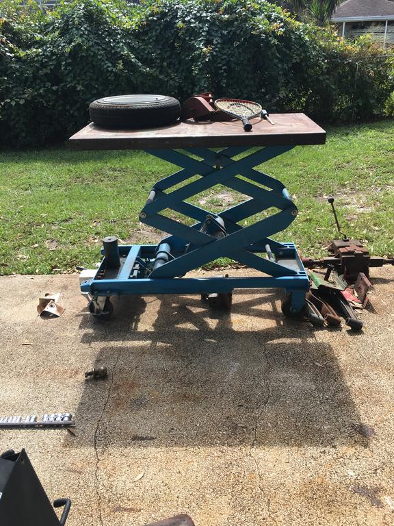

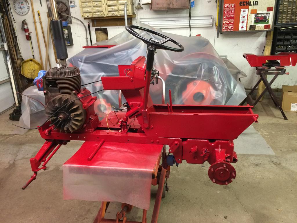

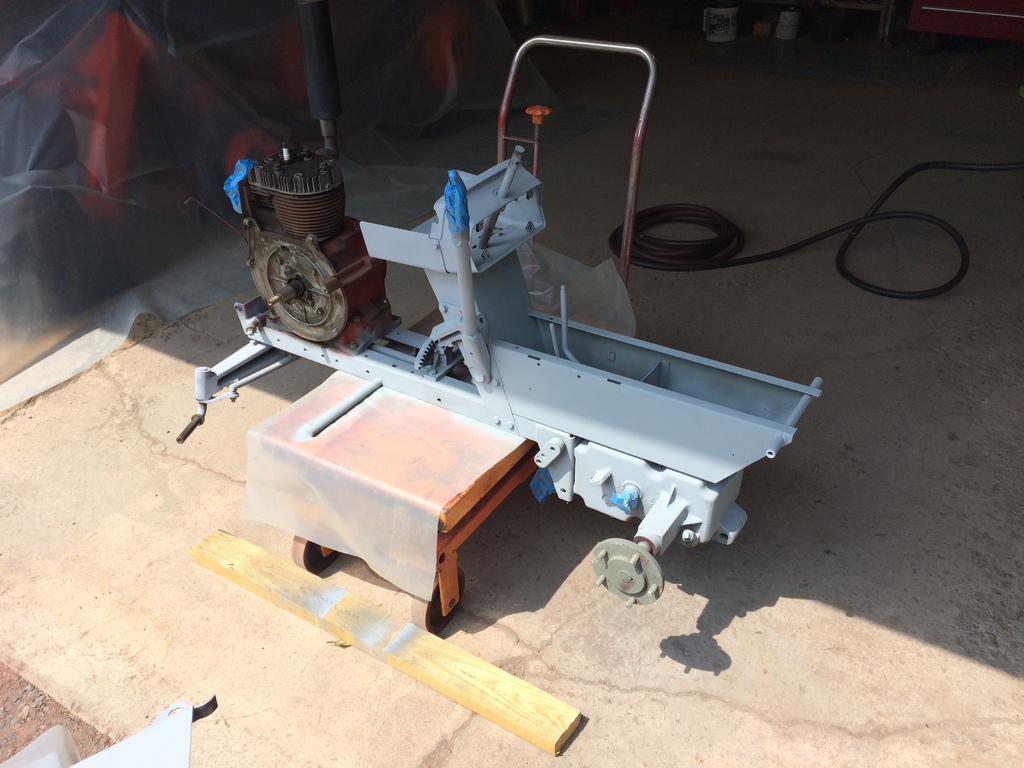

squonk 48,328 #11 Posted November 21, 2018 Maybe not for a GT 14 or 520 but this HF table lift picked up my 1267 with no issues and it's stores a heck of a lot easier than a bike lift. 4 Share this post Link to post Share on other sites

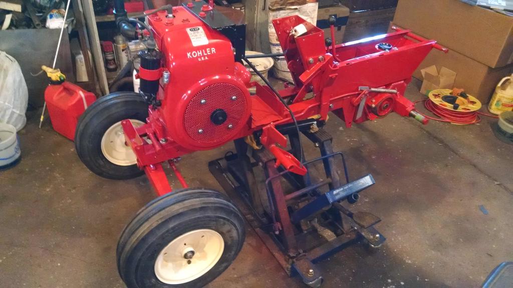

Achto 32,927 #16 Posted November 21, 2018 1 hour ago, Retierd Wrencher said: Achto I used to put black of 4x4 on the lift to give more hight. I think I even tried one time 6x6`s could not find picks. I did throw together this jig to gain 3" more lift. It also allows the side clearance needed so that the tractor can be completely assembled while on the lift. 1 1 Share this post Link to post Share on other sites
Retired Wrencher 7,037 #17 Posted November 22, 2018 On 11/21/2018 at 8:30 AM, Achto said: I did throw together this jig to gain 3" more lift. It also allows the side clearance needed so that the tractor can be completely assembled while on the lift. Nice job on the Jig. It does help. 1 Share this post Link to post Share on other sites
