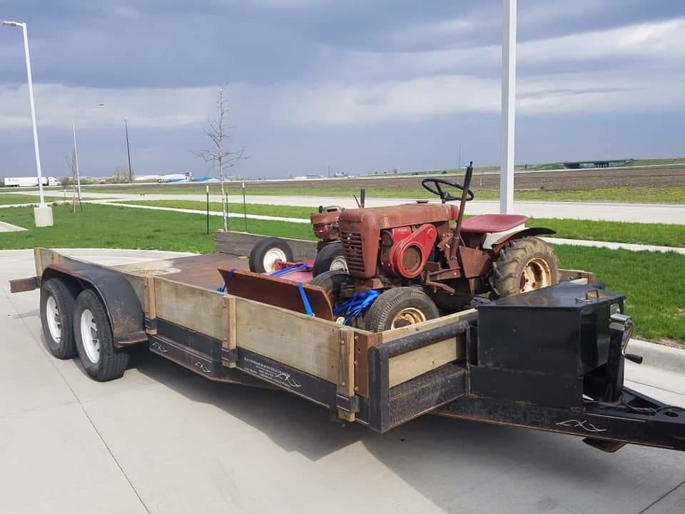

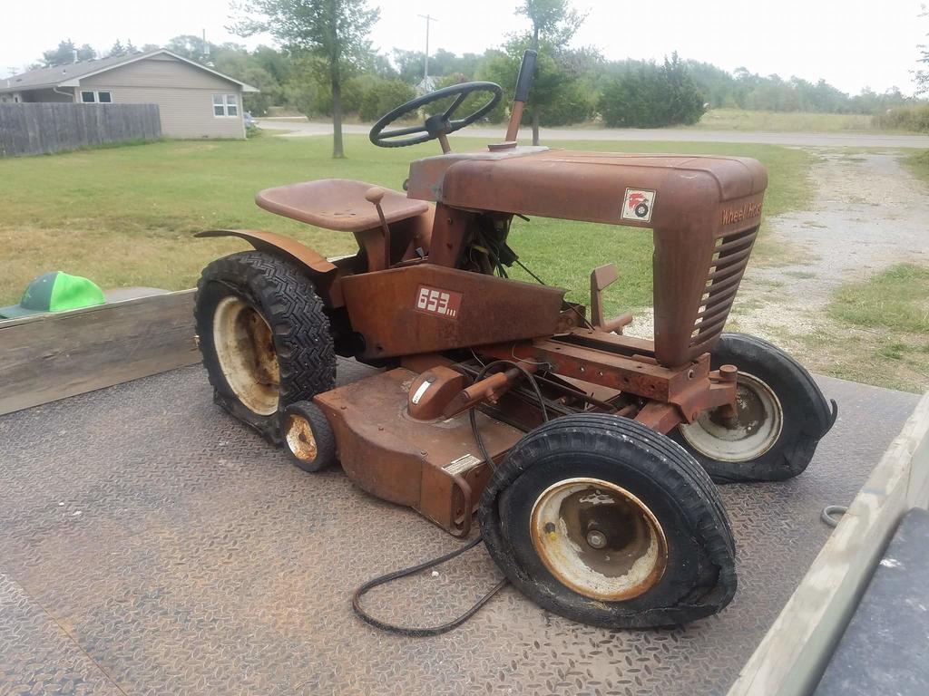

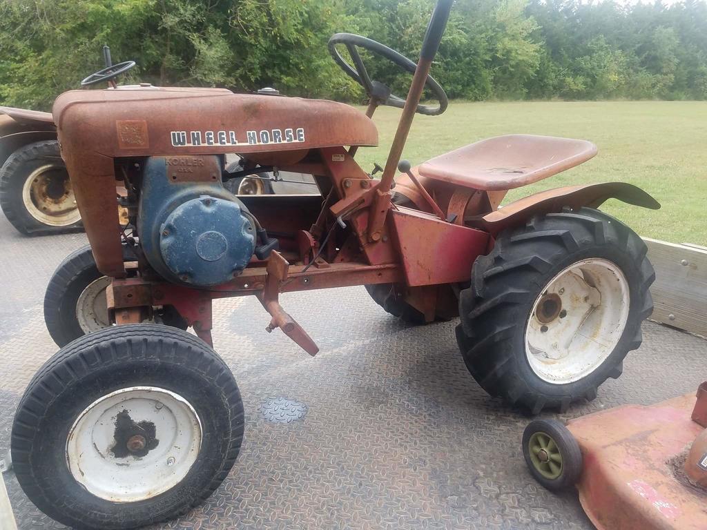

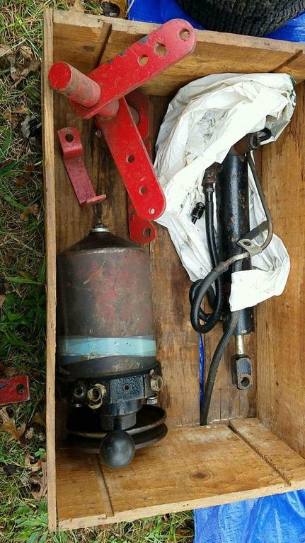

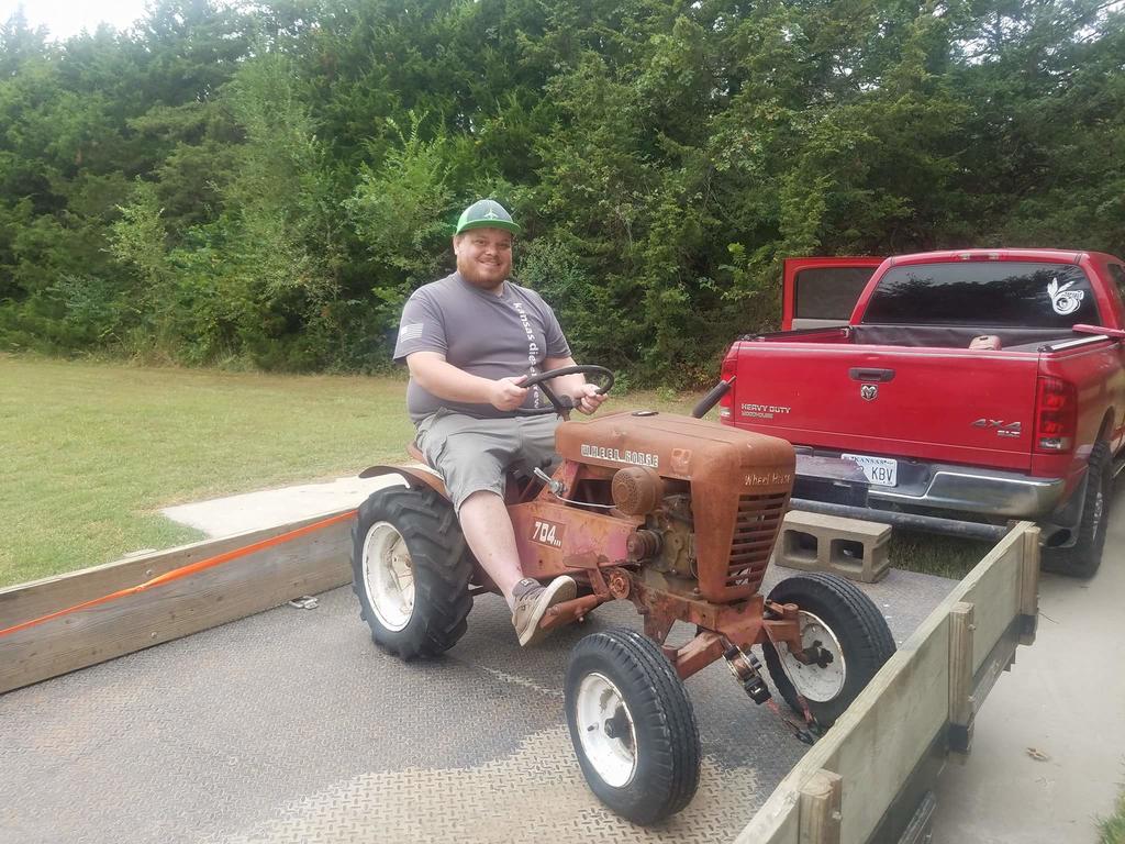

DBlackston 333 #1 Posted November 14, 2018 (edited) Hello all, I am starting on my first Wheel Horse rebuild, and first real rebuild of anything like this. I have a decent amount of experience working on things but have not done much to older items so this will be a new adventure to me. Here is the subject for the restoration, a 704 Wheel Horse I found locally on Facebook Marketplace. Originally looking for a RJ or Suburban for my Grandfather but I fell in love with these things along the way and picked up a couple tractors and implements along the way. I'd like to make this into more of a show style tractor to play around on, I have since picked up an 854 and a slew of implements for other tasks. I started this thread to share my progress and also because I could not find all of my answers other places and hope to ask them here where others who may have the same trials and tribulations can see them in the future. Also attached are some photos of the beginning of the tear down process, a picture my wife loves of me on my new horse, and the 653 I bought from the same place. I paid $300 for the two of them together so I dont think I walked away too bad on the deal. Edited November 14, 2018 by DBlackston Found additional photos 9 5 Share this post Link to post Share on other sites

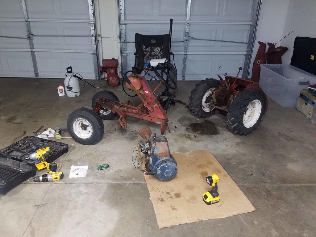

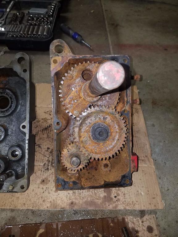

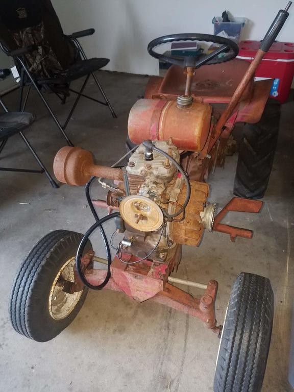

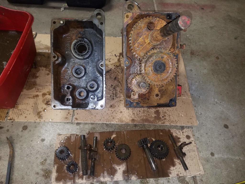

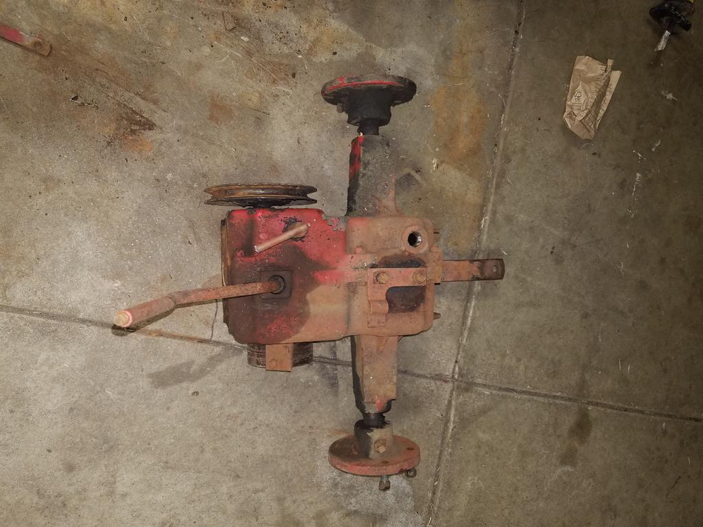

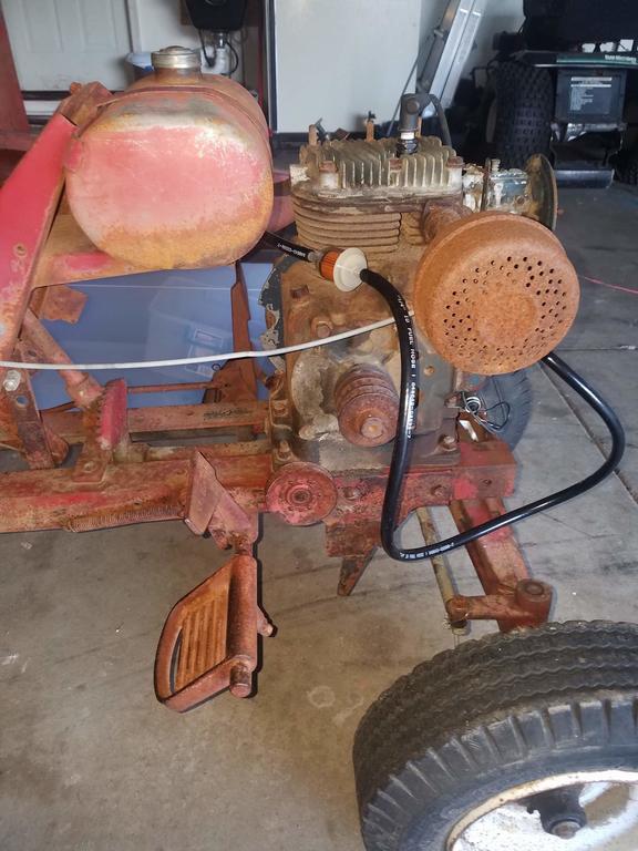

DBlackston 333 #3 Posted November 14, 2018 (edited) When I purchased this tractor the rear end was locked solid and the motor did not run. I have not done much small engine work as I have never had a small engine break down on me. Every vehicle I have ever owned has been a diesel as well so this whole spark concept is new to me. I tore the trans apart, and have since lost the pictures, the 1533 bushings were absolutely shot and all of the gears and shafts were pitted. (EDIT: I located some of the pictures) I decided the trans was not worth saving and sourced an 8 speed out of a C-111 a friend had for less than the cost of 1 bearing. She definetly needs new seals though.(EDIT: See last attached picture) I had originally planned to fabricate a SR-64 kit for this tractor to use with my WT-244 Tiller. I even sourced an original SR-64 belt cover from a member over on Facebook. Kelly Hollis. If anyone has the dimensions for the idler bar I would still love to have them. However with the 8- Speed unit that shot the SR-64 plan in the foot. I was also a little bummed to learn that being a 704 tractor it had a dash tower that would not accept my HY-3 unit I picked up from DJ, HCminis. Will have to put that on the 854 worker also from Dj. Edited November 14, 2018 by DBlackston Found additional pictures 3 1 Share this post Link to post Share on other sites
Lane Ranger 12,167 #4 Posted November 14, 2018 This was my 704 which I left in this condition! Sold but it was a fun tractor to ride! 1 3 Share this post Link to post Share on other sites

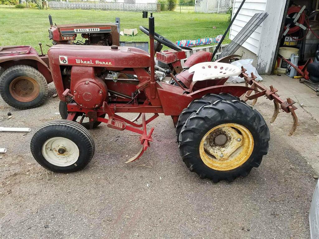

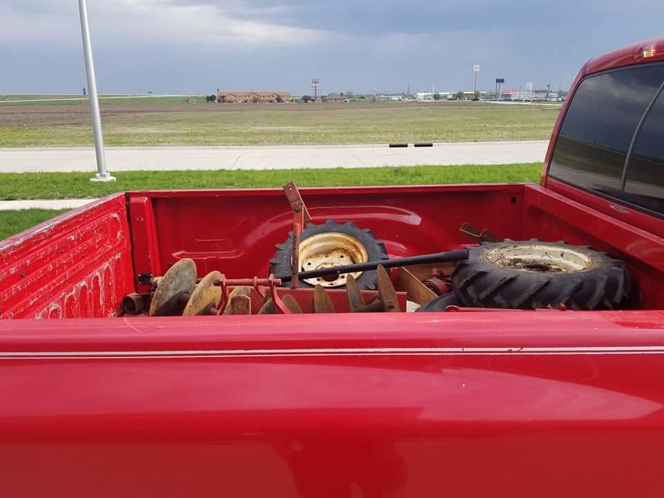

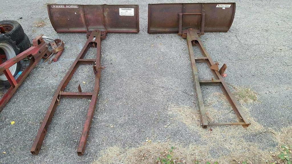

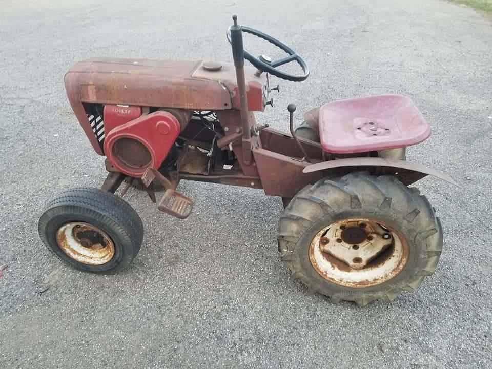

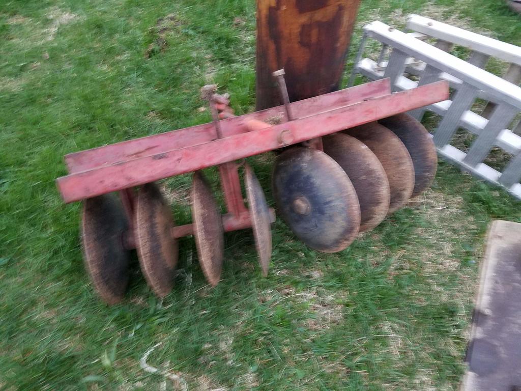

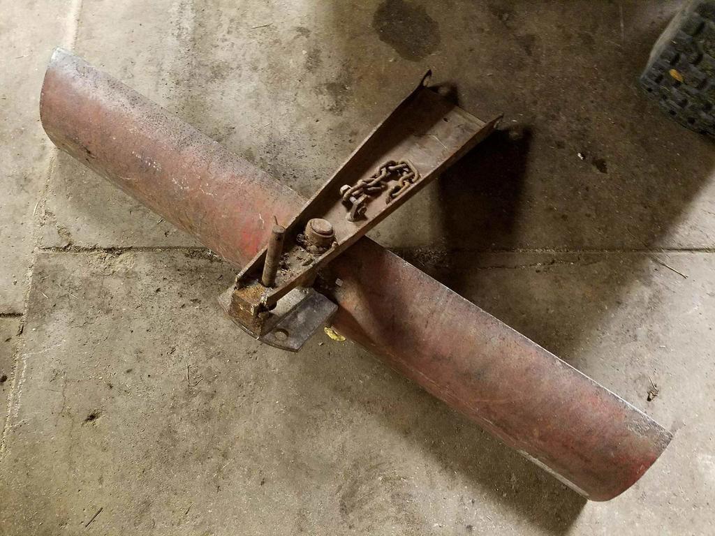

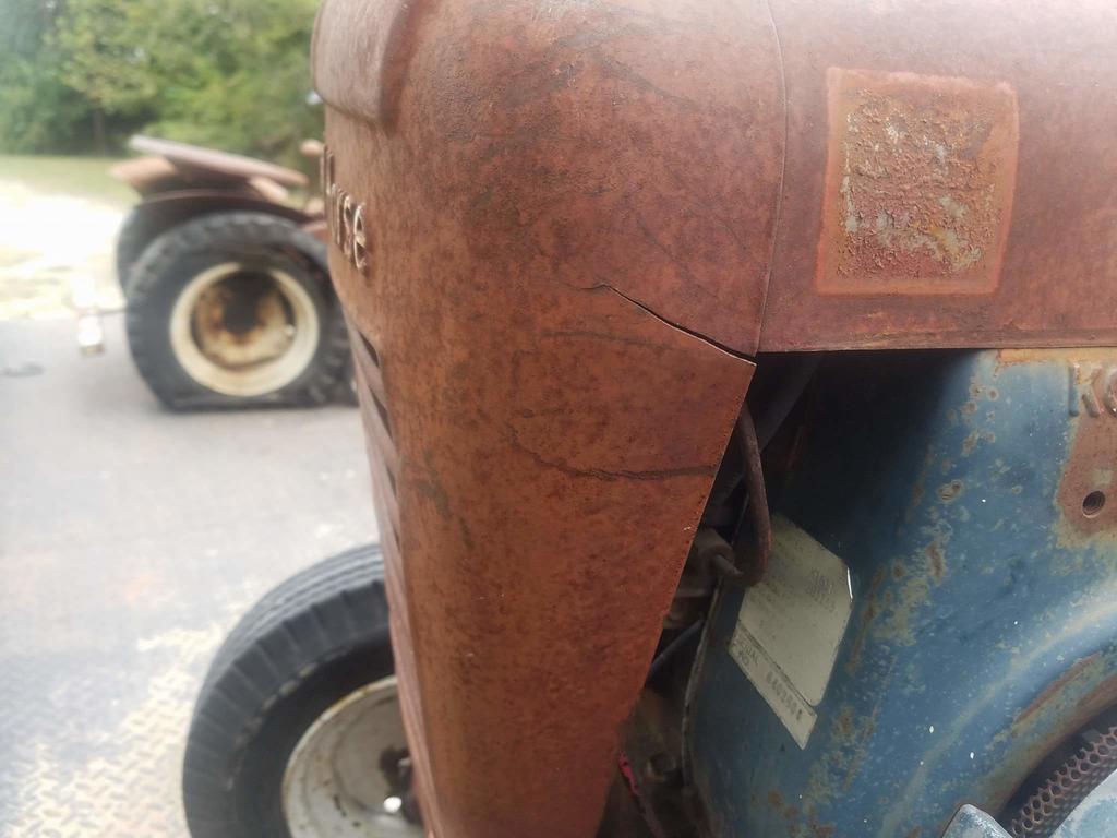

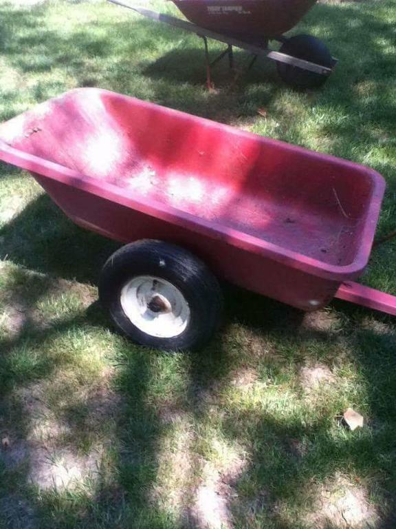

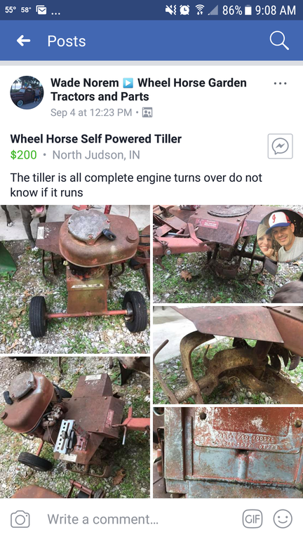

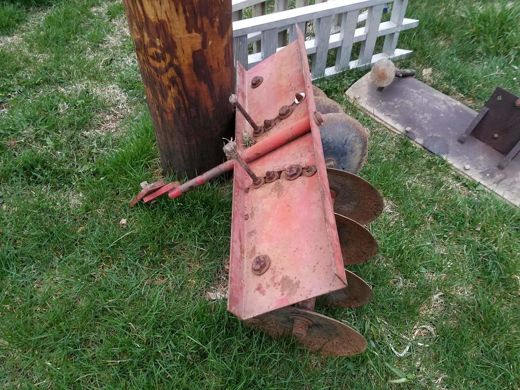

Pullstart 71,561 #5 Posted November 14, 2018 Looks like a great project! Do you have pics of the 854 or your implements? Share this post Link to post Share on other sites
DBlackston 333 #6 Posted November 14, 2018 1 hour ago, Lane Ranger said: This was my 704 which I left in this condition! Sold but it was a fun tractor to ride! Lane Ranger that is an amazing looking tractor. Mine was unfortunately too far gone to leave as it was. Too many dents and dings and busted parts. Could have never made a evenly patinad tractor out of it. 1 Share this post Link to post Share on other sites
DBlackston 333 #7 Posted November 14, 2018 34 minutes ago, pullstart said: Looks like a great project! Do you have pics of the 854 or your implements? Pullstart I have some pictures of them but none really show them well. I will try to get some decent pictures of them here in the next few days once the snow melts. These machines are fairly scarce here in Kansas, and shipping on the implements was going to cost a fortune 1 or 2 pieces at a time. I discussed some various options with my wife and we decided if I could find a few items I wanted we would make a trip out of it. She is a sucker for a good road trip. I had spoken with D.J. Harrison (HCMinis) in Indiana a few times about some of his items he had for sale and we came to an arrangment that I could buy a group of items and drive up when he had them all amassed for me. We left SE Kansas on a Thursday morning, and came home on Monday night. Along the way we went to Ozark Missouri and ate at Lambers, St. Louis Missouri to the Missouri Botanical gardens, and Parkers Landing, Coatsville Indiana to pick up the goods from DJ, and we stood on a beach at Indiana State Dunes by Lake Michigan across from Detroit and even had some Giordanos pizza in Chicago. She was a real trooper, driving the whole way. (I have problems falling asleep when I drive). Here is a picture of our haul home and a list of what we picked up as well as some pictures along the way. I dont have the official part numbers for all of them, I really need to make a list of those to help me look for parts and restoration tips on here. 854 Tractor WT-244 tow behind tiller 48" Front Plow Mid Mount Grader Blade Mid and Rear mount Cultivator Rear Garden Plow Disc HY-3 Hydraulic Lift Tub Cart A set of rear Ags on wheels 5 6 Share this post Link to post Share on other sites

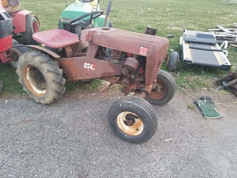

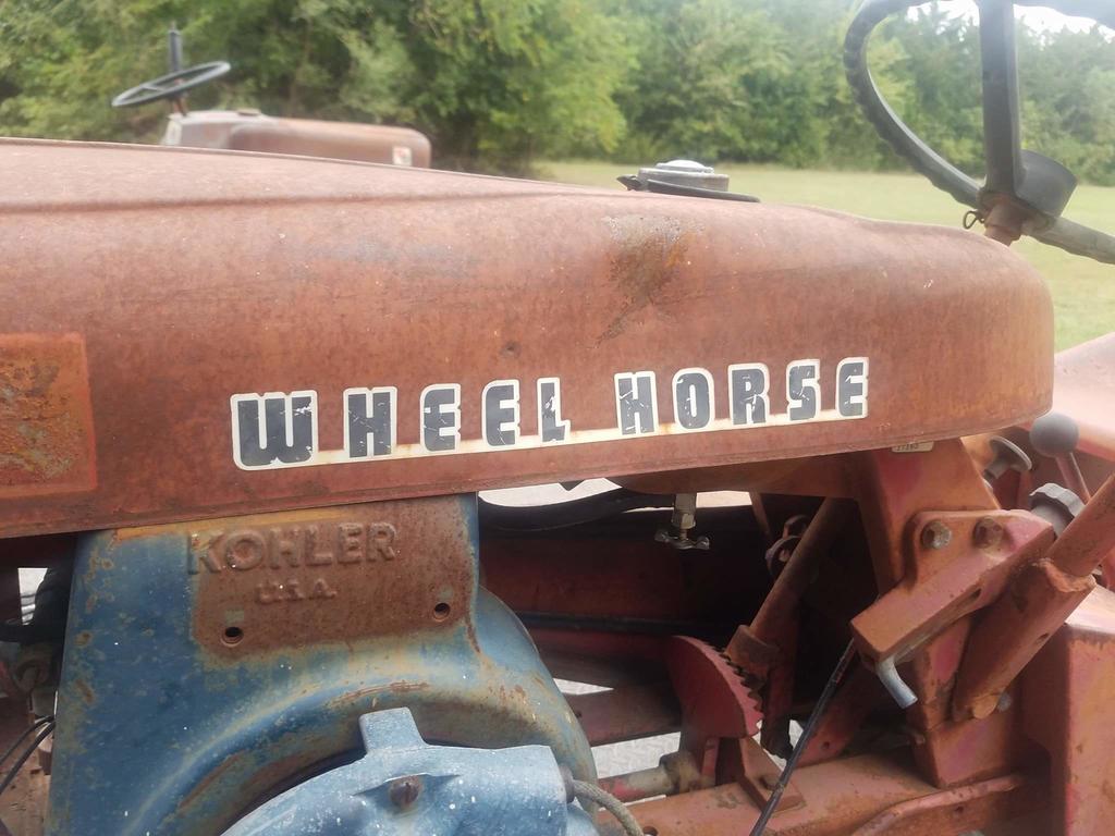

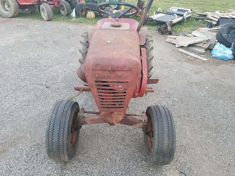

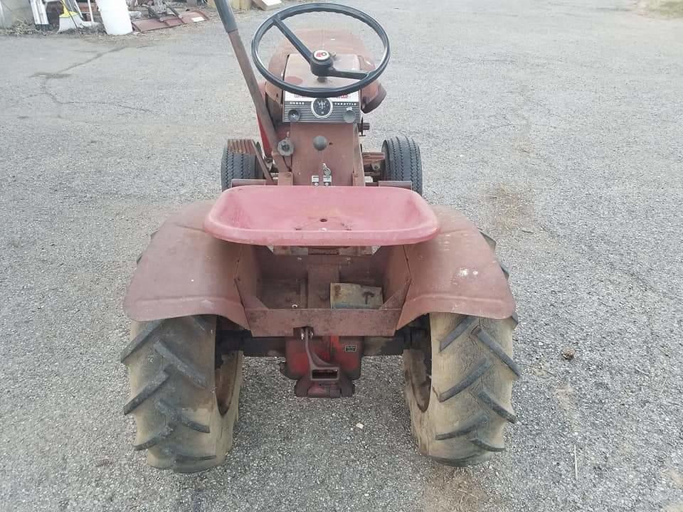

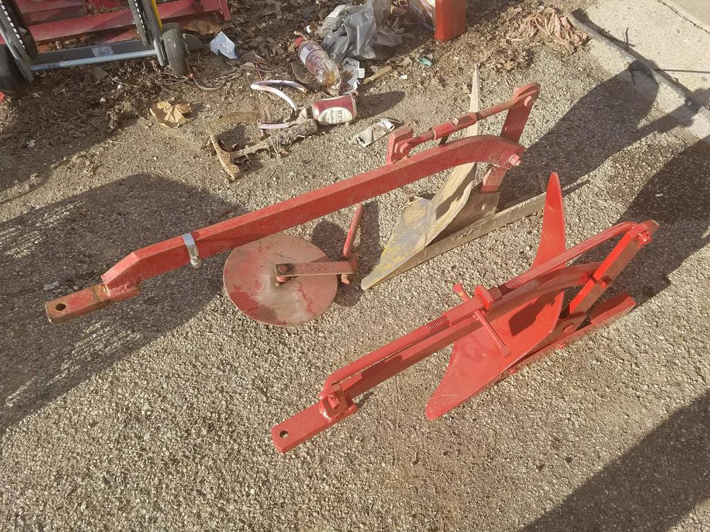

DBlackston 333 #8 Posted November 14, 2018 (edited) 1 hour ago, pullstart said: Looks like a great project! Do you have pics of the 854 or your implements? Pullstart, I actually did manage to wrangle up some photos of the 854 and some of the implements. Here you go! They are not my photos, but from the original sale adds so please bear with me. Edited November 14, 2018 by DBlackston 3 3 Share this post Link to post Share on other sites

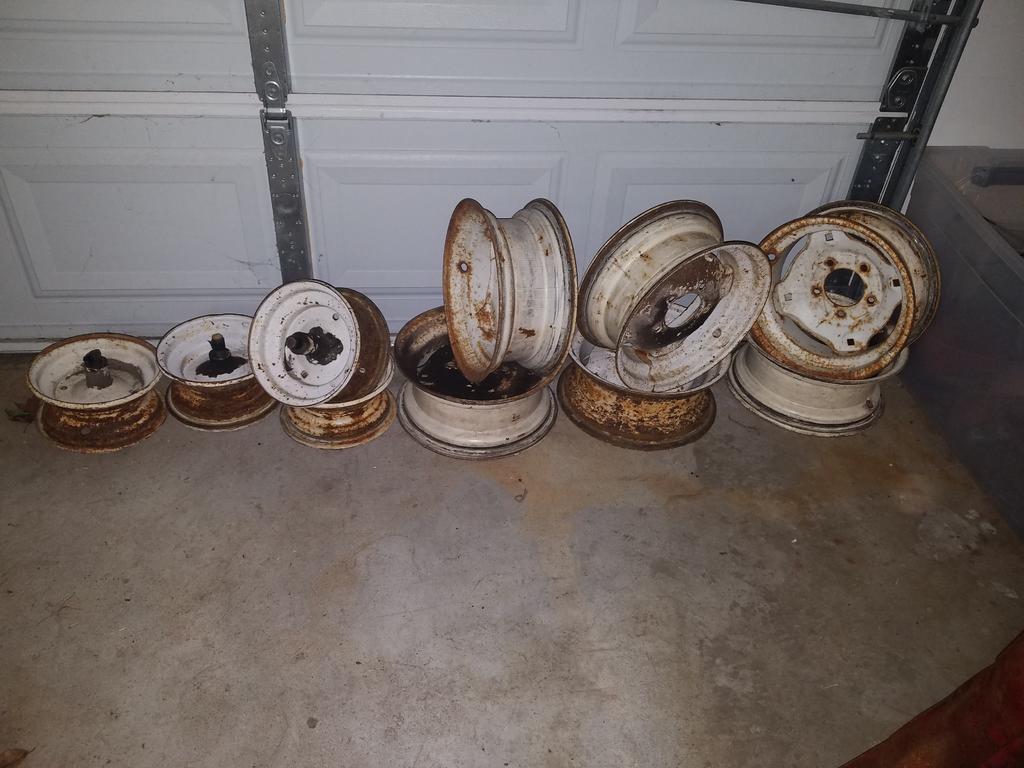

WHNJ701 4,173 #11 Posted November 14, 2018 I said it before the 854 is best looking wheelhorse they made. great score on everything. for all those rims I use a tote box filled with vinagar to remove to paint and rust it takes about a week or 2. I don't own a sandblaster, plus in my area it's expensive to get stuff blasted. have fun getting that steering column apart! they are a bear 1 Share this post Link to post Share on other sites

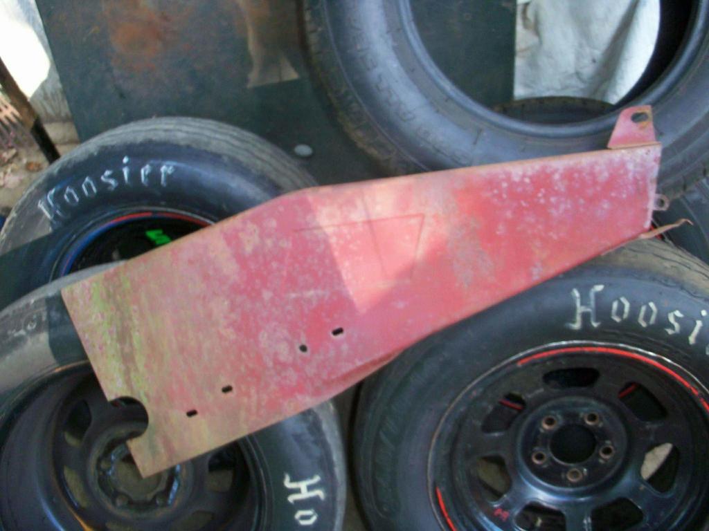

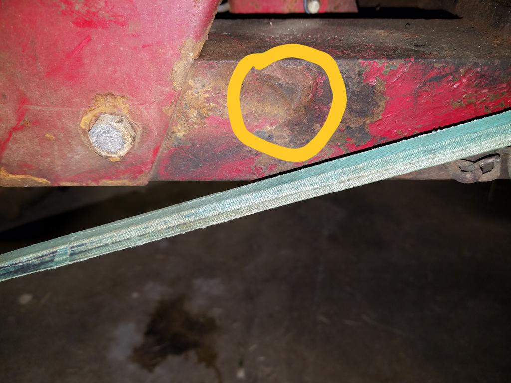

DBlackston 333 #15 Posted November 14, 2018 Along with the wheels I am going to sandblast and prime the frame. I have two holes to fill in the frame where the PO installed a non-original throttle cable. There are also 2 small welded on areas on the frame that I do not think are original. However I looked at my 854 and the same areas exist on it. Can anyone tell me what these are and if they can be removed to no Ill effect? Share this post Link to post Share on other sites
oliver2-44 11,847 #16 Posted November 14, 2018 One way to cleanup all those rims is an Electrolysis tank. (google E-Tank) Very simple and will remove rust and paint. I put my part in, remove and clean the loose paint one a day with a stiff bristle brush. In about 3 days parts ready for a final bristle brush scrubbing and done, with very minimal labor. Share this post Link to post Share on other sites
ebinmaine 81,281 #17 Posted November 14, 2018 2 minutes ago, oliver2-44 said: One way to cleanup all those rims is an Electrolysis tank. (google E-Tank) Very simple and will remove rust and paint. I put my part in, remove and clean the loose paint one a day with a stiff bristle brush. In about 3 days parts ready for a final bristle brush scrubbing and done, with very minimal labor. I suppose I ought to quit messing around and make us up one of those here Share this post Link to post Share on other sites
wallfish 20,744 #18 Posted November 14, 2018 2 hours ago, DBlackston said: There are also 2 small welded on areas on the frame that I do not think are original. However I looked at my 854 and the same areas exist on it. There was a little bracket (Z shaped) welded on there for mounting the belt guard. It'll keep the belt guard from shaking and/or rattling. Look for a hole in your belt guard which would be about 1 inch or so away from the weld on the frame 2 Share this post Link to post Share on other sites
DBlackston 333 #19 Posted November 14, 2018 1 hour ago, wallfish said: There was a little bracket (Z shaped) welded on there for mounting the belt guard. It'll keep the belt guard from shaking and/or rattling. Look for a hole in your belt guard which would be about 1 inch or so away from the weld on the frame That makes a lot of sense. Is it pretty common for those to be missing? If someone could grab a picture of one of those that would help me out. All three of my tractor's are missing it. Share this post Link to post Share on other sites

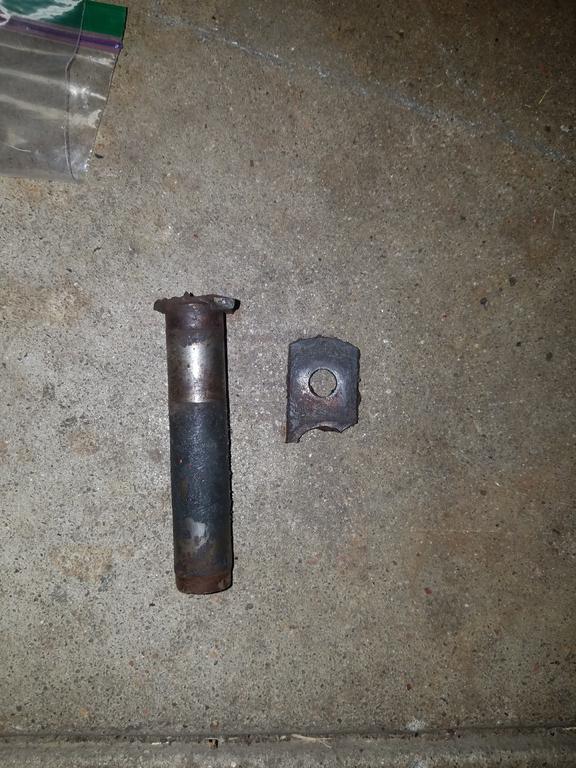

DBlackston 333 #23 Posted November 16, 2018 (edited) Well guys I am off to a semi slow start on this thing. I did have something delivered today that should help in the cold garage though. Two big boxes of insulation for the garage doors. Here soon I also plan on adding electric heat! I also spent some time today working on a CAD Model and some drawings of a Front Axle Pivot Pin. When they are complete I will post them up. Mine was unfortunately broken and worn when I removed it. My new pin will have some additional features such as: - A thicker tab at 3/16" instead of the factory 1/8" - A wider tab with 1/8" of extra material either side of the pin. - A 1/8 of stickout past the rear of the tab to allow a 1/8" fillet weld instead of the factory plug weld. - An additional bit of length to allow the installation of a 1/8" diameter cotter pin for safe measures. I plan on making mine out of some standard A36 for the tab and possibly 1018 or similar grade for the pin. I have seen on the forum some replacements manufactured from stainless or from some tool steel varities. I diskile this idea as I would much rather wear the pin out than wear the mating surfaces which I am sure are cast and low carbon steel. Edited November 16, 2018 by DBlackston 1 Share this post Link to post Share on other sites
jebbear 386 #24 Posted November 16, 2018 1 hour ago, DBlackston said: I diskile this idea as I would much rather wear the pin out than wear the mating surfaces which I am sure are cast and low carbon steel. Totally agree. Little parts and bushings are made to wear out, big parts not so much. 2 Share this post Link to post Share on other sites
DBlackston 333 #25 Posted November 16, 2018 Here is the finished drawing for a new Front Axle Pivot Pin Assembly. Now to get one made! Front Axle Pivot Pin (Mod).pdf Share this post Link to post Share on other sites
