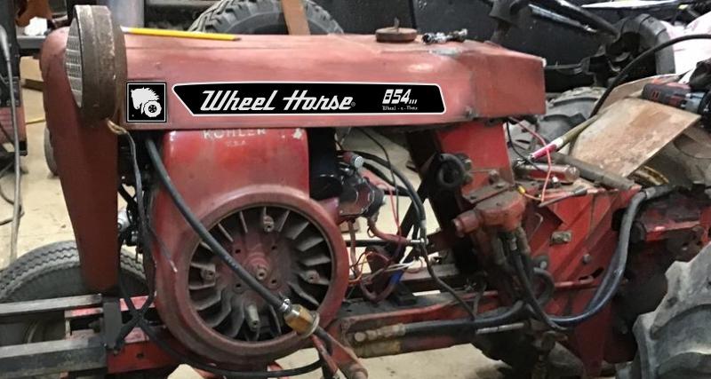

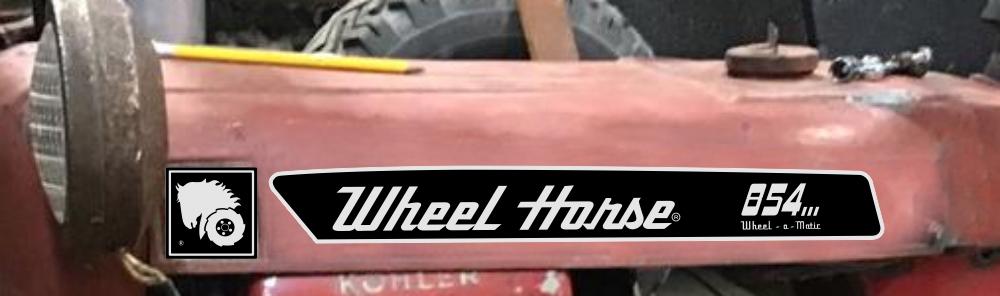

19richie66 17,858 #157 Posted February 5, 2019 On 1/27/2019 at 6:23 AM, Vinylguy said: Hard to tell till the new paint is done? Looks great but I would make the front of the decal either straight up & down or the same angle as the rear. Looks fantastic though. Still like the stars. Matches a certain cup that should be there soon........ 1 Share this post Link to post Share on other sites

19richie66 17,858 #160 Posted February 6, 2019 Well he posted the pictures 2 Share this post Link to post Share on other sites

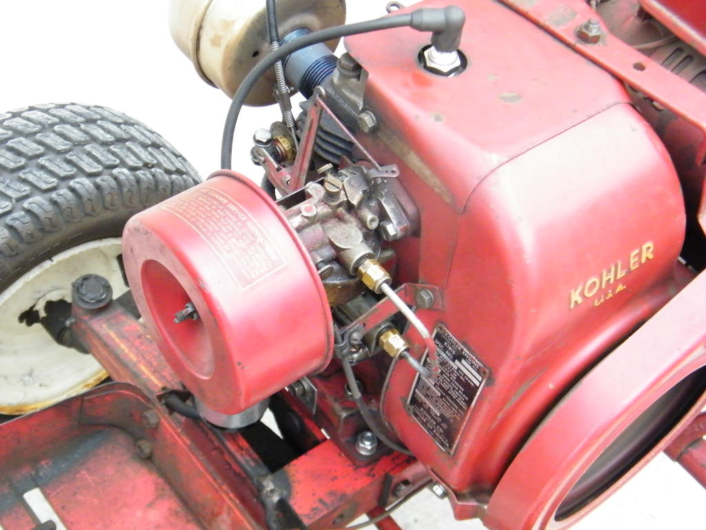

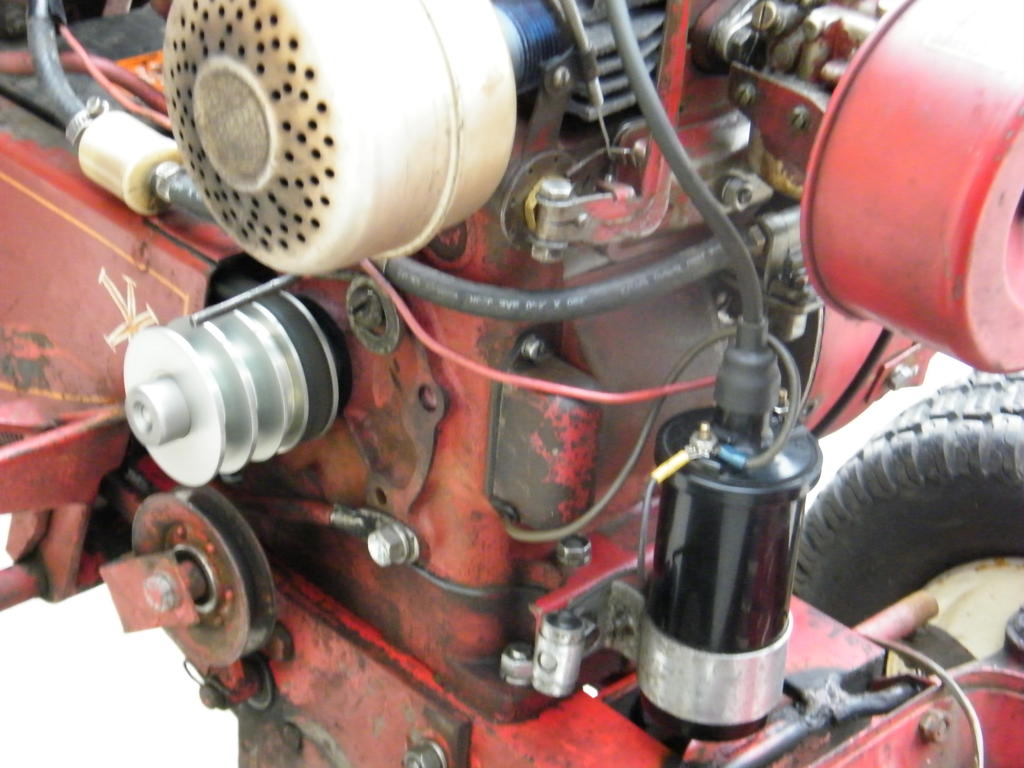

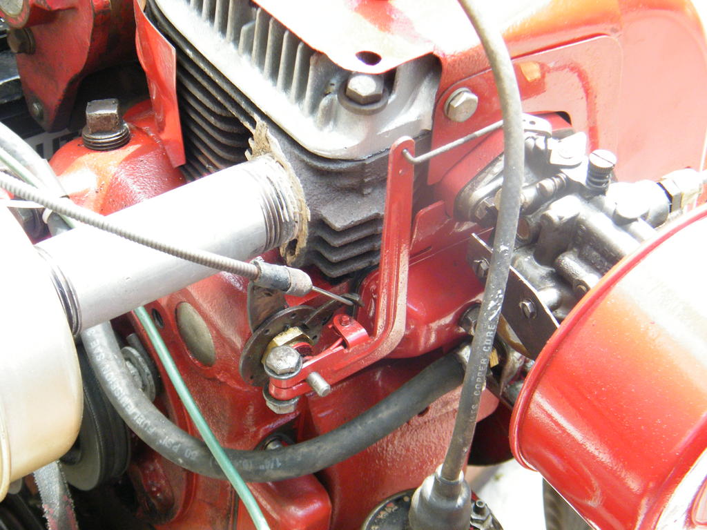

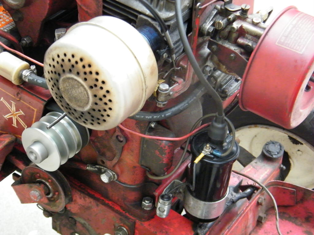

stevasaurus 23,662 #161 Posted February 6, 2019 The 1st 3 are the 857...the last one is the 876. terry, like Shannon said...you have to disconnect the throttle cable. You can adjust the engine speed by where that pinch clip pinches the throttle cable. It can allow you to pull the throttle out further by where you pinch the outer cable. check it out. 4 1 Share this post Link to post Share on other sites
Pullstart 69,589 #162 Posted February 7, 2019 8 hours ago, stevasaurus said: The 1st 3 are the 857...the last one is the 876. terry, like Shannon said...you have to disconnect the throttle cable. You can adjust the engine speed by where that pinch clip pinches the throttle cable. It can allow you to pull the throttle out further by where you pinch the outer cable. check it out. Thanks for the pics Steve, I can see that I am missing the tab on most if not all of my K-181’s for the throttle cable! I guess the spot welds broke? 2 Share this post Link to post Share on other sites
Pullstart 69,589 #163 Posted February 7, 2019 On 2/5/2019 at 6:46 PM, 19richie66 said: Looks great but I would make the front of the decal either straight up & down or the same angle as the rear. Looks fantastic though. Still like the stars. Matches a certain cup that should be there soon........ I like the stars too, I’m thinking those won’t change much unless I repaint it... which then might lead me to beg steal and borrow whatever it takes to get another Vinylguy custom package. That certain cup fits Frank just fine! 2 1 Share this post Link to post Share on other sites

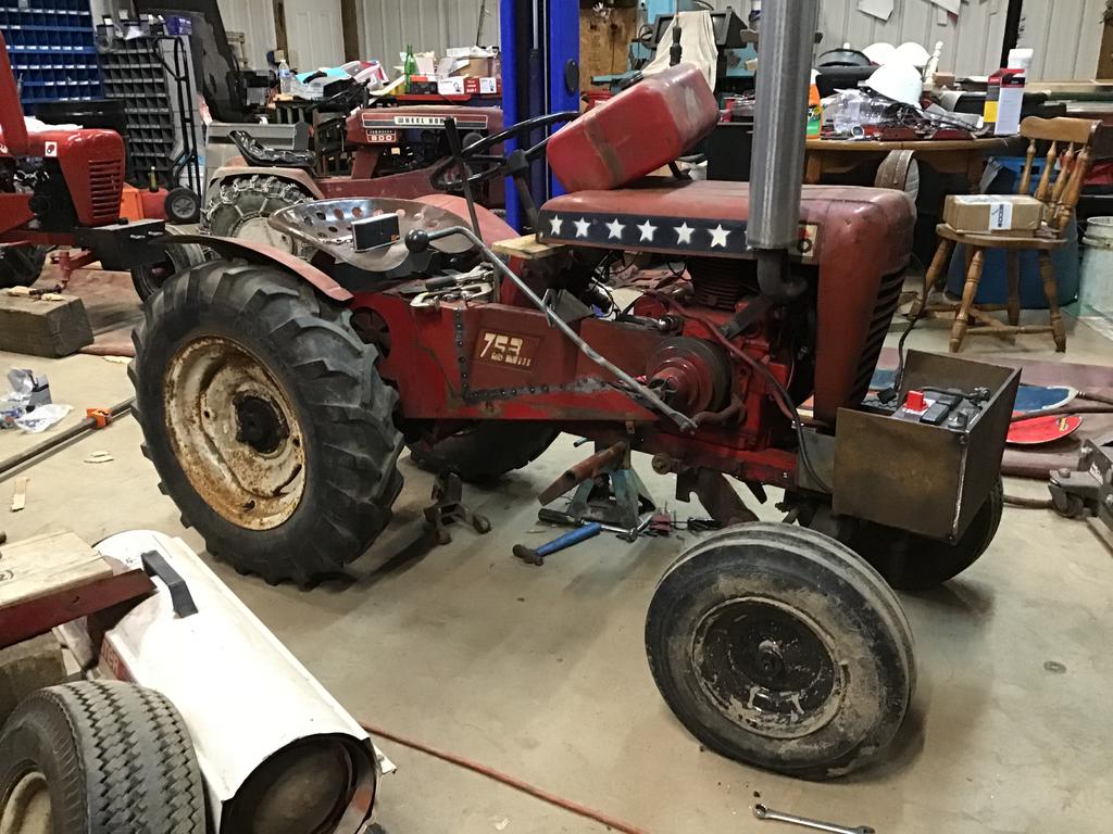

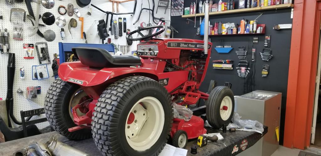

Vinylguy 4,771 #170 Posted February 22, 2019 (edited) Gary finished the powder coating on the exhaust for the 857 yesterday. It has a couple baffles but is still a bit louder than stock but not too loud. I like the looks but will see if I like it when in use. may have to replace with a traditional. Edited February 22, 2019 by Vinylguy 2 5 Share this post Link to post Share on other sites
Vinylguy 4,771 #171 Posted February 22, 2019 Just another picture. Will be working on a new wiring harness in a couple weeks. Adding a solenoid and new switch. Should be ready to mow the ridge soon. Come on spring!! 1 5 Share this post Link to post Share on other sites
ACman 7,715 #172 Posted February 22, 2019 (edited) Sweet sweet sounds of a a 8hp Kohler .... Tractor is beautiful too . Now am I'm seeing a new furnace in front of your tractor? Bringing back some memories. Sure wish I kept count of how many furnaces and AC's I installed during my career in HVAC . Edited February 22, 2019 by ACman 3 Share this post Link to post Share on other sites
Pullstart 69,589 #173 Posted February 22, 2019 Looks and sounds wonderful Terry! 2 Share this post Link to post Share on other sites
953 nut 65,094 #174 Posted February 22, 2019 5 hours ago, Vinylguy said: Should be ready to mow the ridge soon. Glad to see you will be putting your to work. Too many sit in the shed once they look that pretty! 4 Share this post Link to post Share on other sites
ebinmaine 78,171 #175 Posted February 22, 2019 13 minutes ago, 953 nut said: Glad to see you will be putting your to work. Too many sit in the shed once they look that pretty! Agreed. My honey and I are fixing ours up one at a time and they will be workers when they are done no matter how pretty they look. The ability to do the work that they do is the reason why we stick to the Wheelhorse brand. 5 Share this post Link to post Share on other sites
