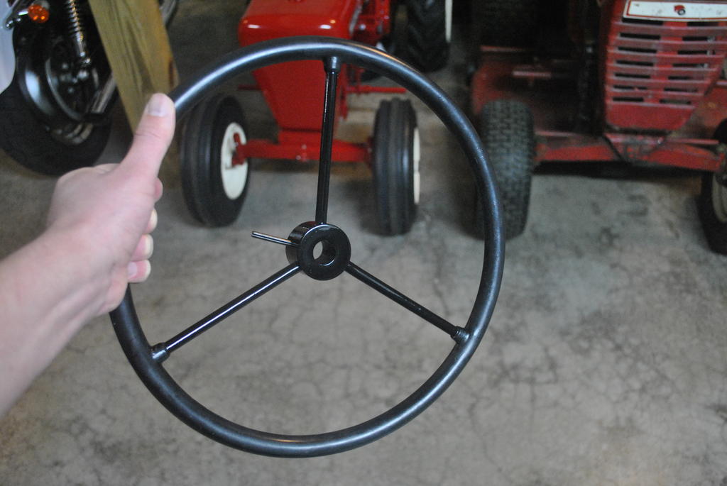

Horse Play 393 #76 Posted December 31, 2019 Also received a new, reproduction Cub Cadet steering wheel that will be modified to work on the RJ. 4 1 Share this post Link to post Share on other sites

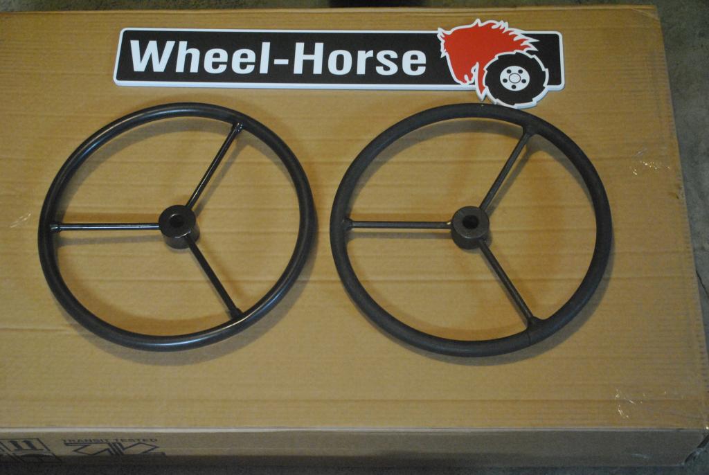

WHX?? 57,470 #77 Posted December 31, 2019 (edited) Got a to those wheels Horse Play? Are they the ones with the splines inside? Like this? https://www.steinertractor.com/GTS002-Steering-Wheel Edited December 31, 2019 by WHX24 1 Share this post Link to post Share on other sites
ACman 7,738 #78 Posted December 31, 2019 15 minutes ago, WHX24 said: Got a to those wheels Horse Play? Are they the ones with the splines inside? Like this? https://www.steinertractor.com/GTS002-Steering-Wheel Jim those are the ones far as I know .... 1 Share this post Link to post Share on other sites
Lane Ranger 12,031 #79 Posted December 31, 2019 11 hours ago, Horse Play said: Also received a new, reproduction Cub Cadet steering wheel that will be modified to work on the RJ. I used one of these and it turned out great! 4 Share this post Link to post Share on other sites

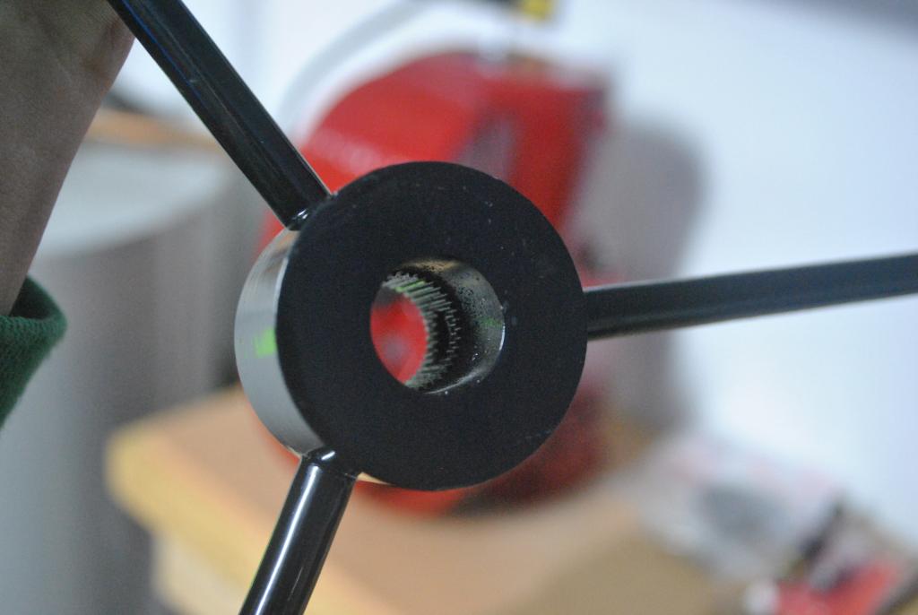

Horse Play 393 #80 Posted January 3, 2020 Sorry for the late response... working night shift and remodeling the kitchen/living room for the wife. Yes, it is the same Cub wheel as posted above. The Cub hub is 11/16" 40-spline on the top half. But the bottom-half of the hub is a plain 3/4" diameter. I am going to have a local machine shop drill out the splines to a 3/4" diameter and also drill a roll pin hole. 2 1 Share this post Link to post Share on other sites

Horse Play 393 #84 Posted April 21, 2020 It appears the machine shop did a goo job on drilling the Cub steering wheel. It cost me a total of $45; $20 for the drill bit and $25 for the drilling. I then did had to do a little sanding and scuffing, then resprayed the spokes and hub due to a few nicks at the machine shop. 2 1 Share this post Link to post Share on other sites

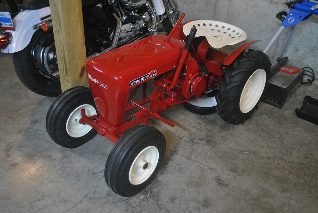

Horse Play 393 #87 Posted April 21, 2020 Only a few more small bits left to do. I still need to track down a belt guard and heat shield. 1 1 Share this post Link to post Share on other sites
