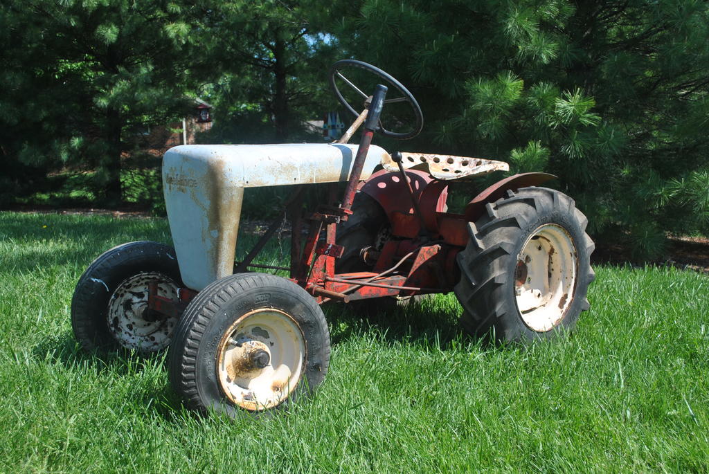

Horse Play 393 #1 Posted November 6, 2018 I bought a pretty rough RJ back in May for $250 and have been slowly and steadily been doing a shade tree restoration. Below is what I started with: 4 3 Share this post Link to post Share on other sites
WHX?? 58,324 #2 Posted November 6, 2018 Nice ...rattle can is my middle name...how far along with it? Looks like you got your work cut out! Nice tub too BTW 2 Share this post Link to post Share on other sites

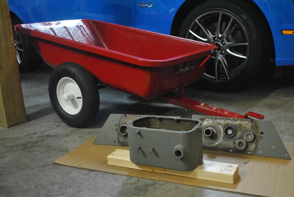

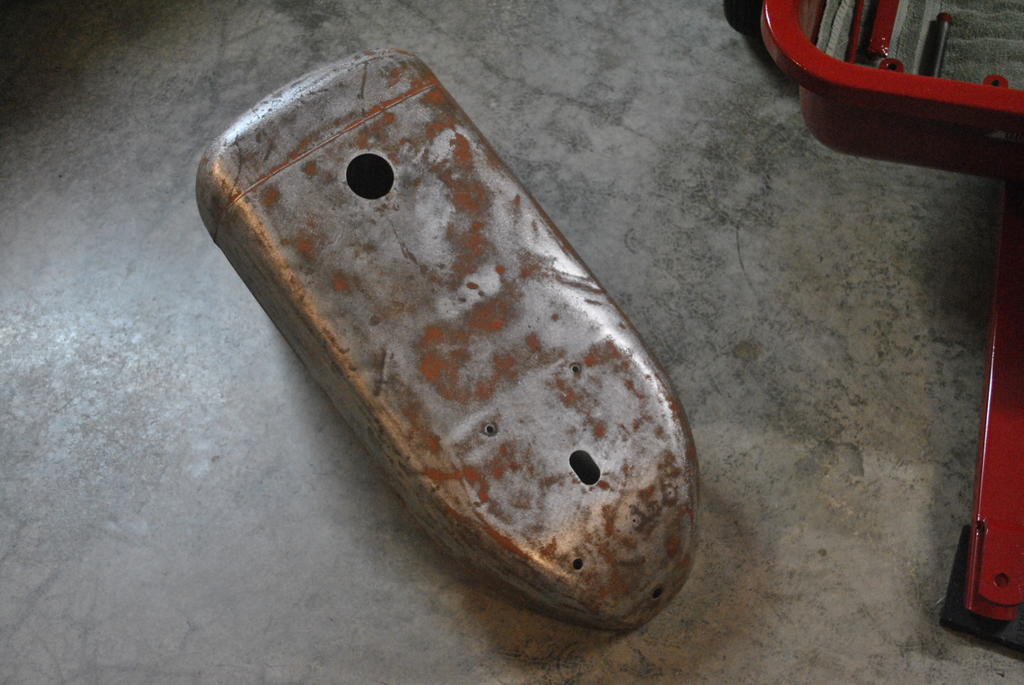

Horse Play 393 #3 Posted November 6, 2018 I'll keep the progress photos coming. The tub turned out pretty good for how bad it was and then just being spray painted. 7 2 Share this post Link to post Share on other sites
Daron1965 644 #4 Posted November 6, 2018 The trailer looks great. What paint are you using? 1 Share this post Link to post Share on other sites
Horse Play 393 #5 Posted November 6, 2018 I had to pull the transmission apart and did all new bearings and seals. Also had all the parts of the back of the trailer sandblasted and sprayed with etching primer. A forum member helped me out with a nice hood. Recently a friend filled the extra holes and fixed the cracks. 5 3 Share this post Link to post Share on other sites
Horse Play 393 #6 Posted November 6, 2018 5 minutes ago, Daron1965 said: The trailer looks great. What paint are you using? Rustoleum IH red. 1 Share this post Link to post Share on other sites

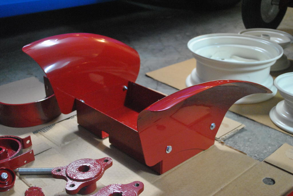

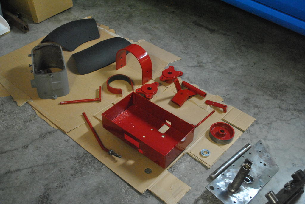

Horse Play 393 #7 Posted November 6, 2018 First batch of red paint. I scuff the etching primer with a grey scuff pad, degrease, and spray paint out in the driveway. Two light coats then a third, heavier coat of red. 9 3 Share this post Link to post Share on other sites

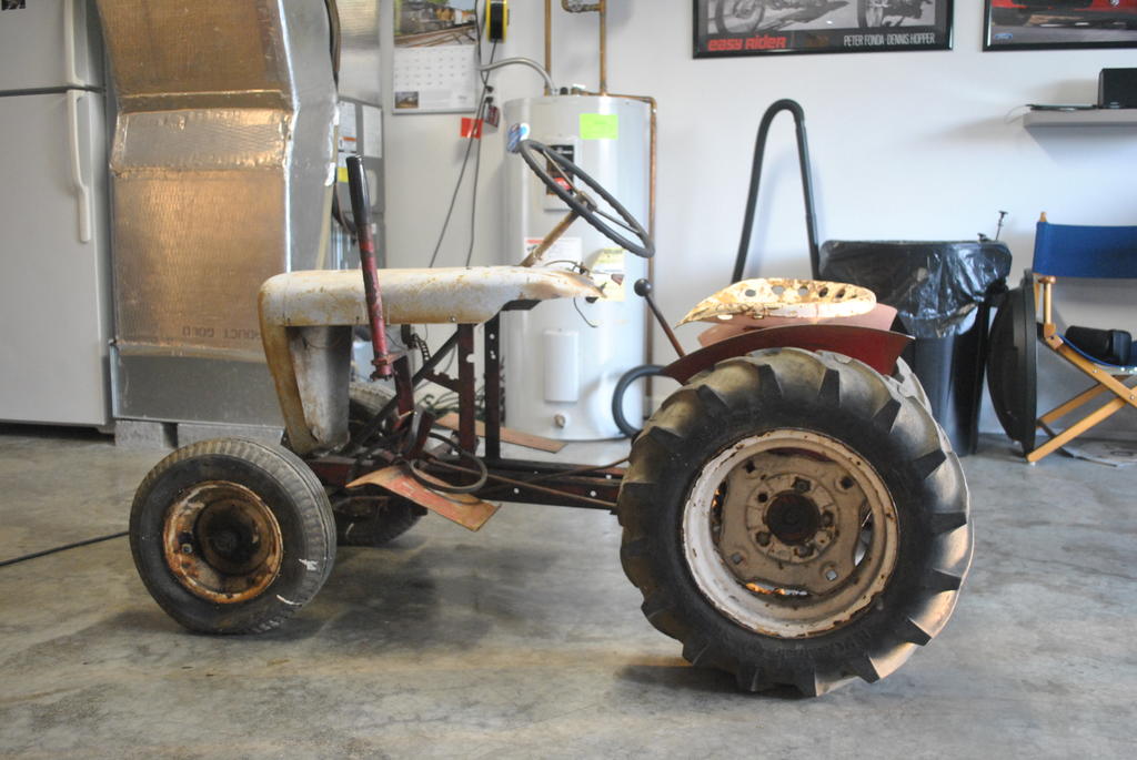

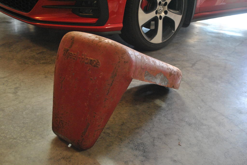

wallfish 20,724 #10 Posted November 7, 2018 NICE! I'm interested in that hacked up hood for a custom project if you want to sell it. For the Kill switch just search epay for a chainsaw switch. It's a single pole to ground switch. Original ones were the same switch as the old Homelites used 1 Share this post Link to post Share on other sites
Horse Play 393 #11 Posted November 7, 2018 21 hours ago, wallfish said: NICE! I'm interested in that hacked up hood for a custom project if you want to sell it. For the Kill switch just search epay for a chainsaw switch. It's a single pole to ground switch. Original ones were the same switch as the old Homelites used I possibly could sell it, but it is in rough shape. Share this post Link to post Share on other sites

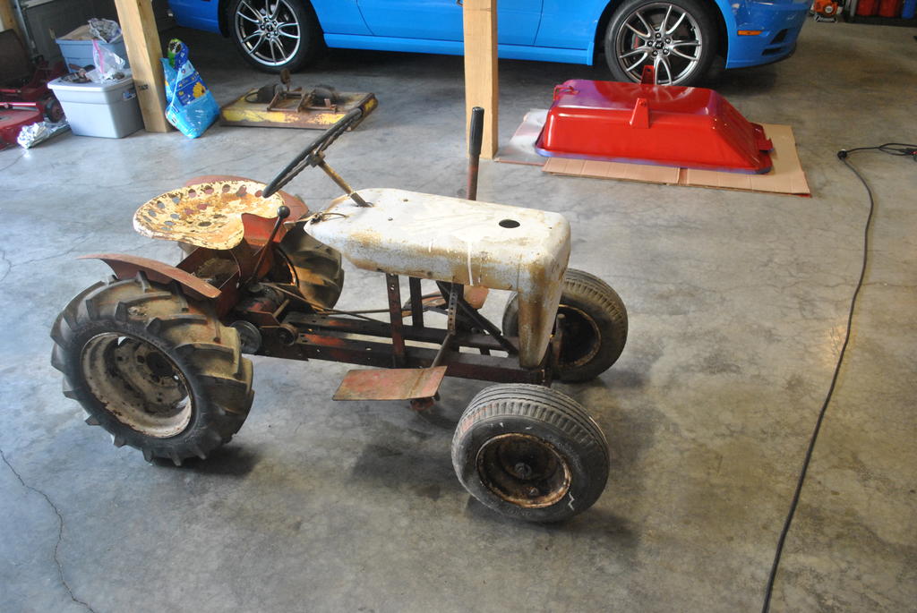

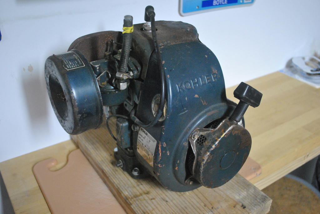

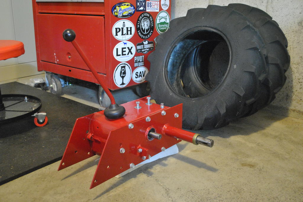

Horse Play 393 #12 Posted November 8, 2018 A sorta local forum member helped me out with this K91. I bought it without knowing if it ran or not. I dumped in fresh oil and gas - she fired up on five pulls and runs great. Transmission reassembled with new bearing and seals. 4 4 Share this post Link to post Share on other sites

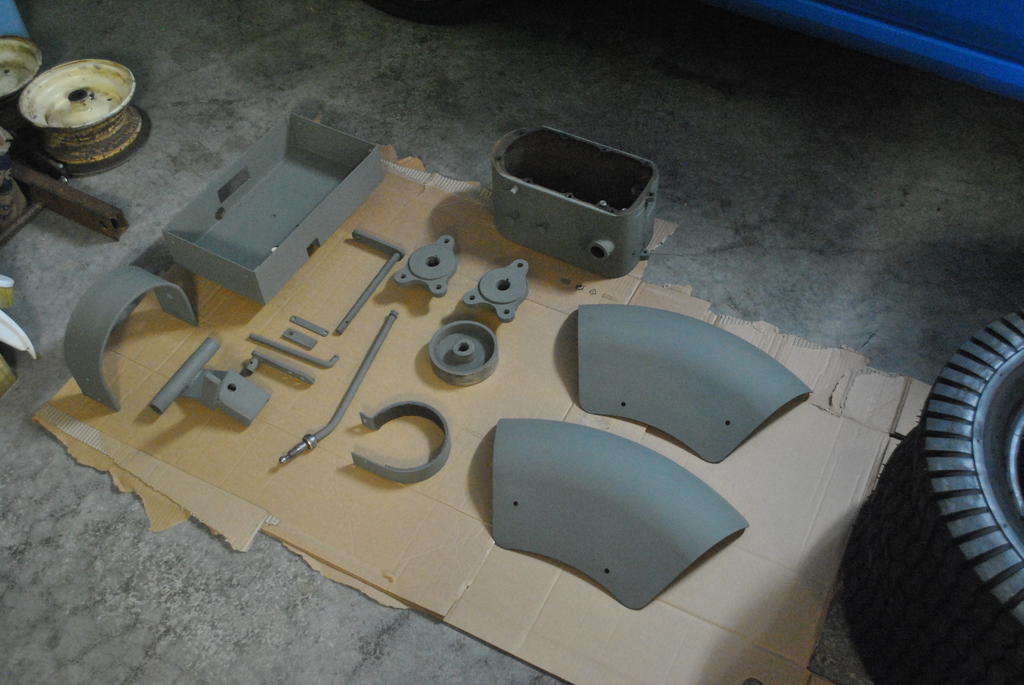

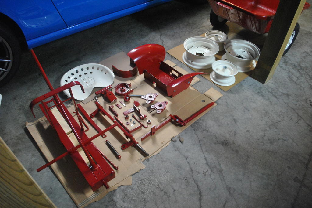

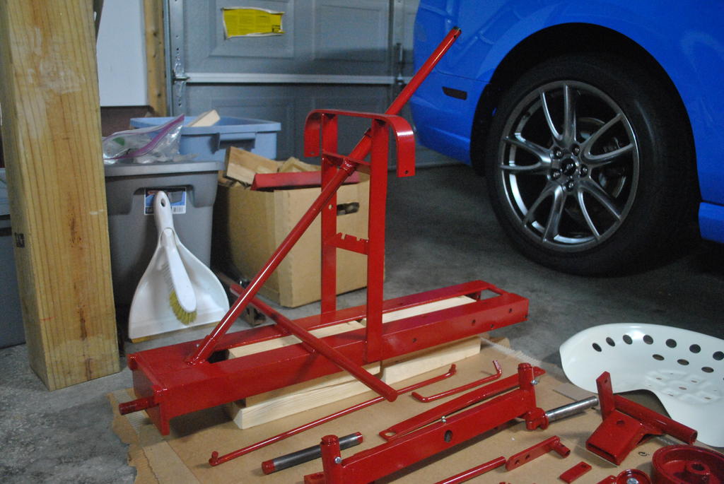

Horse Play 393 #13 Posted November 8, 2018 Here is where I currently am with the project. We had our first child three months ago, so the project has really slowed down. So over the summer I did a lot of painting so the paint could harden really well before assembly. - Parts sandblasted - Quick run over everything with a DA with 80 grit. - Cleaned and degreased - Sprayed with etching primer. - Scuffed with a grey 3M scuff pad - Cleaned and degreased - Two light coats of red followed by a third, heavier coat 7 4 1 Share this post Link to post Share on other sites

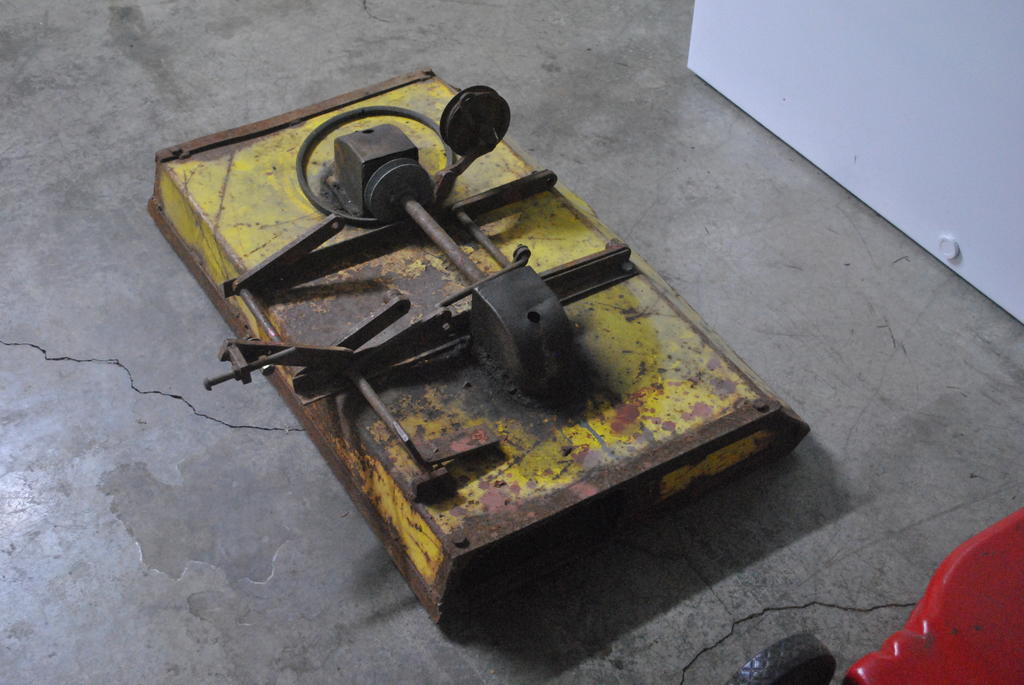

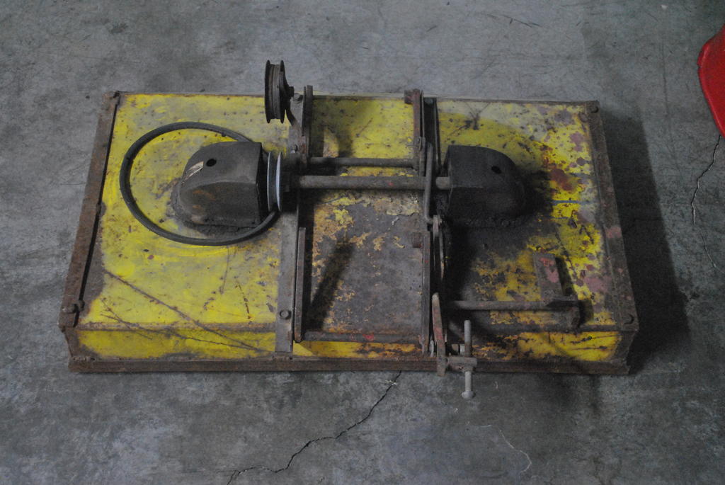

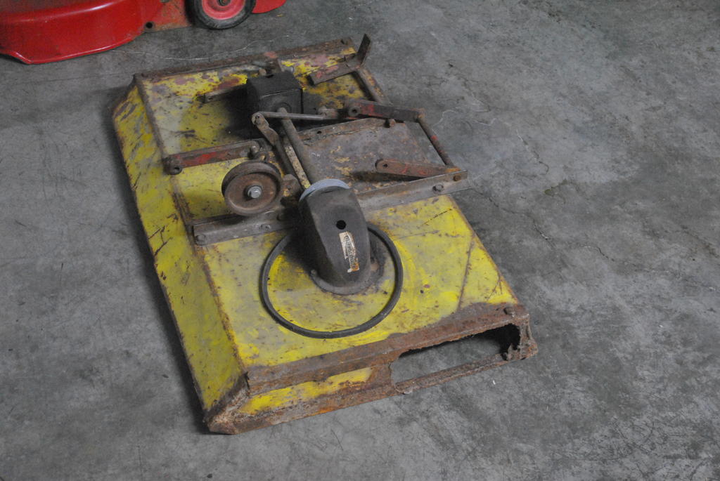

Horse Play 393 #16 Posted November 17, 2018 Here's some pics of the mower deck that came with the tractor. Ever see a deck shell like this? 1 Share this post Link to post Share on other sites

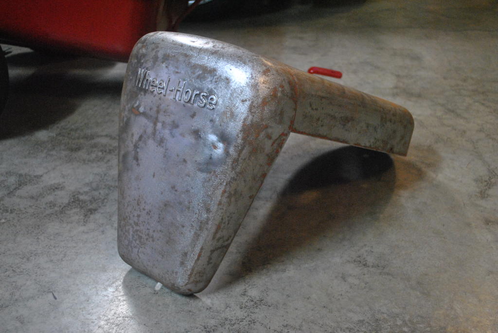

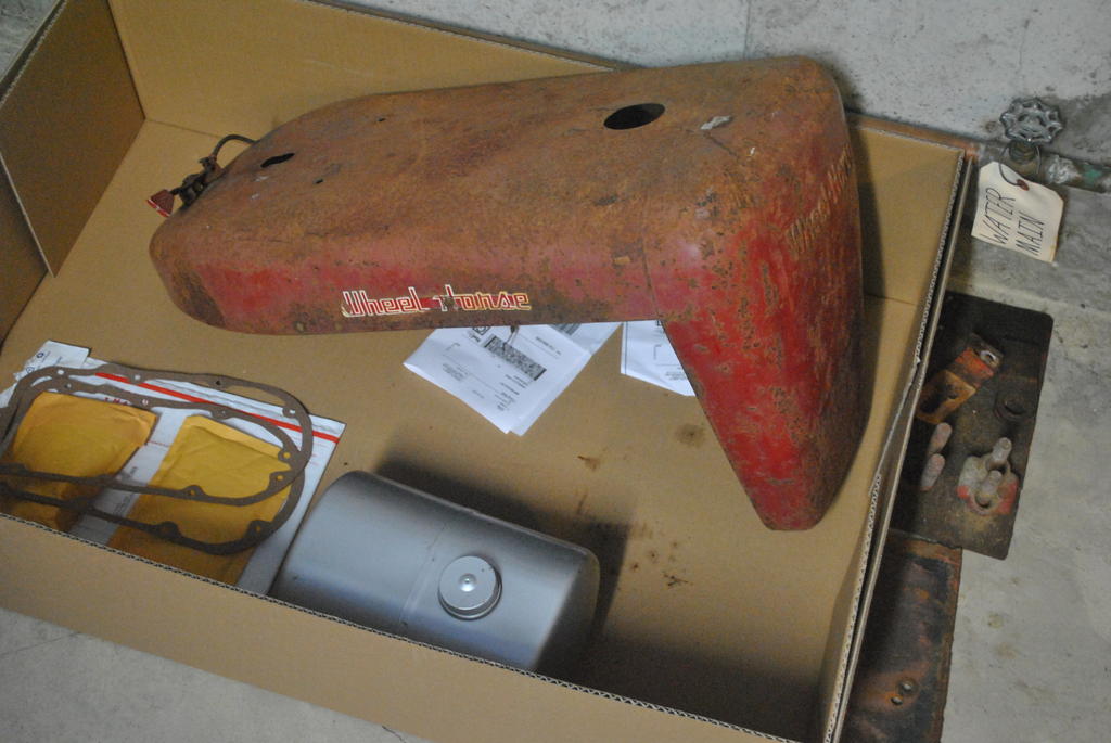

Horse Play 393 #17 Posted January 10, 2019 My friend did some great work on the hood. He filled in seven "extra" holes and fixed a few cracks. I then used a DA with 40 grit and a wire brush on the lettering - I need to find something not too aggressive to clean up the rest. 5 1 Share this post Link to post Share on other sites
AMC RULES 37,260 #18 Posted January 10, 2019 Wire wheel would make short work of it. Share this post Link to post Share on other sites

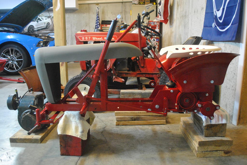

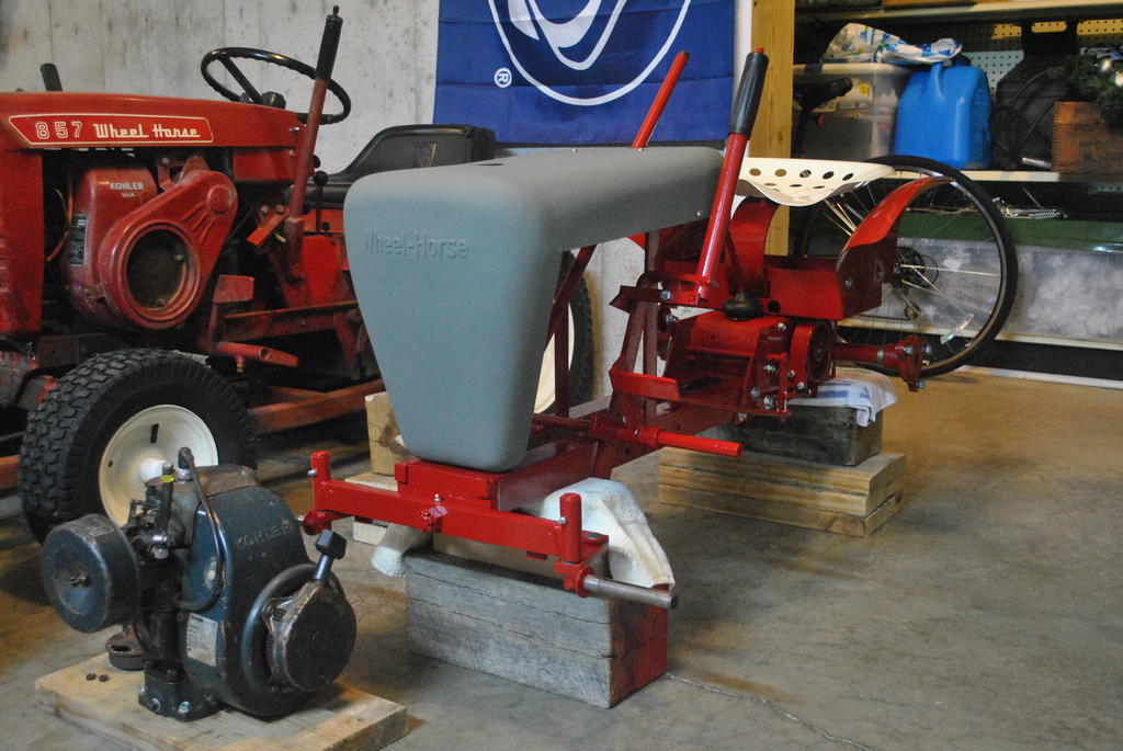

Horse Play 393 #19 Posted February 18, 2019 Assembly has begun. 6 6 Share this post Link to post Share on other sites
Horse Play 393 #20 Posted June 7, 2019 Can anyone recommend an epoxy for the tank straps to the underside of the hood? Share this post Link to post Share on other sites
953 nut 70,064 #21 Posted June 7, 2019 9 hours ago, Horse Play said: Can anyone recommend an epoxy for the tank straps to the underside of the hood? With the vibration the hood will be experiencing and the weight of the gas sloshing back and forth the only thing I would trust is having the tank straps welded on. Share this post Link to post Share on other sites
bottjernat1 2,197 #22 Posted June 7, 2019 Mine i had wider straps welded on. Such a great machine. Yours is looking Good! Share this post Link to post Share on other sites

Wheelhorse Wes 279 #25 Posted June 8, 2019 That is absolutely beautiful RJ. Rattle can works amazing if your patient, by the looks of er you are a good painter. Two thumbs way way up sir....by the way use “redo your horse.com” for your decals he’s a member on here . I use his decals and they are amazing Share this post Link to post Share on other sites
