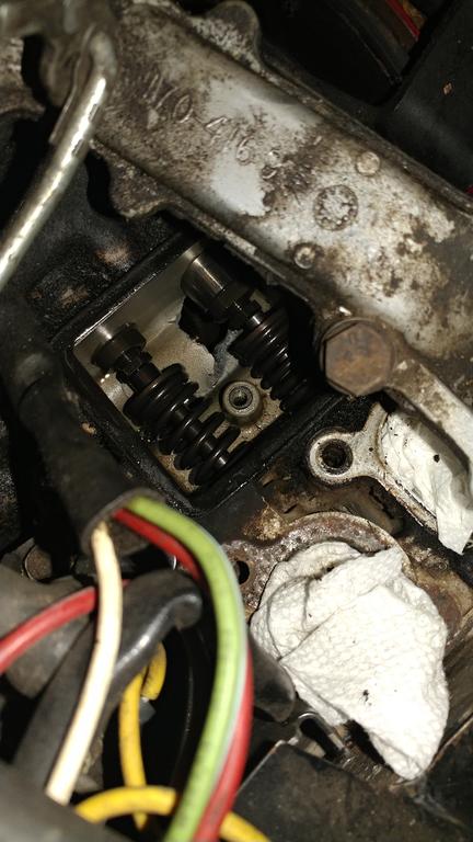

1990Onan520-H 15 #10 Posted January 19, 2019 On 11/5/2018 at 8:47 PM, ericj said: pull the motors and pull the heads, you won't know what you got till you do. I have had several valve seats repaired / replaced at the local NAPA machine shop for about $ 100.00. So relax you may not be totally into deep yet. My bet would be that the 90 lost a rod and the 91 has valve issues. It could be valves just out of adjustment. If your 9 pins are still in tack and not burnt, you can swap motors fairly easy. good luck eric j Well finally did some digging. Looks like you're right about the 90 unfortunately. Pulled the valve cover and there's a hole right through the block and the intake valve is jammed open. Crank journal looks pretty scored up too. Is this common with only 845 hours on this machine to throw a rod? Did rods get upgraded in later years? I remember reading something about upgraded replacement rods somewhere. Share this post Link to post Share on other sites
ericj 1,576 #11 Posted January 20, 2019 don't think I've ever seen one blown like that, 7 minutes ago, 1990Onan520-H said: Is this common with only 845 hours on this machine to throw a rod? if the PO didn't do the maintenance on the unit then that's what happens. I worked on a I believe a 93 with only a little over 300 hrs on that threw a rod and cracked the top of the block under the intake and exhaust manifolds. eric j Share this post Link to post Share on other sites
1990Onan520-H 15 #12 Posted January 20, 2019 2 minutes ago, ericj said: don't think I've ever seen one blown like that, if the PO didn't do the maintenance on the unit then that's what happens. I worked on a I believe a 93 with only a little over 300 hrs on that threw a rod and cracked the top of the block under the intake and exhaust manifolds. eric j Any idea about upgraded rods on later years? I was thinking of putting my 91's engine in the 90 because the 90 is in much nicer shape but with how beat up the 91 is I'm not sure it's worth it especially since the 91 could chuck a rod too at any time it seems. Share this post Link to post Share on other sites
ericj 1,576 #13 Posted January 20, 2019 I think the difference came between 89 and 90 in the rods. maybe do some checking on onan parts.com. Might be able to tell a year from the difference in part numbers. Does the 91 knock or make any noise, pull the engine tins and clean the cooling fins. Did you check to see if the valve seat is out or not, or where you were loosing compression ? eric j Share this post Link to post Share on other sites
1990Onan520-H 15 #14 Posted January 20, 2019 2 minutes ago, ericj said: I think the difference came between 89 and 90 in the rods. maybe do some checking on onan parts.com. Might be able to tell a year from the difference in part numbers. Does the 91 knock or make any noise, pull the engine tins and clean the cooling fins. Did you check to see if the valve seat is out or not, or where you were loosing compression ? eric j Haven't gotten a chance to check out the 91 yet, but I don't think the engine knocks. There is a knocking noise on occasion, but it sounds like it's more from the seat area above the hydro. Then again I guess sound travels. The 91 was parked because it will only run for 30 seconds or so Then die, but maybe it was in rough shape before that, im not sure. Share this post Link to post Share on other sites
ericj 1,576 #15 Posted January 20, 2019 1 hour ago, 1990Onan520-H said: Haven't gotten a chance to check out the 91 yet, but I don't think the engine knocks. There is a knocking noise on occasion, but it sounds like it's more from the seat area above the hydro. Then again I guess sound travels. The 91 was parked because it will only run for 30 seconds or so Then die, but maybe it was in rough shape before that, im not sure with the 90 motor in bad shape you can use what ever parts from it that you need to get the 91 running. get the motor running then take the best parts from both tractors and and make one good tractor. use the best sheet metal the best frame and so on. good luck eric j 1 Share this post Link to post Share on other sites
