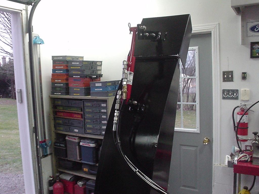

WHMan2012 180 #27 Posted January 16, 2019 It Was More Of A Project Than I expected, But I wouldn't Have Been Able To Do This Without Everyone's Help On This Site, You Guys Are Truly Amazing. Seeing These Blowers In Action On You Tube, I knew I needed To Get Me One, Didn't Know I would Have To Bring One Back From The Dead, But That Just Seems To Make It That Much Better. Now I'm Looking For Another To Rebuild For A Spare. I Do Have A Quick Question Though. The Lift Assist Springs, Are They The Same ? The Parts Diagram Has Them Listed As Separate Numbers So I'm Not Sure What Goes Up Under The Tractor. WHX21, Yours Looks Like The One I Currently Have Mounted Out Front. Do I have That One Wrong ? I Bought My Idler Sprocket Today At TSC It's A #40 / 17 Tooth, I Heard It's A Little Big, But Figured I'd Try It Anyways. Thanks Again For The Help And Support. 1 Share this post Link to post Share on other sites

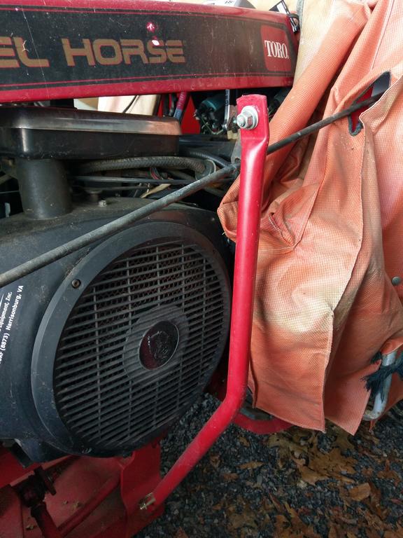

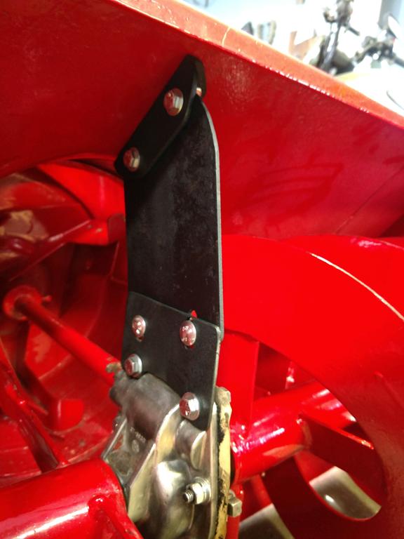

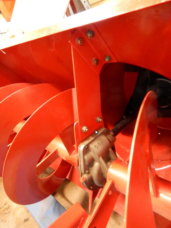

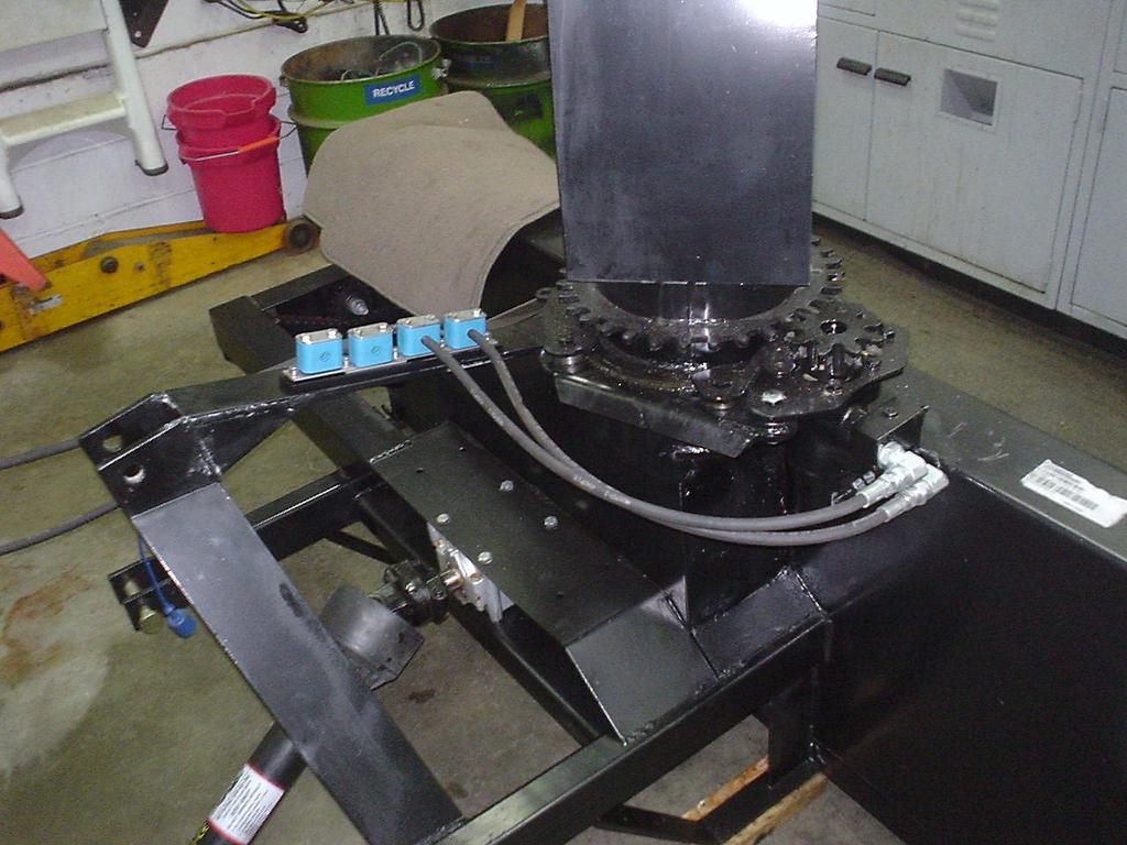

WHMan2012 180 #28 Posted January 16, 2019 I Installed My Center Brace Today, Don't Remember Who's Idea This Was, But Thank You For Posting Pictures. I was Thinking The Same Thing, That's Pretty Wide Without A Brace To Help Hold All The Torque. Here's A Few More Pictures Taking Today After The New Install. Tomorrow I'll Finish The Scraper Blade And Skid Shoes Install, Then Onto The Idler Sprocket Install On Thursday. 1 2 Share this post Link to post Share on other sites

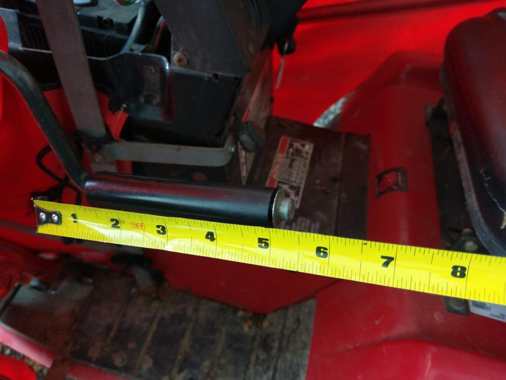

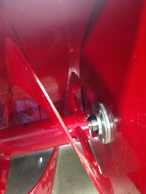

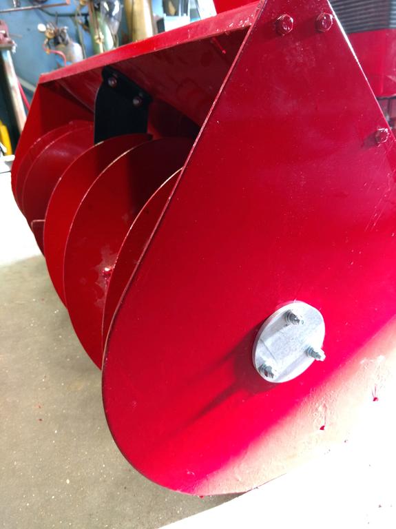

WHX?? 58,302 #29 Posted January 16, 2019 8 hours ago, WHMan2012 said: Installed My Center Brace Today, Don't Remember Who's Idea This Was It was @Kurt-NEPA 's I believe . How did you make those nice spacers/cover for the auger bearing upgrade?.... that's next on my to do list. Also if someone could give the dims on the chute crank support I would appreciate it. I'm thinking a piece of conduit will work as I also need to fab that and the crank itself. Eventually I will motorize it but for now manual inside the cab turn. Share this post Link to post Share on other sites
Kurt-NEPA 756 #30 Posted January 16, 2019 (edited) 3 hours ago, WHX21 said: It was @Kurt-NEPA 's I believe . My Center Brace if this helps. Edited January 16, 2019 by Kurt-NEPA 1 Share this post Link to post Share on other sites
WHMan2012 180 #31 Posted January 17, 2019 Yes It Was You LOL And Thank You For Sharing That Photo. Mine's Not As Pretty, But Come Spring Time I'll Go Through And Fix / Replace Things To Make What Didn't Work Well This Winter, Hopefully Better Next Year. Got The Scraper Blade Mounted Along With The Skid Shoes. Tomorrow I'll Be Attaching The Two Components Together And Start Aligning The Idler Sprocket Up. If All Goes Well Hopefully Friday She'll Be Ready To Spin Over For The First Time In Several Years. As Far As The Question About The End Caps And Bearing Spacers, My Neighbor Down The Street Is An At Home Machinist, I Gave Him The Bearings I Had Ordered Off eBay And Told Him What I Needed Done. He Also Made Me A Brand New Auger Shaft, The Old One Had Broke At A Shear Pin Hole And For An Hour ( If That LOL ! ) And The Cost Of The Rod I think He Charged Me A $100. The Stock He Used Was $50 Alone. He Does Great Work. Also, He Made Me Stronger Steering Linkages As Mine Were Showing Their Age, Kinda Like The Owner. WHX21 Are You Currently Serving In The Navy ?? I Served From 1989 -1993 On The U.S.S. Nasville LPD -13. She's In The Moth Ball Fleet Now. Anyways Thank You For Your Service !! 1 Share this post Link to post Share on other sites

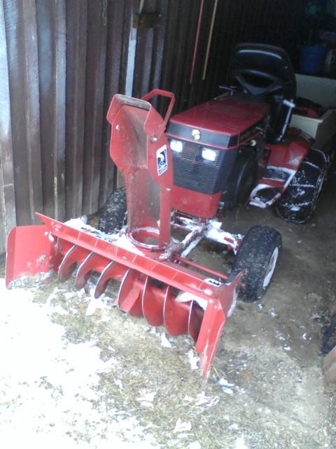

WHMan2012 180 #32 Posted January 18, 2019 I Had Just Enough Time After Finishing Up Putting The Chain And Covers On And Greasing / Oiling Everything Up To Spin Her Over Today And Stick It In A Snow Bank. Holy Crap Does This Thing Throw Even Further Than Anticipated And I Didn't Mount The Rubbers On The Auger Fins Yet LOL. Tomorrow They're Saying 1-3" 's, But They're Watching A Big One For Sunday. Tomorrow I Still Have Some Loose Ends To Tend To Like The Shute Control Rod, Putting The Rubbers On, Etc... I'll Post More Pictures Over The Weekend. Was Anyone Able To Get WHX21 His Shute Crank Support Measurements ? Share this post Link to post Share on other sites

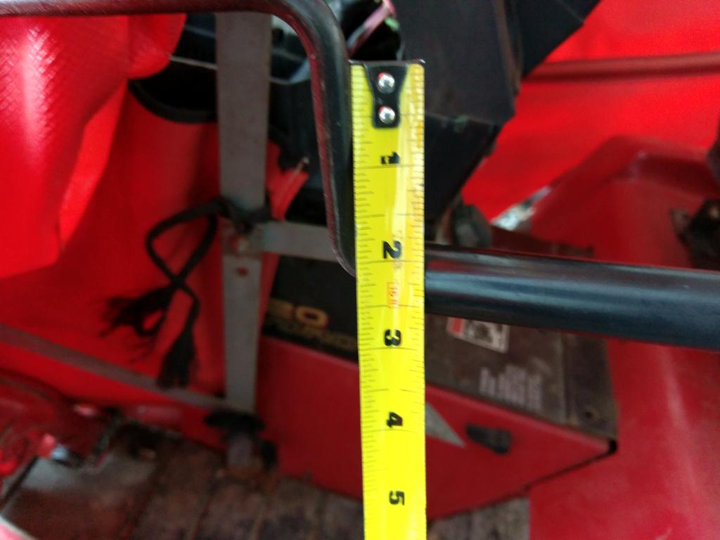

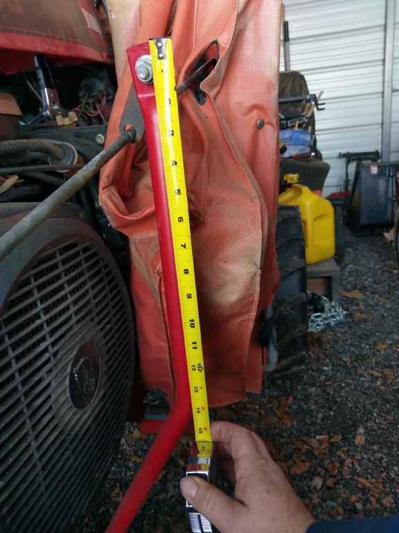

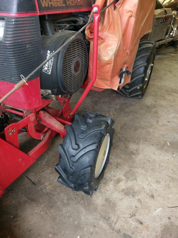

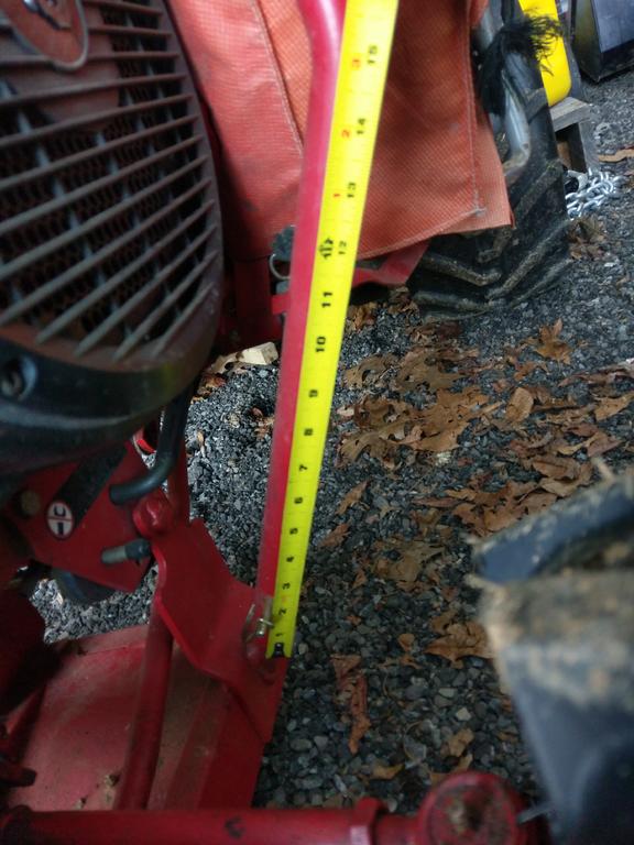

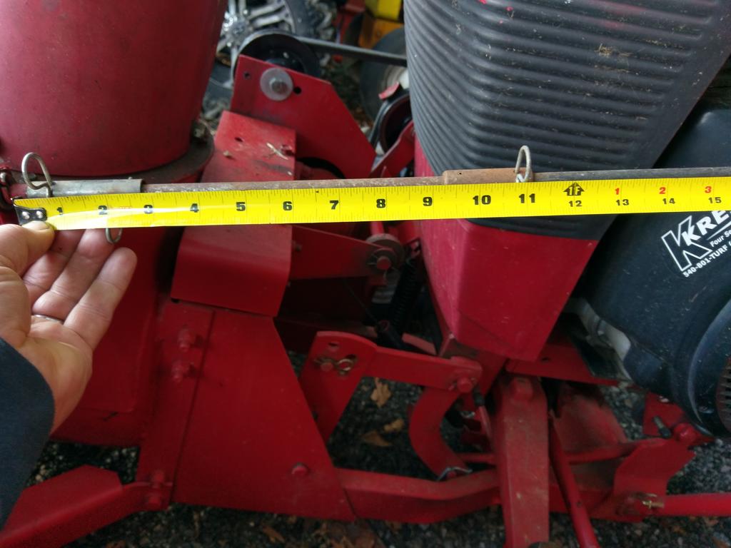

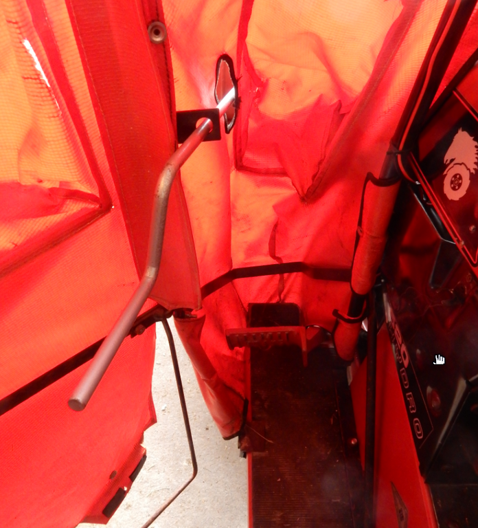

WVHillbilly520H 10,379 #34 Posted January 18, 2019 15 minutes ago, WHX21 said: No not yet could use just the overall length and the distance to that bend. Here you go Jimmy... 15" bottom to bend, lynch pin hole 1" from bottom ,14" from top to bend, rod hole 1" from top when bent correctly at 10" up you'll be about 2" from engine tin and 3" away at the vertical parallel area...the crank rod (is 36" to hand bend) it is the same as the tall chute single but I added an extension (10-12") to get inside cab...hope this gets you in the ball park I also made a little extension to lower the crank rod to make it more accessible turning in the older cab without the pocketed doors. 2 Share this post Link to post Share on other sites
Kurt-NEPA 756 #35 Posted January 18, 2019 41 minutes ago, WHX21 said: No not yet could use just the overall length and the distance to that bend. I hope somebody comes through with the dimensions. I am missing my crank support too. I have a cab so I use the support in the cab, but would like the support rod. Share this post Link to post Share on other sites
Kurt-NEPA 756 #36 Posted January 18, 2019 1 hour ago, WVHillbilly520H said: Here you go Jimmy... 15" bottom to bend, lynch pin hole 1" from bottom ,14" from top to bend, rod hole 1" from top when bent correctly at 10" up you'll be about 2" from engine tin and 3" away at the vertical parallel area...the crank rod (is 36" to hand bend) it is the same as the tall chute single but I added an extension (10-12") to get inside cab...hope this gets you in the ball park I also made a little extension to lower the crank rod to make it more accessible turning in the older cab without the pocketed doors. Thanks Jeff, just what I need. 1 Share this post Link to post Share on other sites
WHX?? 58,302 #37 Posted January 18, 2019 Thanks Jeff I have an extension made to have that crank right in my lap in the cab. I think it was a 12 incher but can bob it off if it gets too long. Going to get the tractor in the shop this weekend, pull the single off and start fitting up the carriage. Waiting on the gear box seals but luckily no snow in the forecast. In fact we have very little snow this season and very mild weather for this time of year. I'v also got the tall chute for back up.. but no cab! 20 minutes ago, Kurt-NEPA said: I use the support in the cab, What inside the cab is that Kurt? I did't know there was one on the inside? Or are you referring to a tab on the cab frame? If I remember right I only have a tab on the right side. Will have to check. With the single short chute the crank does not even come inside the cab and I have to reach through the zippered opening and even then the blower has to be lowered to reach . A real PITA! Never did care for the short cable turns. Don't think they were meant for use with a cab. 1 Share this post Link to post Share on other sites
Kurt-NEPA 756 #38 Posted January 18, 2019 12 minutes ago, WHX21 said: What inside the cab is that Kurt? I didn't know there was one on the inside? Or are you referring to a tab on the cab frame? Yes, I'm referring to the tab on the left side. 1 Share this post Link to post Share on other sites

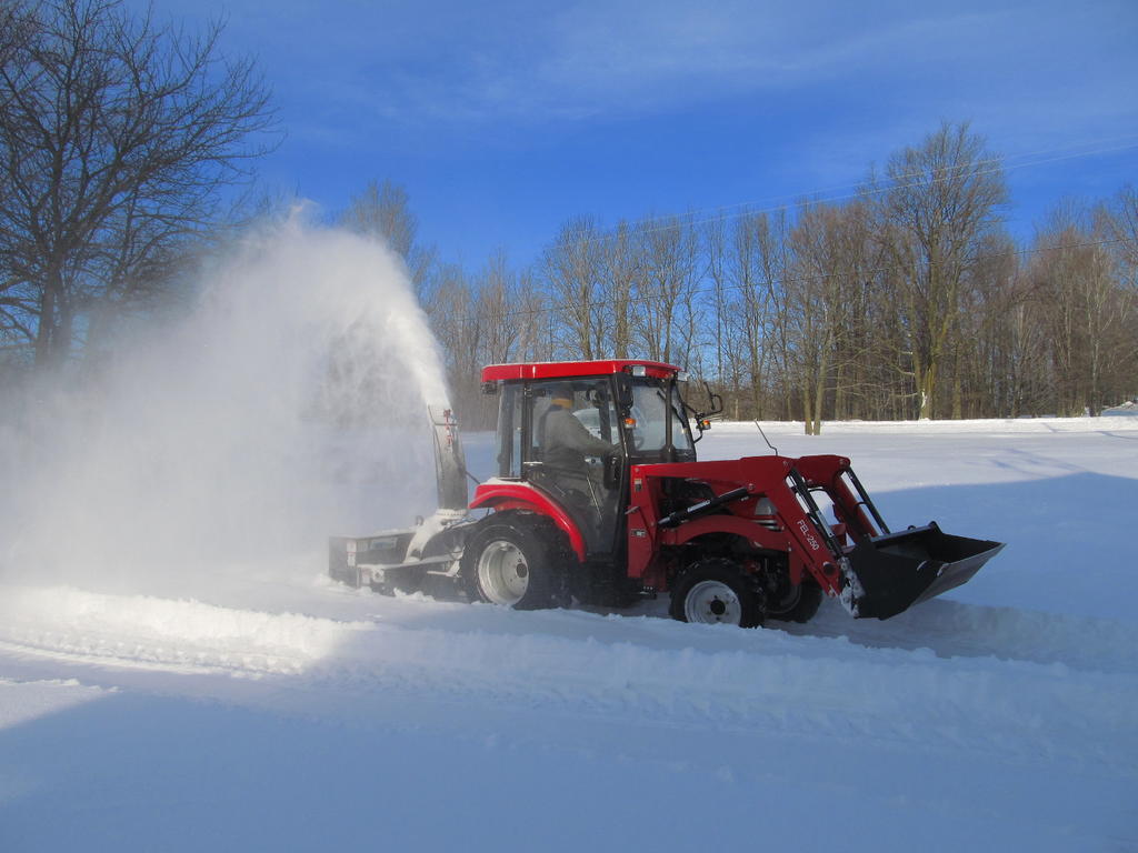

cleat 9,380 #39 Posted January 18, 2019 Tall shoot blower should work fine with a cab (just may need to lengthen rod a bit. My big tractor with it's cab has hydraulic rotation and deflection. Cleat 2 Share this post Link to post Share on other sites
WHMan2012 180 #40 Posted January 19, 2019 I Also Installed Grease Fittings On My Augers ( 2 On Each One ) And Filled Them Full Of Grease. Took About 1 1/2 Tubes Per Side. During Greasing Though Make Sure You Spin The Auger Over To Help Spread It Out On The Ends And Throughout. When I Pulled Mine Apart Originally, The Shaft Was All Rusted And Pitted From Water Getting In There. Hopefully This Will Help Keep Everything Lubed And Water Free. They're Saying 10" -18" By Tomorrow Night, Can't Wait. Still Got Some Little Things To Finish Up Today, Like Adding A Little More Rear Weight For One. Share this post Link to post Share on other sites

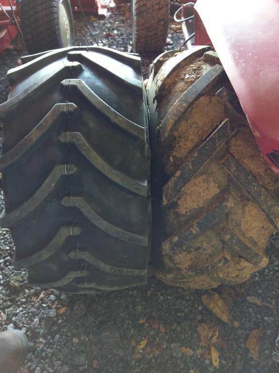

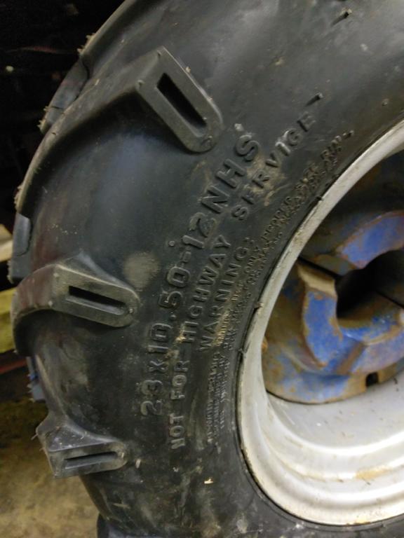

WHMan2012 180 #43 Posted January 21, 2019 Gotta Love Those Onans !!! I Love The Sound Of Mine While Snow Blowing, It Sounds So Mean Lol. Nice AG Tires, They Look Wider Than 10.50 Though In The Picture. Share this post Link to post Share on other sites
WHMan2012 180 #44 Posted January 21, 2019 Is That A 520H, HillBilly ? Share this post Link to post Share on other sites
WVHillbilly520H 10,379 #45 Posted January 21, 2019 5 hours ago, WHMan2012 said: Is That A 520H, HillBilly ? Yes. 6 hours ago, WHMan2012 said: Gotta Love Those Onans !!! I Love The Sound Of Mine While Snow Blowing, It Sounds So Mean Lol. Nice AG Tires, They Look Wider Than 10.50 Though In The Picture. Spot on, nothing quite like an Onan up on the governor chucking snow in the "dead" of winter, the cab does muffle it a bit but worth not wearing the snow like before I found the cab had a tall chute single for years would slice through 20+" no problem till I hit those DOT plow banks, as for width no definitely 10.50s on 8.5" wheels. Share this post Link to post Share on other sites

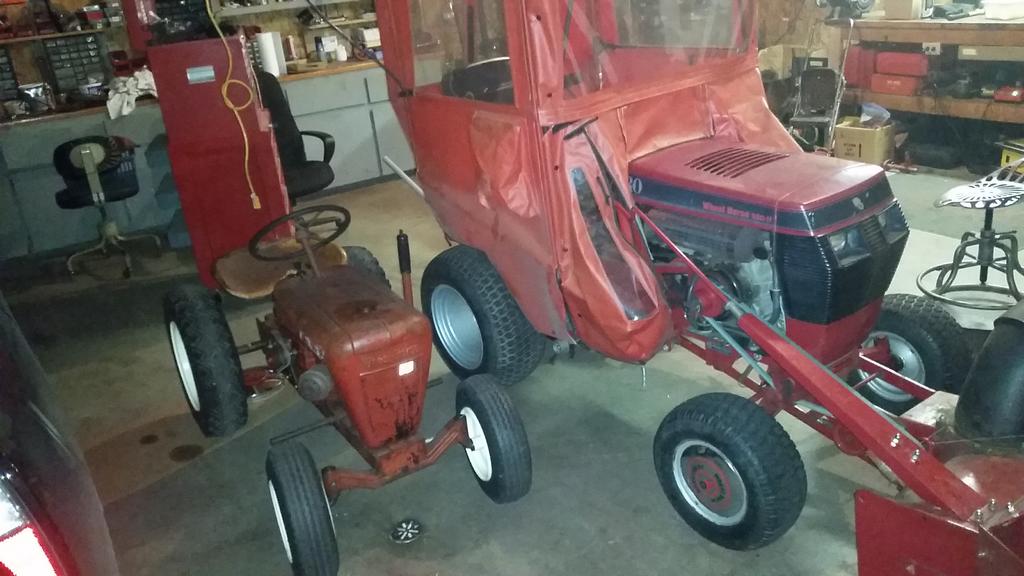

Kurt-NEPA 756 #46 Posted January 21, 2019 10 hours ago, WHMan2012 said: Gotta Love Those Onans !!! I Love The Sound Of Mine While Snow Blowing, It Sounds So Mean Lol. I agree, the flat head Onans just sound different. I love the sound. My 522xi with a 22hp Kohler V-Twin sounds so much more like a lawn mower. My 95 520H and two stage made short work of the 8 inches of heavy wet snow that we got yesterday. This was about as hard I have worked this beast and it came through perfectly. BTW, the rubber chains got the job done. 1 2 Share this post Link to post Share on other sites
