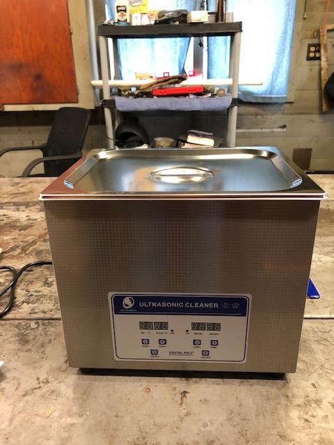

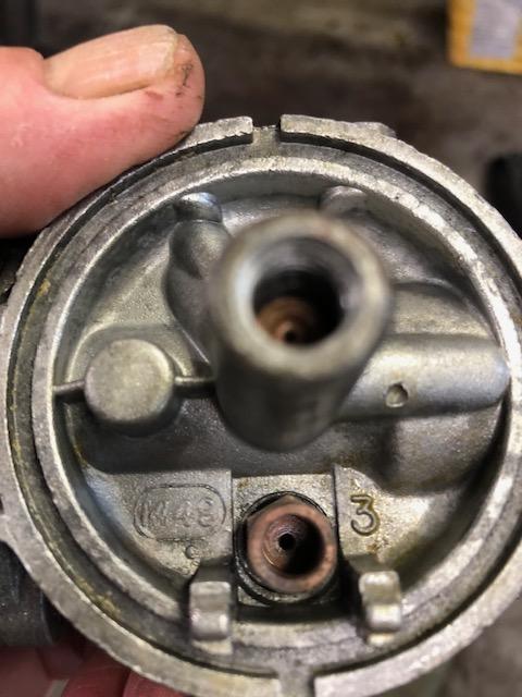

TimH 105 #9 Posted October 27, 2018 15 hours ago, ebinmaine said: If it's not to gummed up I prefer to try to rebuild the existing carburetor first. I think they are a better built and more precise instrument overall than the modern cheap Asian replacements. If your linkage is worn very much it may not be worth rebuilding the old one. You could try placing an ad in our want ad section or contacting Lincoln at a - z tractor. I broke down and set up a Cleaner I have had for a short time. Main jet and carb cleaned up really well. Choke and throttle shaft look ok. Float had hole in it I had to solder. Needle was stuck in closed position. Cleaned up well. Polished seat with Q-Tip in a drill with valve lapping compound. Just going to need a gasket set. Turns out Horse has been setting for ten years. Changed fuel lines , Cleaned tank with acetone and sealed with tank sealant. New filter. 3 Share this post Link to post Share on other sites

Mike'sHorseBarn 3,605 #11 Posted October 27, 2018 15 minutes ago, TimH said: I broke down and set up a Cleaner I have had for a short time. Main jet and carb cleaned up really well. Choke and throttle shaft look ok. Float had hole in it I had to solder. Needle was stuck in closed position. Cleaned up well. Polished seat with Q-Tip in a drill with valve lapping compound. Just going to need a gasket set. Turns out Horse has been setting for ten years. Changed fuel lines , Cleaned tank with acetone and sealed with tank sealant. New filter. An ultrasonic cleaner is on my Christmas list lol I've heard so many good things about them! Share this post Link to post Share on other sites

TimH 105 #13 Posted October 27, 2018 Found Gasket that was on a old Honda Scooter That worked. I love this new carb cleaner . IMG_0395.MOV 1 Share this post Link to post Share on other sites
pfrederi 20,895 #14 Posted October 27, 2018 3 hours ago, TimH said: I broke down and set up a Cleaner I have had for a short time. Main jet and carb cleaned up really well. Choke and throttle shaft look ok. Float had hole in it I had to solder. Needle was stuck in closed position. Cleaned up well. Polished seat with Q-Tip in a drill with valve lapping compound. Just going to need a gasket set. Turns out Horse has been setting for ten years. Changed fuel lines , Cleaned tank with acetone and sealed with tank sealant. New filter. Where did you get it??? Share this post Link to post Share on other sites
Achto 32,119 #15 Posted October 27, 2018 (edited) 3 hours ago, TimH said: Just going to need a gasket set. The gaskets, needle & seat are the same for K90 - K341. I always go with the OEM set, I've had better luck with them & they're not much different in price. Here's a link to a good source for them. http://www.psep.biz/store/kohler_carburetor_parts.htm Edited October 27, 2018 by Achto 3 Share this post Link to post Share on other sites
TimH 105 #16 Posted October 27, 2018 28 minutes ago, pfrederi said: Where did you get it??? Ebay https://www.ebay.com/itm/112295485571 2 gal 140 watt 1 1 Share this post Link to post Share on other sites
