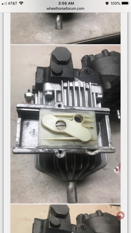

19richie66 17,822 #51 Posted October 29, 2018 (edited) https://www.wheelhorseforum.com/applications/core/interface/file/attachment.php?id=90962 Edited October 29, 2018 by 19richie66 Share this post Link to post Share on other sites
ZXT 2,401 #52 Posted October 30, 2018 (edited) Thanks for that photo! I came across it once when I first started working on it but couldn't find it in a manual again. I need to improve my searching skills. Does the pivot lever button simply adjust out against the plastic slide piece for friction? In order to get everything properly placed, I suppose I'll need to drill a new hole for the ball stud to the left of the current one. Thanks! EDIT: Thanks for the link to the manual! I didn't realize the thread had spilled over onto a new page. Edited October 30, 2018 by ZXT Share this post Link to post Share on other sites

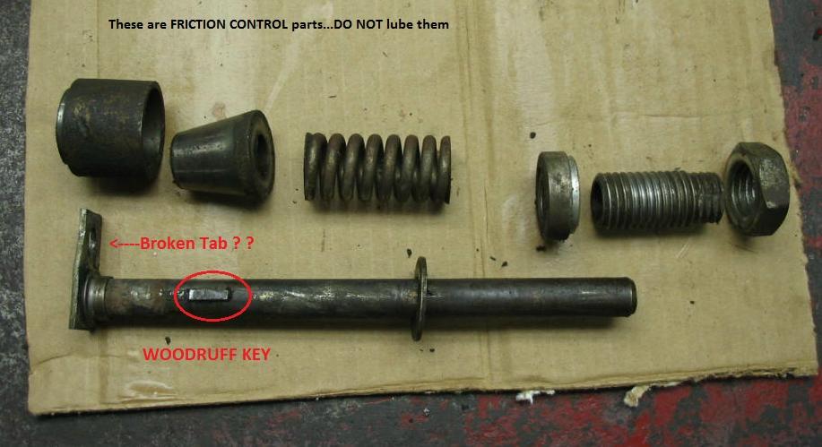

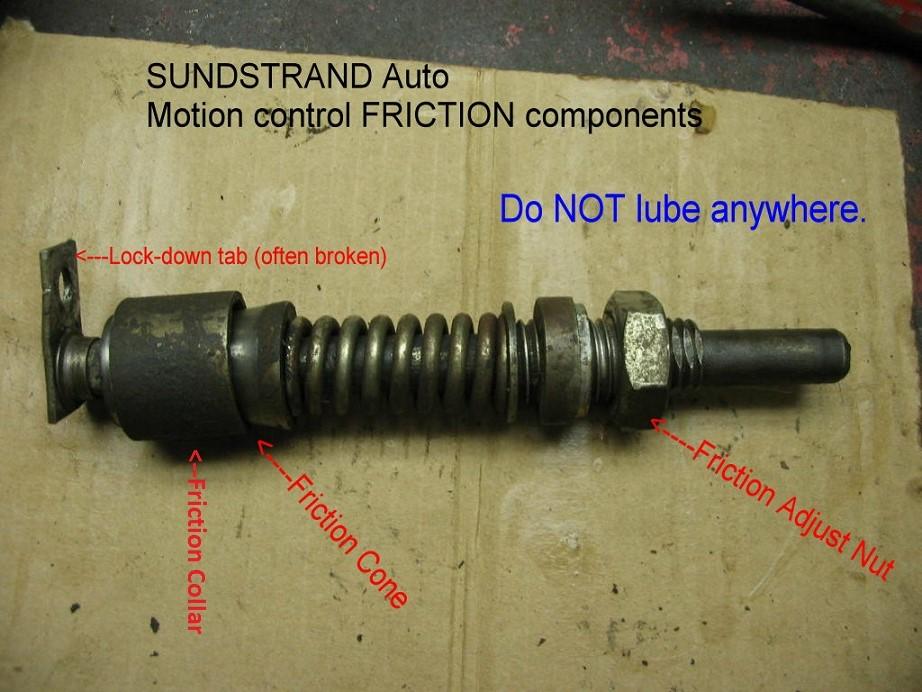

19richie66 17,822 #53 Posted October 30, 2018 The friction you speak of should be in the motion lever itself. It has a male/female cone that you tighten with the spring and jam nut. Page 10 of this “essential “ gt14 thread there are some good hydro shots. I have a photo somewhere of the lever assembly disassembled that I saw somewhere on here and saved but cannot find at the moment. 2 3 Share this post Link to post Share on other sites

19richie66 17,822 #56 Posted October 30, 2018 Here they are Jonah. I knew I had them somewhere. Hope this helps. 1 1 Share this post Link to post Share on other sites
Aldon 4,832 #57 Posted October 30, 2018 I will say that I have taken several of these GT14’s apart and in 80 percent of the cases I find that someone has been in there previously and left the woodruff key out. It it makes a difference but I was never able to get to get the friction as sticky as I would prefer. 2 Share this post Link to post Share on other sites
ztnoo 2,302 #58 Posted October 30, 2018 @19richie66, That looks like two of Dave Luzier's great descriptive pics. They are always super informative and instructional in detail. 1 Share this post Link to post Share on other sites
ZXT 2,401 #59 Posted October 31, 2018 Thanks for the pictures, guys! I drilled a hole in the shifter mechanism so that I could use the side hole in the slide cam, and now everything lines up and works good, with the exception of one thing. When I took it on its maiden voyage, I forgot and left the one of the retainers and screw for the slide cam on the tractor and they vibrated off. I can make on easily enough, but it's still aggravating. I also changed the pump input shaft seal and it no longer leaks like a sieve. Its coming together slowly but surely! 2 Share this post Link to post Share on other sites
swisstrac 49 #60 Posted November 2, 2018 Thank you Richie for the nice description and pics of the sundstrand motion control ' what a big help I was lubing the sh.. out of them to no avail. now if will rectify the problem/ 2 1 Share this post Link to post Share on other sites
