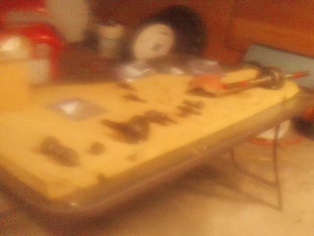

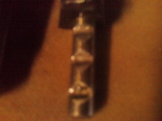

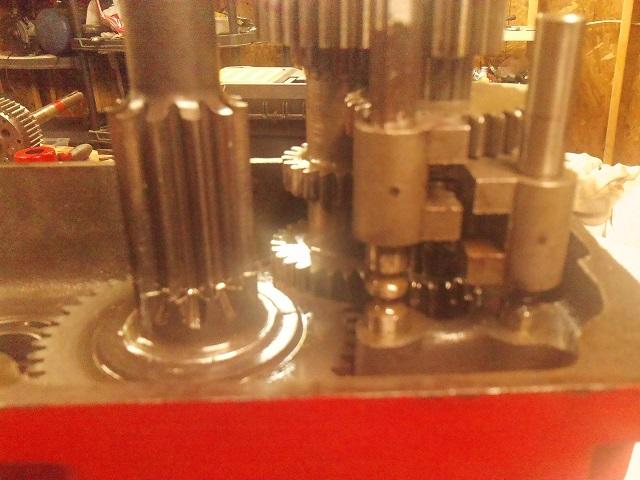

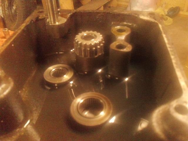

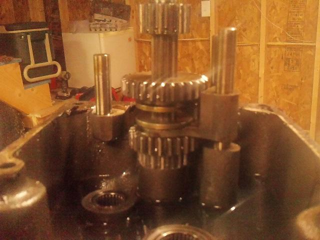

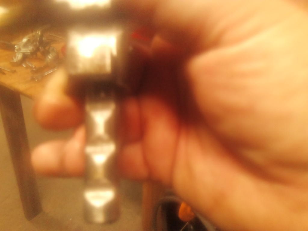

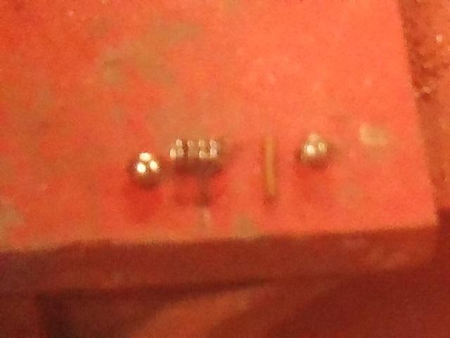

TravelinJavelin 621 #61 Posted November 10, 2018 well finally i got some time too to dig into this took the gears out today and the culprit is a combination of things ........the spring that holds the detent balls was broken the pin wasn't even close to what it was suppose to be then looked at one shift rail and was shaved down hard in the notches or i think anyways so there was alot of things going against this so thanks to ebin were going to correct now so here is some pics some are crappy i admit due to i think i had some gear oil on the lense when taking pics 3 Share this post Link to post Share on other sites
ebinmaine 79,465 #62 Posted November 10, 2018 Nice to see you've found a reason or two for the gear jam. Awesome job. 1 Share this post Link to post Share on other sites

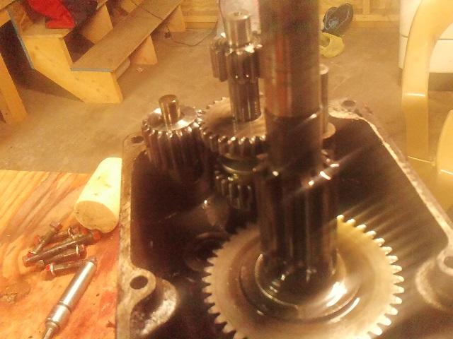

TravelinJavelin 621 #63 Posted November 11, 2018 ok after cleaning things up here i finally got the newer shift rails in and detent balls and spring and pin what a difference........now if anyone has ever watched steveasaurus 's video on putting the detent balls and the last shift rail in place ...he makes it look easy, it took me a good hour plus and finding the right tool to set the ball and setting in the rail but also had to switch ends on the spring and finally i got it ....had actually talked to steve on some tips today and had a great conversation and what a great asset he is to the red square forum now after i got things situated with the gears and all that stuff then took aprt the differential that was in mine and put in the other 4 pinions and got the sequenc of that done then comenced to put through the case and got it lined up and started turning stuff then noticed a binding well come to find out the heads of the bolts are to thick really so where it necks up on the shaft , now this the i think its called the 11/44 tooth gear the heads from the bull gear are just catching on the lip of the neck so i was wondering do they make a bolt like this with a thinner head? 2 1 Share this post Link to post Share on other sites

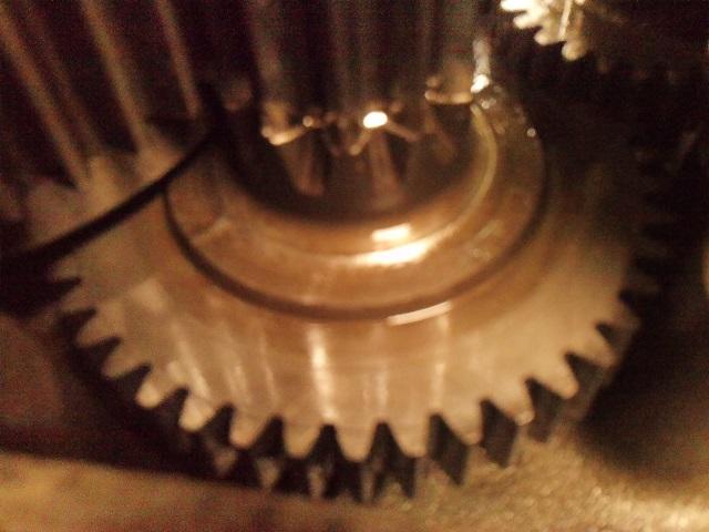

ebinmaine 79,465 #64 Posted November 12, 2018 1 hour ago, TravelinJavelin said: started turning stuff then noticed a binding well come to find out the heads of the bolts are to thick really so where it necks up on the shaft , now this the i think its called the 11/44 tooth gear the heads from the bull gear are just catching on the lip of the neck so i was wondering do they make a bolt like this with a thinner head? I'm not by any means claiming to be an expert on these Transmissions Did you double and triple check to make sure that the bolts are going the correct direction? If you need to change another gear or two, let me know. The transmission that I pulled those out of had a broken case but was operationally perfect. Steve was pretty awesome and helped me out a lot on the one I did for my honey's 657. Perhaps @stevasaurus could weigh in here? 1 Share this post Link to post Share on other sites

stevasaurus 23,733 #73 Posted November 12, 2018 Brandon, excellent talking with you yesterday. After looking at your pictures above, it sure looks like what we were talking about is correct. ie...you have the 11/44 toothed gear from the #5058 bevel gear differential transmission...and a differential from an 8 speed transmission. The 11 teeth from the mushroom gear should mesh with the bull gear no problem. You are going to have to make what you have work because your brake drum attaches on the shaft of the 11/44 gear. The 8 pinion differential transmissions use the cluster gear shaft for the brake drum. They also use a two piece mushroom gear setup. All that being said, the 1st thing to check is that the bearing under the larger part of the mushroom gear is flush with it's retainer in the case. The 2nd thing is to see if the bull gear teeth are hitting correctly on the width of the mushroom gear 11 teeth. A little grinding on the right edge of the bull gear teeth may be in order. The 3rd thing is the bolts holding the differential together. Sounds like yours are the 5/16-18 variety. (some of the 8 speeds used 3/8-16's. Since, your transmission is still a #5058, except for the differential, the bolts should enter the housing from the right side (input shaft side). I know you can get bolts with thinner heads...or grind them down to stop the grinding. Using the old bolts is not a problem, but you do want to use new Nyloc nuts. There should only be about 2 threads showing past the nuts. I would grind or hack saw them to length after tightening. That should take care of everything. Hope!!! 2 1 Share this post Link to post Share on other sites
TravelinJavelin 621 #74 Posted November 12, 2018 ok steve thank you yeah the ends of the bolts were torn a little too so i'll take my cut off tool and nip them a little......after i talked to you about binding well i wentback out and and put stuff back together again and this time worked great without any binding at all and like you said i think i had just enough slop it caused it to what it was doing but i think i'll just grind down on the bolts and go from there after that everything looks good and and will turn good i believe 1 Share this post Link to post Share on other sites
