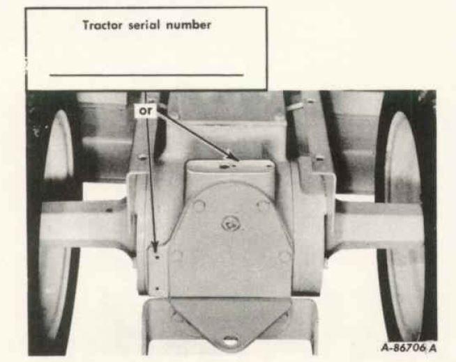

T-Mo-(Moderator) 4,790 #26 Posted October 20, 2018 Nice looking 123. The 123 came out in 1966 and was made through 1967 model year, so more than likely it's not a 1965. The 102 and 122 came out in 1965, but the 123 was a year later, probably due to it's being the first hydrostatic drive Cub Cadet. Build date might be 1965, but I don't have a break down of build dates for models, only serial numbers. If you can get the serial number, then we can determine build date. Here is where the serial number would be. Share this post Link to post Share on other sites

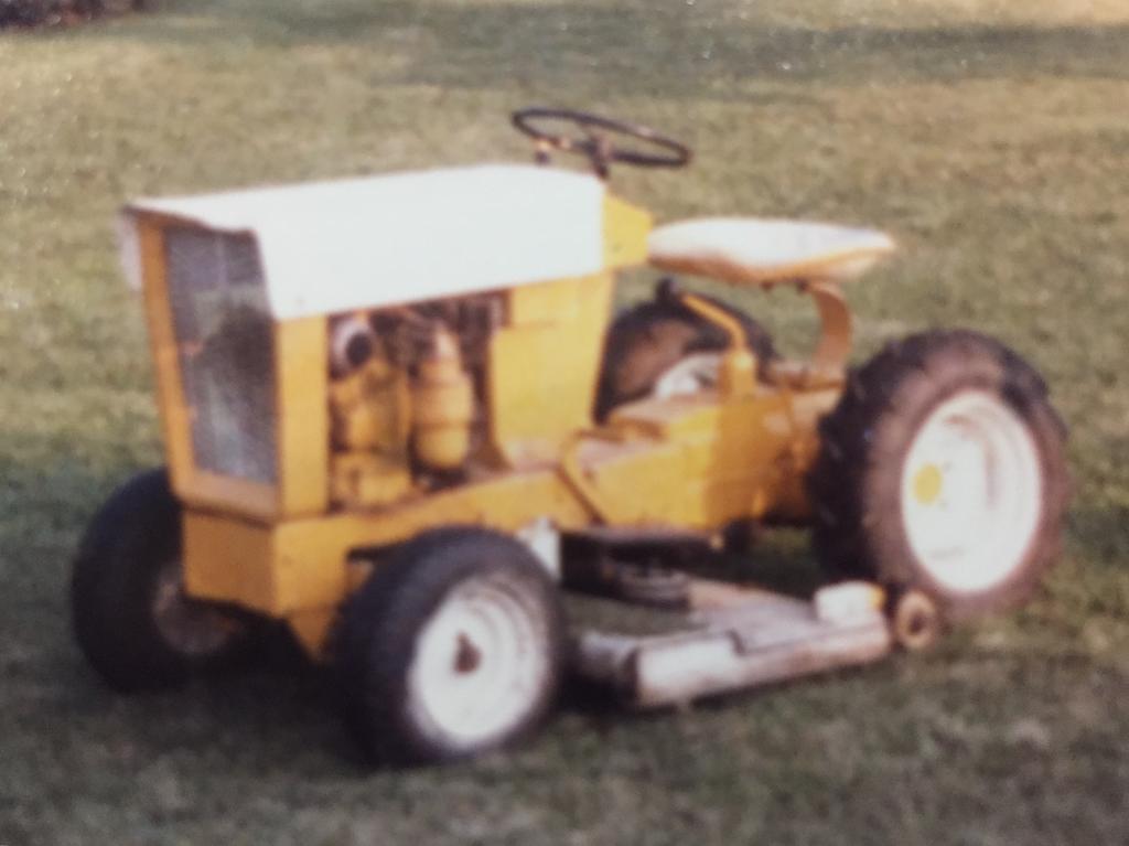

dclarke 4,117 #27 Posted October 20, 2018 I had this one back in the early 80s but not sure what model it was. Good luck with yours Terry. Share this post Link to post Share on other sites
T-Mo-(Moderator) 4,790 #28 Posted October 20, 2018 That would be the Original, the very first L&G tractor IH made, which would have been 1961, and they made this model until the 70 and 100 came out in 1963. They're very desirable and worth collecting, though I, myself, don't like the Original. IH's first attempt at a L&G model was the Original (though it was just called "Cub Cadet" by IH, the Original moniker is what collectors call them now). They wanted a drive shaft to the transmission, but since they had the frame angled down, it raised the engine a bit higher than the transmission, so they put a pulley on both the engine and the front of the drive shaft and ran a very small belt between the two. This configuration makes the Original sit lower to the ground, therefore a weird (to me) driving position. When IH came out with the 70 and 100 in 1963, they flipped the frame so the engine was inline with the transmission, therefore the eliminated the belt between the engine and drive shaft, and they now had a direct drive which is what they intended in the first place. BTW, if anyone has a Cub Cadet and needs manuals, register at Only Cub Cadets and they have a manual section: https://www.onlycubcadets.net/forum/index.php 1 Share this post Link to post Share on other sites
cschannuth 3,819 #29 Posted October 20, 2018 25 minutes ago, T-Mo said: That would be the Original, the very first L&G tractor IH made, which would have been 1961, and they made this model until the 70 and 100 came out in 1963. They're very desirable and worth collecting, though I, myself, don't like the Original. IH's first attempt at a L&G model was the Original (though it was just called "Cub Cadet" by IH, the Original moniker is what collectors call them now). They wanted a drive shaft to the transmission, but since they had the frame angled down, it raised the engine a bit higher than the transmission, so they put a pulley on both the engine and the front of the drive shaft and ran a very small belt between the two. This configuration makes the Original sit lower to the ground, therefore a weird (to me) driving position. When IH came out with the 70 and 100 in 1963, they flipped the frame so the engine was inline with the transmission, therefore the eliminated the belt between the engine and drive shaft, and they now had a direct drive which is what they intended in the first place. BTW, if anyone has a Cub Cadet and needs manuals, register at Only Cub Cadets and they have a manual section: https://www.onlycubcadets.net/forum/index.php Nice find. Did the the early 60's Cubs have rear fenders? I feel like I've seen round fenders on older models but maybe I'm dreaming that up. I love the Cubs btw. When I was a kid I mowed for an older couple that had a large hydro Cub. I thought I was pretty hot stuff driving that big (compared to me) tractor. Share this post Link to post Share on other sites
