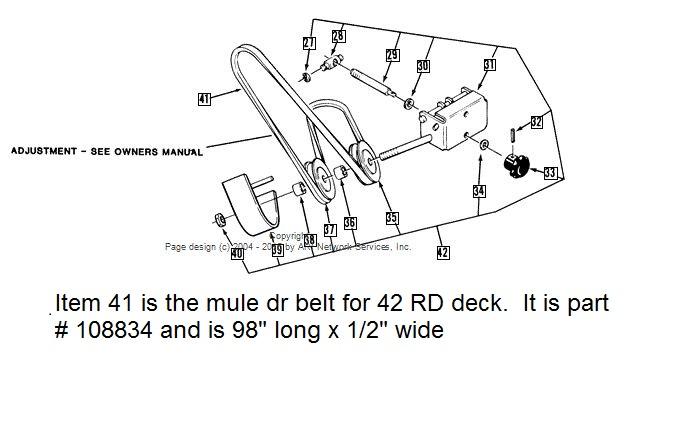

daveoman1966 3,884 #2 Posted October 17, 2018 If a 42" REAR discharge deck, the belt is # 108834. If it is 42 or 48 SIDE disch, the belt is # 102742 or 94-2501 (new # ). You should buy the OEM belt as aftermarket belts...IMHO....are inferior and make less than optimum geometric fit. 2 Share this post Link to post Share on other sites

daveoman1966 3,884 #7 Posted October 17, 2018 You need belt # 108834. One...only One. It runs from the engine PTO, out around the front axle, back under to the pulley, then loops back around the front axle, and to the PTO pulley again. It is item # 41 in this schematic ... Share this post Link to post Share on other sites

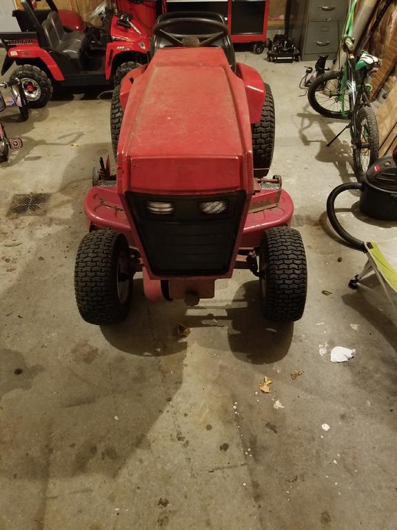

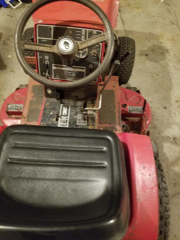

Tayloc31 2 #8 Posted October 17, 2018 Awesome thanks a lot. Here are a few pics. I paid 180 for it. 1 Share this post Link to post Share on other sites
oldblue1993 99 #9 Posted October 17, 2018 180 is a good price, the c145 is a great machine. I use mine for rototiller and heavy work, she handles it all in stride. Maintain her and in 40yrs see what that 180 got you. 1 Share this post Link to post Share on other sites
