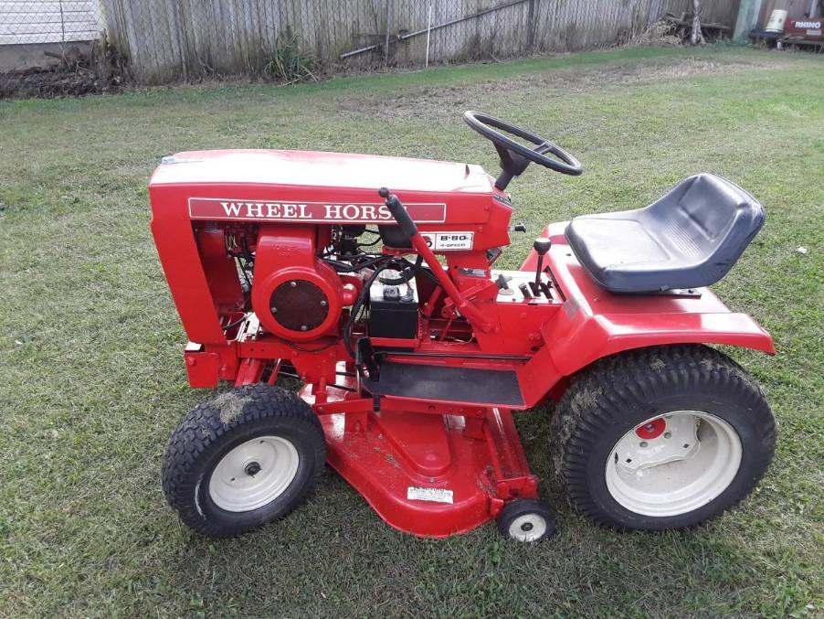

rick martin 65 #1 Posted October 14, 2018 hello everyone newbie here just wanted to say hello plus a couple questions. First off I'm a proud owner of a 1976 B100 8-speed and a 1975 B80 4-speed. fell in love with wheel horse tractors the first time I seen my neighbor plowing his driveway with a B100, by the way that B100 that my neighbor was using is now mine.The B80 has what I believe is a 36" rear discharge deck. Can anyone tell me what the deck model number is or where i can find it on the deck itself.I also have a k301 12hp kohler and was wondering if it would fit in the B80 without any mods. The B80 has recently started running kinda boggy and dies out. It don't matter if the pto is engaged or not. the choke adjustment has always been very sensitive but now its hard to keep running sometimes. Any suggestions were to start would be helpful. I was thinking maybe just trying to clean the carb first. thanks in advance 3 Share this post Link to post Share on other sites

rick martin 65 #12 Posted October 17, 2018 (edited) Good to see all you people are as crazy as me....ordered a carb rebuild kit already and I'll be tearing into the B80 aa soon as I get it. Never tried the seafoam deal but maybe I'll give it a shot. I've been using ethanol treatment that I use in my outboard but maybe seafoam is better. Here is my B80, B100 is in the middle of a rebuild and paint job. I'll post some B100 pics as soon as its complete. Edited October 17, 2018 by rick martin 1 Share this post Link to post Share on other sites
ebinmaine 80,600 #13 Posted October 17, 2018 41 minutes ago, rick martin said: Good to see all you people are as crazy as me.... I've been using ethanol treatment that I use in my outboard Nice tractor there!! Some of us may even be crazzee-err. Careful with the ethanol treatment. I was doing a little light reading a few weeks ago and there those that say it isn't all it's cracked up to be. I know it isn't available to everyone but I've switched over completely to non ethanol gas. Keep the cool pics coming !! Share this post Link to post Share on other sites
