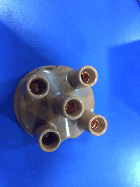

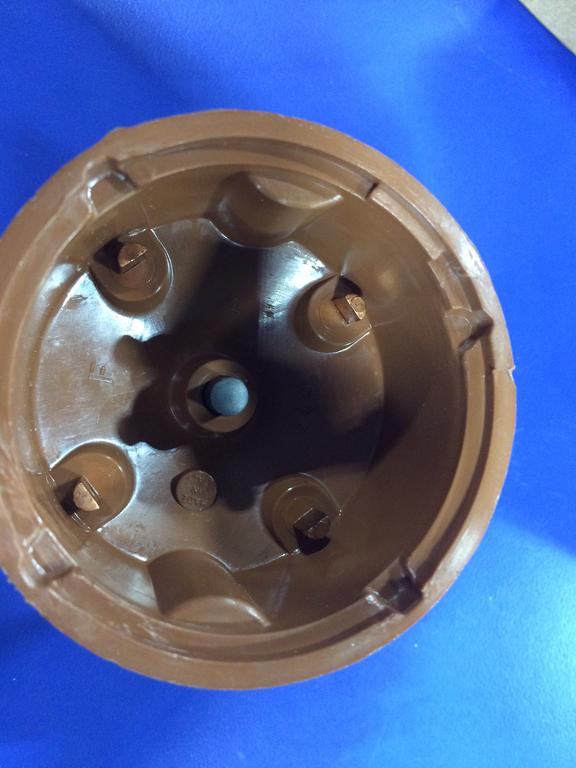

squonk 45,404 #5 Posted October 13, 2018 Do these look like what you need? Share this post Link to post Share on other sites
squonk 45,404 #6 Posted October 13, 2018 Got these #'s by looking back a ways. Don't know if they will fit your tractor. Pay close attention to the inside of the cap edge where it would fit on the distributor and the inside of the rotor where it would press onto the shaft. Take a look at these pics: Napa EP 163 Cap ; EP 173 rotor: 1 Share this post Link to post Share on other sites
