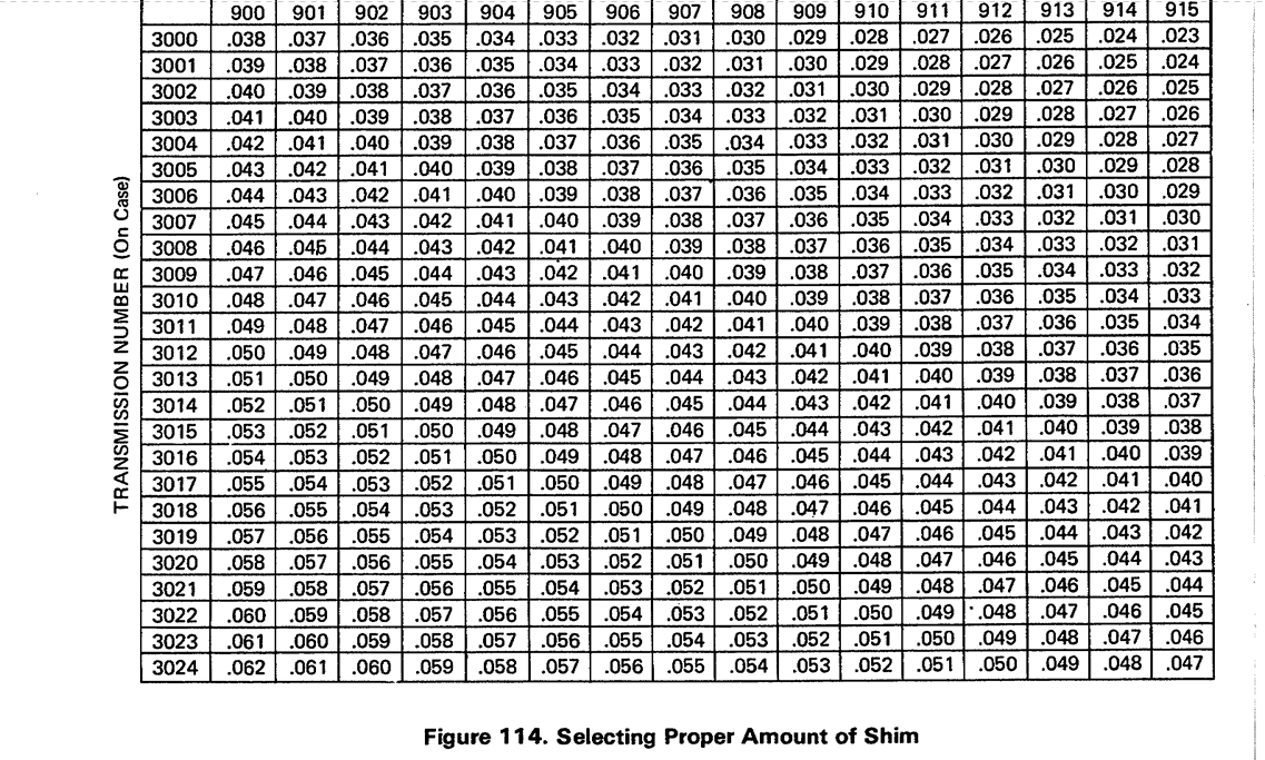

bc.gold 3,406 #8 Posted October 12, 2018 (edited) On the collar of the pinon housing there are some numbers stamped into the housing, in the repair manual is a chart that tells you by that number how many shims are required for the pinon gear. If you order your replacement bearing for the output shaft from a bearing supplier this bearing will have dust shields as shipped from the factory you'll have to remove them. The bearing as used by Simplicity allows hydraulic oil to flow freely through that bearing back into the transmission case, helps to keep the bearing cool and free from debris any junk is captured in the filter. I did not notice if a magnet was installed inside the transmission anywhere. Edited October 12, 2018 by bcgold 1 Share this post Link to post Share on other sites

bc.gold 3,406 #16 Posted October 14, 2018 (edited) On 10/11/2018 at 11:35 PM, bcgold said: On the collar of the pinon housing there are some numbers stamped into the housing, in the repair manual is a chart that tells you by that number how many shims are required for the pinon gear. If you order your replacement bearing for the output shaft from a bearing supplier this bearing will have dust shields as shipped from the factory you'll have to remove them. The bearing as used by Simplicity allows hydraulic oil to flow freely through that bearing back into the transmission case, helps to keep the bearing cool and free from debris any junk is captured in the filter. I did not notice if a magnet was installed inside the transmission anywhere. Chart numbers listed on the left would be found on the tag attached to the hydrostatic collar numbers stamped into the case are at the top of the scale. The shims go between the bearing and the backside of the pinion gear, the shims make corrections for gear backlash. Installing a different hydro from the original may require that you install the hydro then measure the tooth pattern and backlash. May require several tries before you get it right. Edited October 14, 2018 by bcgold 1 Share this post Link to post Share on other sites

bc.gold 3,406 #22 Posted October 16, 2018 (edited) Before the introduction of the SAE ( Society of Automotive Engineering ) parts were hand made in other words if you needed a water pump it had to be specially fitted to your particular engine. The SAE set standards, you could now buy a water pump off the shelf or pick one off a donor knowing that it would be a straight over swap. Exchanging one hydro for another without making the proper shim correction you could end up with an improper backlash with the pinion drive gear being to tight of loose. Ending up with premature wear. Using the numbers stamped into the transaxle and hydro the chart below tells me that I'll need an 0.045" shim or a combination of shims. Edited October 16, 2018 by bcgold 1 Share this post Link to post Share on other sites

bc.gold 3,406 #24 Posted October 19, 2018 (edited) If your replacing the pinion drive gear measure the thickness of the old one, my replacement was 0.006 thinner than the original and required shims to make corrections for backlash. Also make sure your pinion bearing is properly seated. Edited October 19, 2018 by bcgold Share this post Link to post Share on other sites
