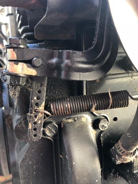

TimH 105 #2 Posted October 11, 2018 I did find the Gov. spring was looking like it was to long when engine was shut off FYI I checked to make sure throttle butterfly was full open with Gov was pulled as far to left Share this post Link to post Share on other sites
pfrederi 21,300 #4 Posted October 13, 2018 Did you do the initial governor adjustment (loosening the PAL nut etc) as outlined in the manual? Also your spring is one hole up from #6. Was that the way it has always been? that should lead to more sensitivity you could try one more hole up. Als0 have you checked the top end speed??? 1 Share this post Link to post Share on other sites
TimH 105 #5 Posted October 14, 2018 Thank you so much pfrederi Man is nice . Working like new now. Looked like Gov. settings were reset by person I bought Horse from. Now on to see if needs head de carbon and Valve adjustment check Share this post Link to post Share on other sites

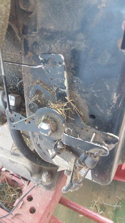

Warning:Unsupervised 83 #6 Posted June 12, 2020 Ive never been sure if my M14 spring is on correct so I just left it alone? Not heard my governor kick in once since having but felt it should have a few times yesterday mowing thick grass as high as my hood. Never mowed that high before with it. Never heard gov kick in even in high gear it mowed smooth & steady like it was just 6in of grass. Should it have kicked in on a 314-8 with a 42" deck in high gear? I see the governor end shown here and Kohler manual states 6th hole from top on it (mine is 6th) but I've never seen the other end of this spring's location anywhere? Does it even matter? Heres my throttle linkage, its a butterfly design with many holes to pick (1988 Model). Correct hole here? Thanks folks Share this post Link to post Share on other sites

WVHillbilly520H 10,379 #8 Posted June 14, 2020 On 6/12/2020 at 4:11 PM, 123GO said: Ive never been sure if my M14 spring is on correct so I just left it alone? Not heard my governor kick in once since having but felt it should have a few times yesterday mowing thick grass as high as my hood. Never mowed that high before with it. Never heard gov kick in even in high gear it mowed smooth & steady like it was just 6in of grass. Should it have kicked in on a 314-8 with a 42" deck in high gear? I see the governor end shown here and Kohler manual states 6th hole from top on it (mine is 6th) but I've never seen the other end of this spring's location anywhere? Does it even matter? Heres my throttle linkage, its a butterfly design with many holes to pick (1988 Model). Correct hole here? Thanks folks Look at post pic above that's where the other end of the spring is located and supposed to be in the 6th hole from the top.. Side note an air compressor would do you some good blowing off all the grass from the engine when you're done mowing JMO. Share this post Link to post Share on other sites
