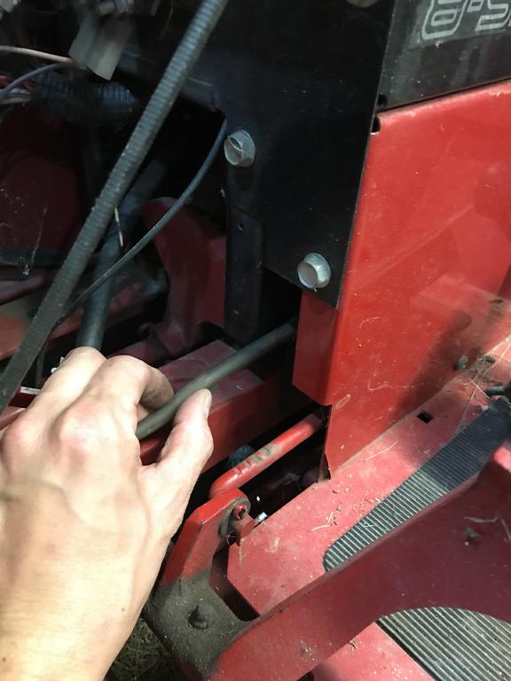

Gumshu 0 #1 Posted October 3, 2018 (edited) Hey guys, I can’t find info through the search so I’ll ask, what is the hose that goes through the frame just behind the engine on my 310-8? Edited October 3, 2018 by Gumshu Added photos Share this post Link to post Share on other sites

EricF 589 #3 Posted October 3, 2018 Battery breather tube? Some batteries have them. Not all though, but the tube can be left behind after a battery swap. 2 Share this post Link to post Share on other sites
WVHillbilly520H 10,379 #4 Posted October 4, 2018 On my 520H that tube is routed up to the plastic battery tray which in turn is to help drain acid/water away from the rest of that area. 4 2 Share this post Link to post Share on other sites
Gumshu 0 #5 Posted October 4, 2018 I assumed so but can’t see inside without taking the battery out. I’ll check it out in the next few days! Thanks guys! Share this post Link to post Share on other sites
JAinVA 4,638 #6 Posted October 4, 2018 Like Jeff says battery tray drain. 2 Share this post Link to post Share on other sites
WVHillbilly520H 10,379 #7 Posted October 4, 2018 7 hours ago, Gumshu said: I assumed so but can’t see inside without taking the battery out. I’ll check it out in the next few days! Thanks guys! Yep it's under the battery a plastic tray if it hasn't been tossed away. Share this post Link to post Share on other sites
Turftech 82 #8 Posted October 4, 2018 I believe it is part # 106948. This # is used in current commercial equipment built by Toro,. You will probably need to replace the Plastic tubing as they harden with age and no longer stay attached to the nipple on the tray (press on fit). My six tractors all are set up this way because it helps drain any water from cleaning the area away from the painted components. Dry acid "dust" from natural venting is reactivated as a corrosive when wet. Hope this helps 2 Share this post Link to post Share on other sites
