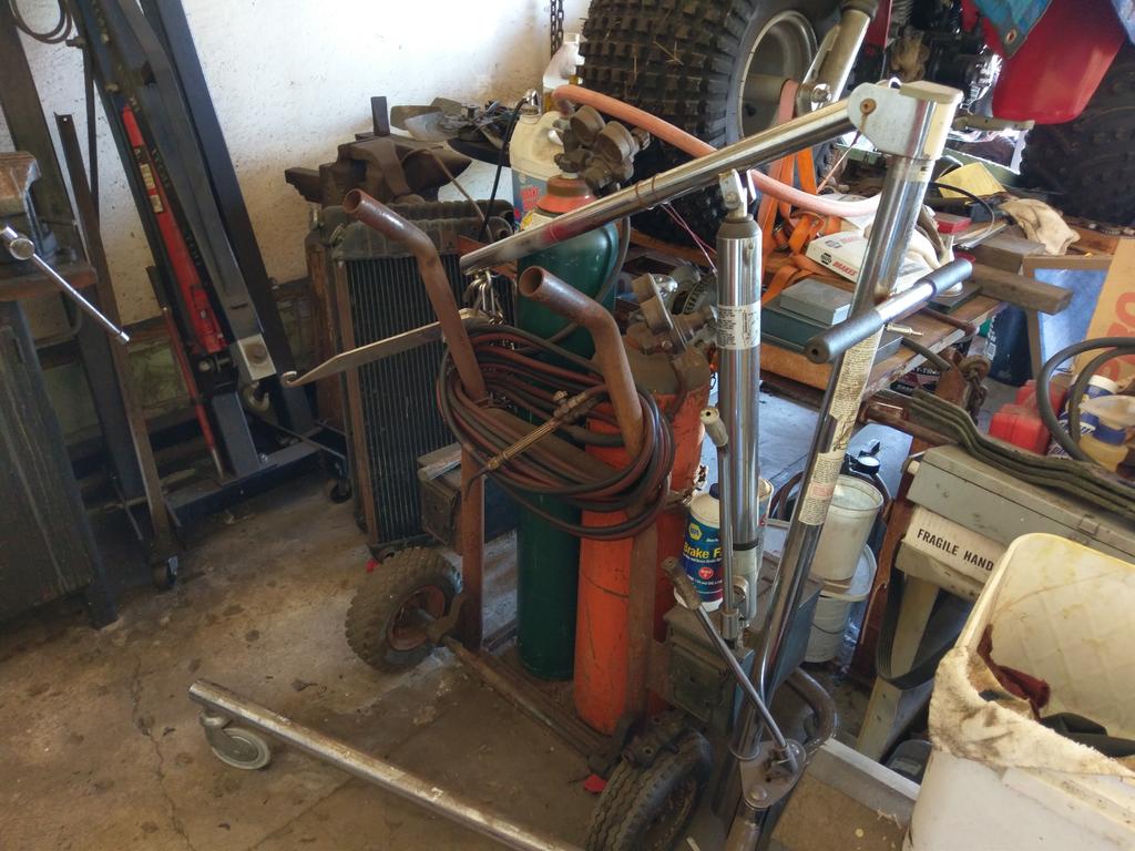

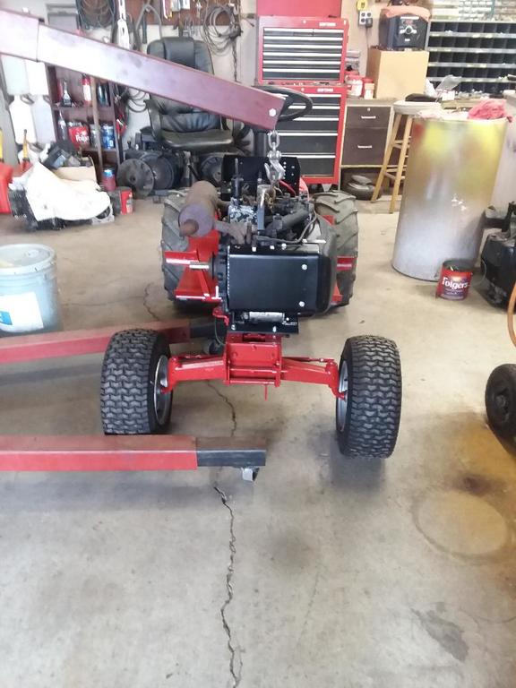

WVHillbilly520H 10,378 #51 Posted October 10, 2018 On 10/2/2018 at 5:11 PM, elcamino/wheelhorse said: @ebinmaine this will be right up your alley as I know you like a bargain . A few years ago I bought a hoist that is used to move people from beds , into tubs etc from Goodwill for $25.00 rated to lift 500 lbs. I move engines , jack up tractors . Has nice wheels just like an auto hoist for engines etc. I would send you a picture but I am too lazy to walk out to the shed. Here you go Jim and Eric...its wrapped around the "Blue wrench" tanks, used this very "hoist" to yank the little 3 cylinder Daihatsu diesel out of the 523Dxi. 2 Share this post Link to post Share on other sites
elcamino/wheelhorse 9,363 #52 Posted October 10, 2018 @WVHillbilly520H and @ebinmaine I have the same hoist , I like the way you can adjust the width of the front wheels . Narrow width for storage and wide for lifting. Works great. Eric check out estate sales . 1 Share this post Link to post Share on other sites

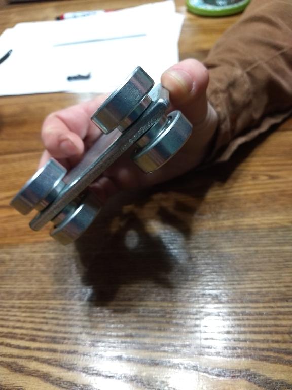

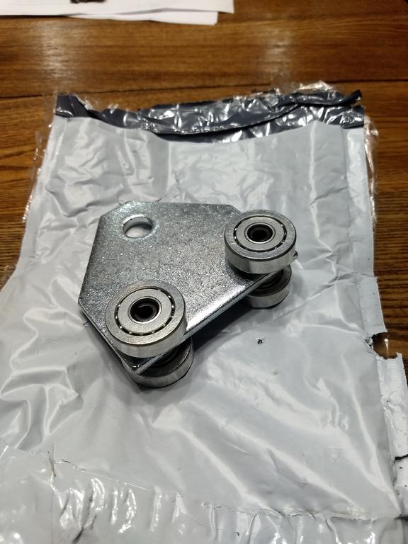

ebinmaine 78,256 #56 Posted October 11, 2018 I ordered this Unistrut trolley the other day. This particular one has a 600-pound load limit. To start with I'm going to put up a 4 foot wide piece of Unistrut and hang this from it and that will make it so I can pick an engine up and move it 4 feet one way or the other. Perhaps later on I'll add two more pieces of Unistrut to the ends and increase my movement potential. 1 Share this post Link to post Share on other sites

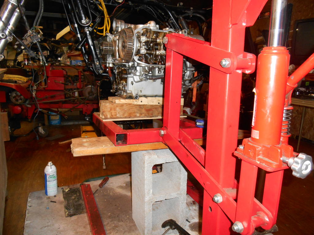

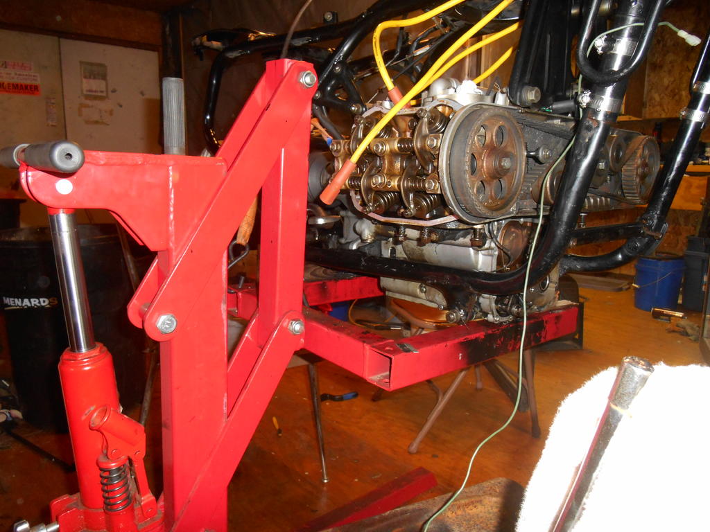

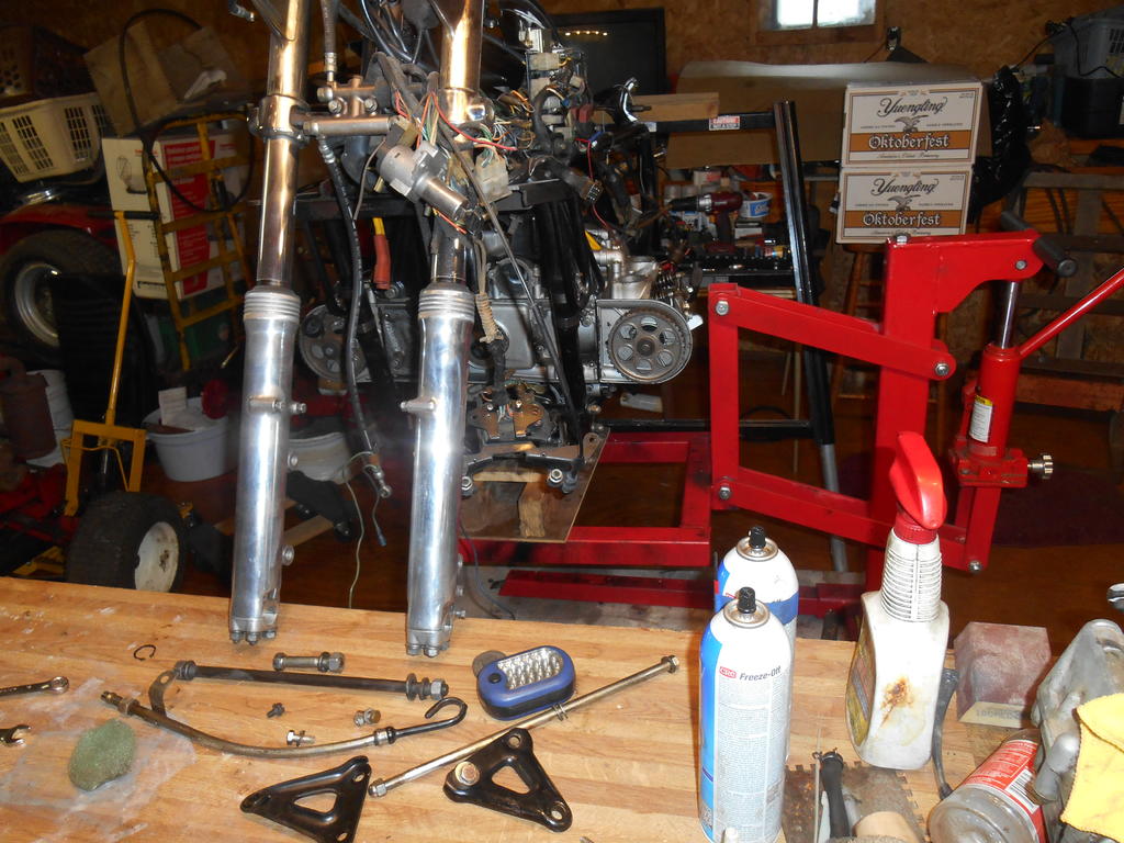

ohiofarmer 3,389 #58 Posted October 12, 2018 Ok, first off, i am blessed to have all the floor jacks, low motorcycle lifts, portable engine hoists, come alongs, ect. I even have a motorcycle lift table that is 30x96 and will lift two thousand pounds. For the specific job at hand, this little lift will go fron 2.5 inches to 30 inches. Just put a nice piece of 3/4 ply on it and walk that engine off the tractor. I use it for so many things that I cannot afford to be without it. One time I used it to lift a Honda gold wing, after cleaning it up, I set the front forks on a stand and used a chain fall from the ceiling to put the rear on a stand. Then I put the lift on a dolly and was able to nudge the engine loose from the frame and driveshaft by wiggle and slight lift and lower. Just an outstanding tool. So take a 20% off coupon and it is 124.00 plus tax! Outstanding bang for the buck and about ten minutes to assemble. If I had the time, I would use mine as a pattern and make my engine lift into a larger version to put stuff on shelves https://www.harborfreight.com/high-position-motorcycle-lift-99887.html Share this post Link to post Share on other sites

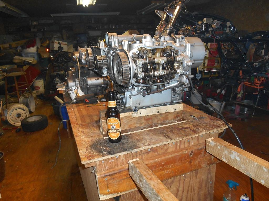

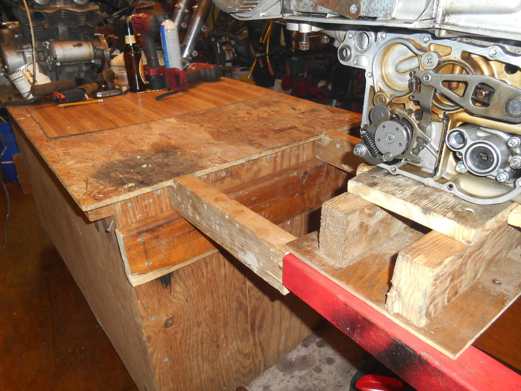

ohiofarmer 3,389 #60 Posted October 12, 2018 (edited) So here we are start to finish with the engine in the frame, The bike suspended and preparing to lift the engine out, engine free, a little bridge to slide the engine to my rebuild cart, and the final picture with the engine ready to change some seals and refurb the starter. BTW, you have to scroll down the previous post to see all 5 pictures Edited October 12, 2018 by ohiofarmer 2 Share this post Link to post Share on other sites

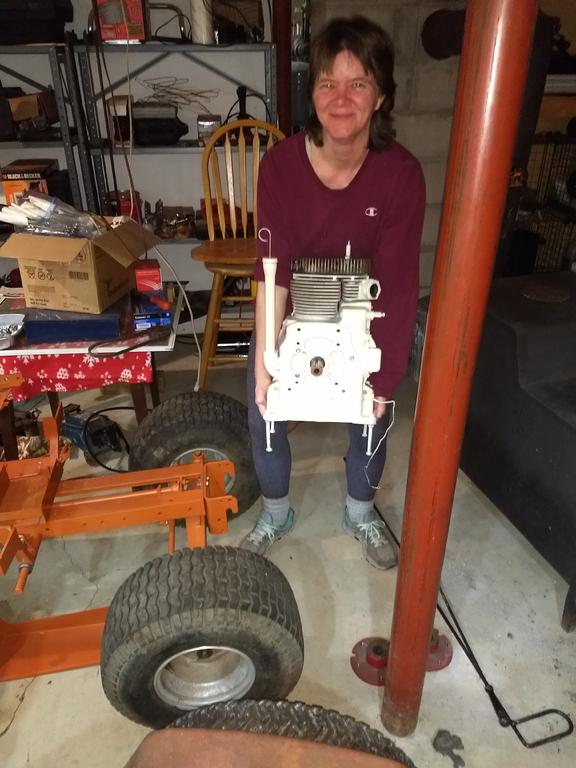

ebinmaine 78,256 #61 Posted January 22, 2019 Ok now for the record.... I did purchase a 1 ton chain Falls to help around the shop and I have used it a few times. Great investment. But here's how you move a K341 from floor to Tractor frame. 4 1 Share this post Link to post Share on other sites

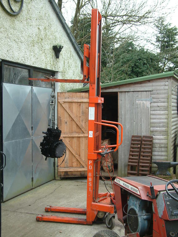

Stormin 9,987 #66 Posted January 24, 2019 I've got this 12v forklift. I also made a jib for it. Not got the hight to use it in the workshop though. Also have this gantry. Last but not least, the multi purpose hospital bed. 2 2 1 Share this post Link to post Share on other sites
