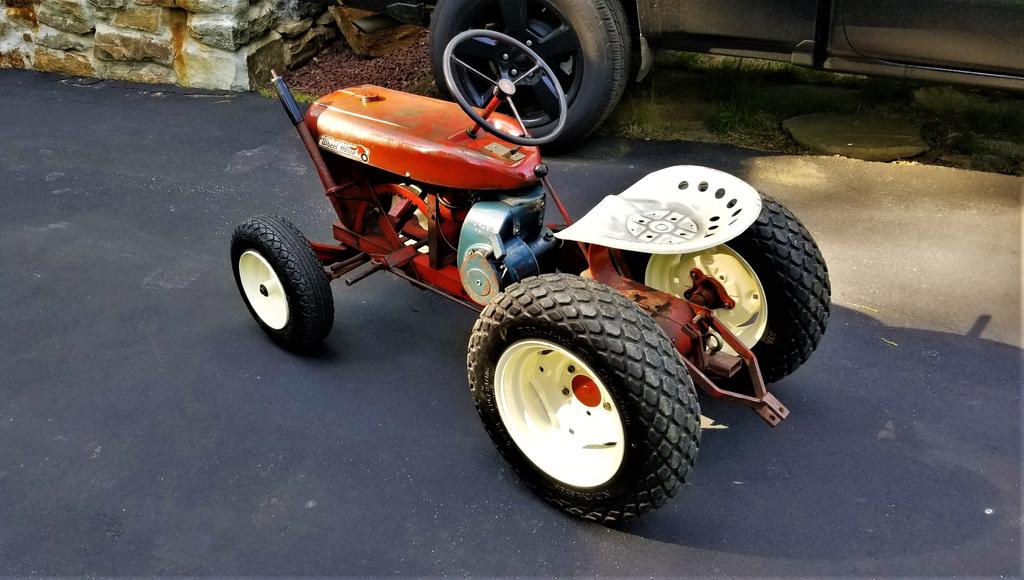

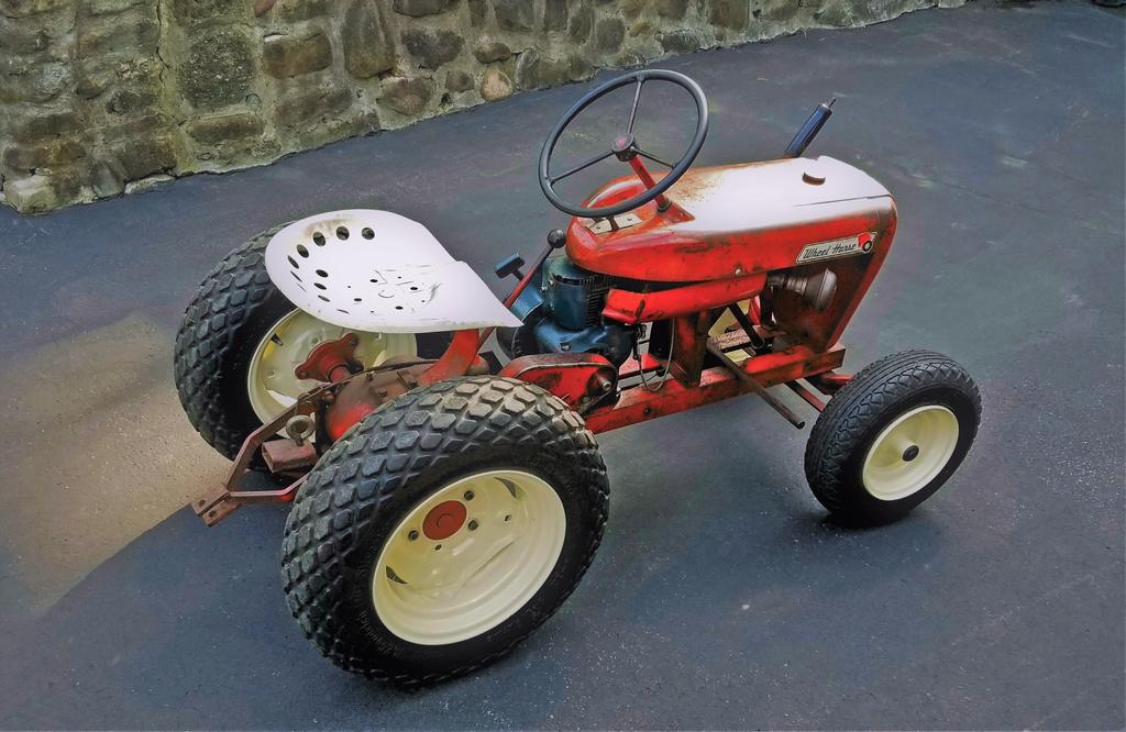

Paul Boy 31 #1 Posted September 24, 2018 We recently acquired a very old Wheel Horse tractor, its quite roached and rusted and may have part from other Wheel Horse models. The tractor itself was kept inside a shed but the engine is another story. I am almost positive that we will have to do an engine replacement. The guy we got it from said that the original engine is a 3 HP engine and it is one that is placed under the operators legs and not forward under the hood. My question is what would you suggest as a possible replacement engine? I will appreciate any advice you can give me. Share this post Link to post Share on other sites

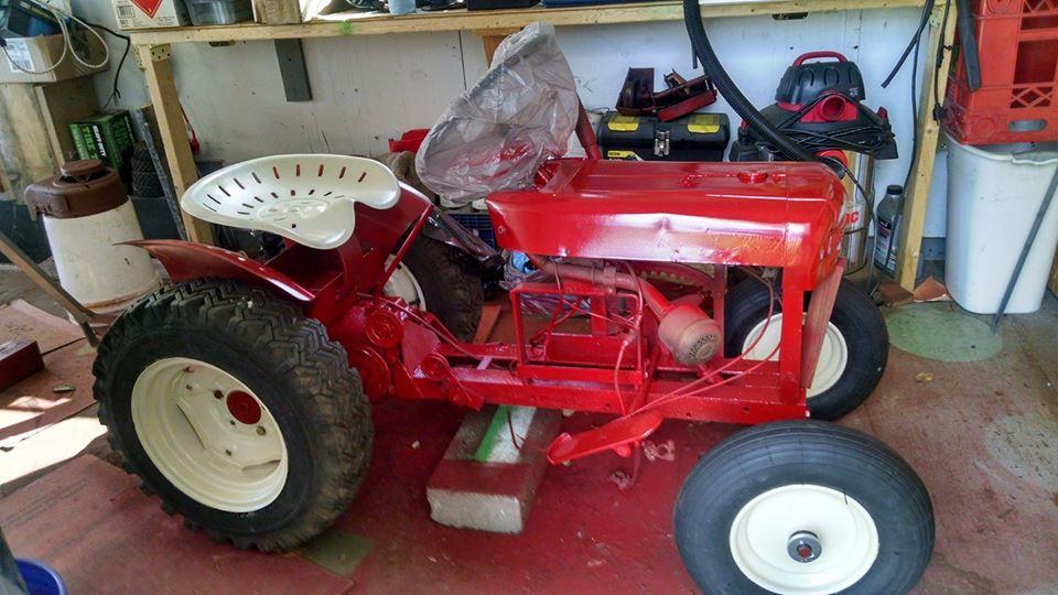

Paul Boy 31 #13 Posted October 12, 2018 We've made a bit of progress with the 551 this week. In the process of fabricating the lower portion of the hood. I think that there is a good chance that the original engine may be usable but the wife thinks we should use a replacement engine for now. I looked into the Preaditor 212cc 6.5 HP model. Would that be a sufficient replacement for this horse? Would there be much modification needed to make this engine work? I hope to be able to utilize the original gas tank with the new engine. Does anyone think this would be a feasible move to make. Share this post Link to post Share on other sites
