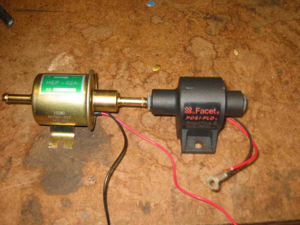

pfrederi 20,895 #1 Posted September 21, 2018 Over the last few years I have been converting my under seat gas tank horses to electric pumps. 3-4 year ago I did 2 C-175s and a 418A I used Facet Posi-Flo pumps. Being a cheap SOB and having seen other folks using no name Chinese pumps I bought 2 and put one on a C-175 in the spring. Worked OK (but looking back she only got a couple hours use this year). Last week put the second cheapy on a C-141. worked fine...for about 3 hours total then died several hundred feet from the shop. Pump simply stopped working no noise no pumping. Dead horse recovery is normally done by the FEL on the D200. Strap around the front axle of the sick horse pick it up and drive the D200 backwards to the shop. However the C141 had the front mount deck so that wouldn't work.. Took some jumper wire out figuring electric issue.. no go. I had left the mechanical pump on figuring in the future would make a cover plate. Had to take fender and seat off then bypass the electric pump and reconnect the mechanical one. No matter how i tried to figure what I needed multiple trips back for tools were in order. Got her running and didn't feel like putting the seat and fender back on so put it in low range 2nd and walked her back. Put a Posi-Flo on and all is well. Sometimes it is worth spending more Now I am wondering if i should take the cheapy off the one C-175 or take my chances... https://www.ebay.com/itm/2-Pcs-12V-Low-Pressure-Electric-Fuel-Pump-Diesel-Gas-Fuel-Oil-for-Universal-car-/182455270871?hash=item2a7b2e7dd7 . Share this post Link to post Share on other sites

pacer 3,180 #7 Posted September 22, 2018 I had about 3 failures with that round type pump. Had another cheapo type (see pic) that had been on my D-180 for some 10-12 yrs so in replacing the round types with the 'square' type I have been having better luck 2 2 Share this post Link to post Share on other sites
