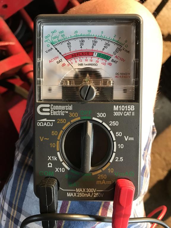

ryanmfairbank 26 #40 Posted September 24, 2018 Here’s the meter I’m working with...just to make sure, what’s the proper setting to use? Share this post Link to post Share on other sites
pfrederi 20,828 #41 Posted September 24, 2018 right side White 50 v DC Share this post Link to post Share on other sites
ryanmfairbank 26 #42 Posted September 24, 2018 Okay, that’s what I’m using...and I don’t have voltage at the solenoid, so what do I check next? Share this post Link to post Share on other sites

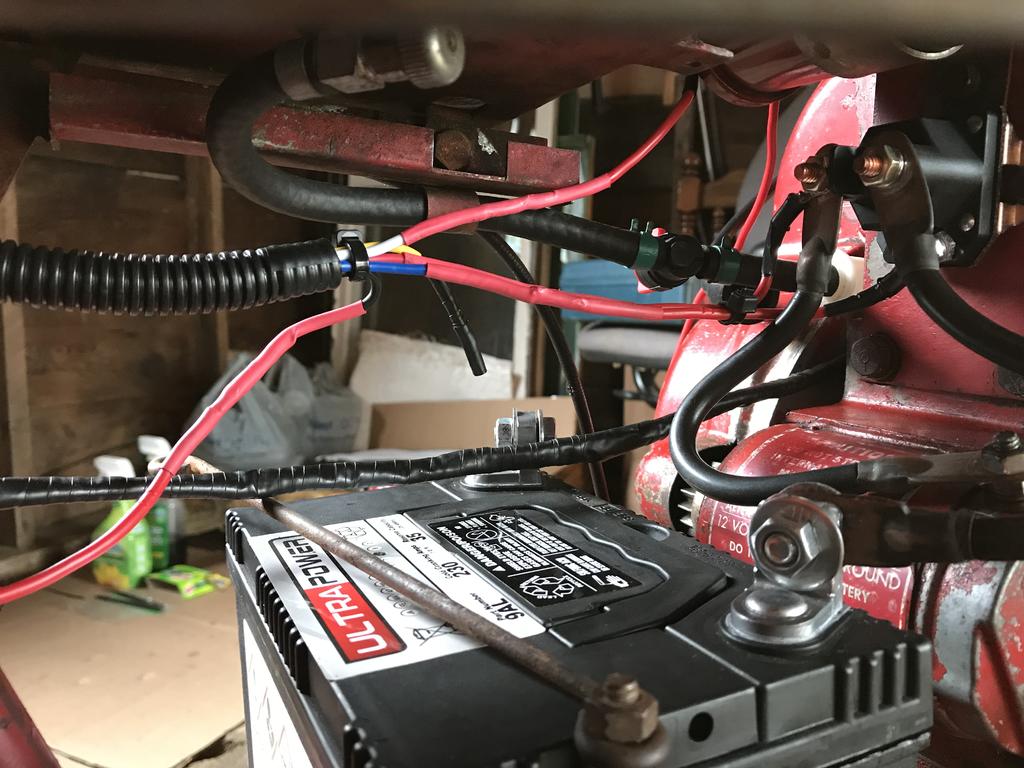

pfrederi 20,828 #46 Posted September 24, 2018 Studied your picture ...you wired the solenoid backwards. Share this post Link to post Share on other sites
pfrederi 20,828 #47 Posted September 24, 2018 The lighter wire is on the heavy terminal that goes to the starter. it should be on the other one the one that comes from the battery!! Share this post Link to post Share on other sites
ryanmfairbank 26 #48 Posted September 24, 2018 🤦🏼♂️ 🤦🏼♂️ 🤦🏼♂️ Share this post Link to post Share on other sites
ryanmfairbank 26 #49 Posted September 24, 2018 I’ll get right back to you.... Share this post Link to post Share on other sites
ryanmfairbank 26 #50 Posted September 24, 2018 I can’t believe it was something that simple! Thank you so much!!! If you ever have time, would you be able to tell me how to wire in the ammeter? Share this post Link to post Share on other sites
