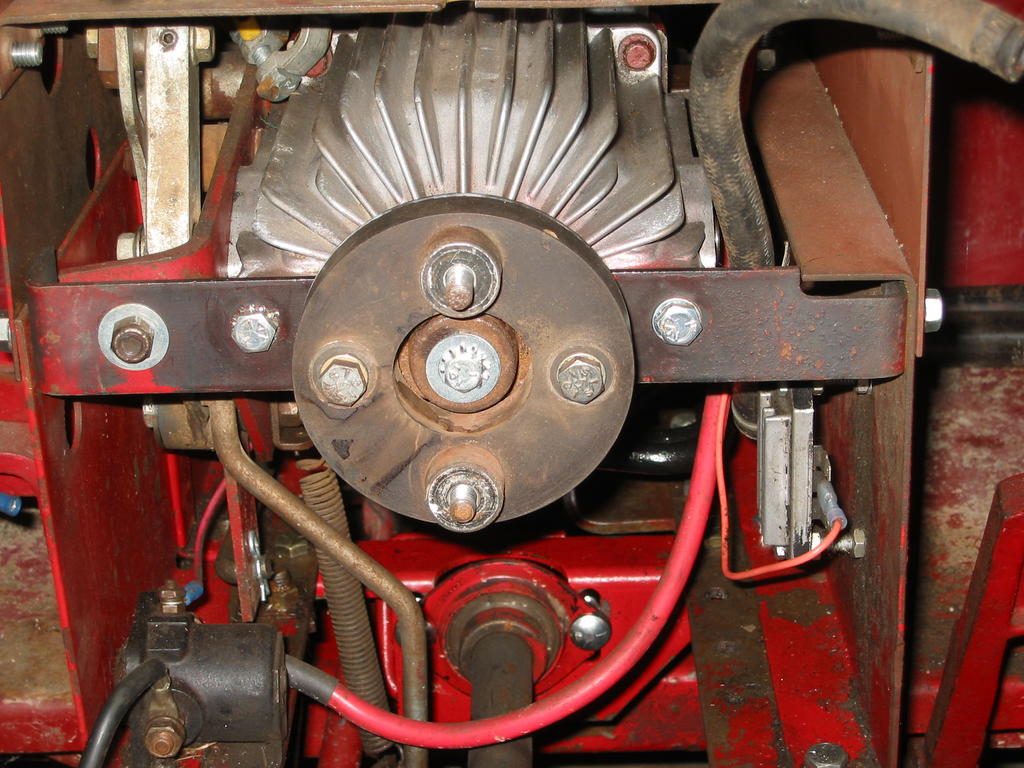

bo dawg 585 #18 Posted September 23, 2018 18 minutes ago, pfrederi said: Engine to pump That little 2 bolt piece causes that much trouble! What signs does it give when it is starting to go bad? Share this post Link to post Share on other sites
pfrederi 20,226 #19 Posted September 23, 2018 Yes the splines inside strip out as the pump shaft only engages a portion of them. I don't think they give much warning one day nothing works 1 Share this post Link to post Share on other sites

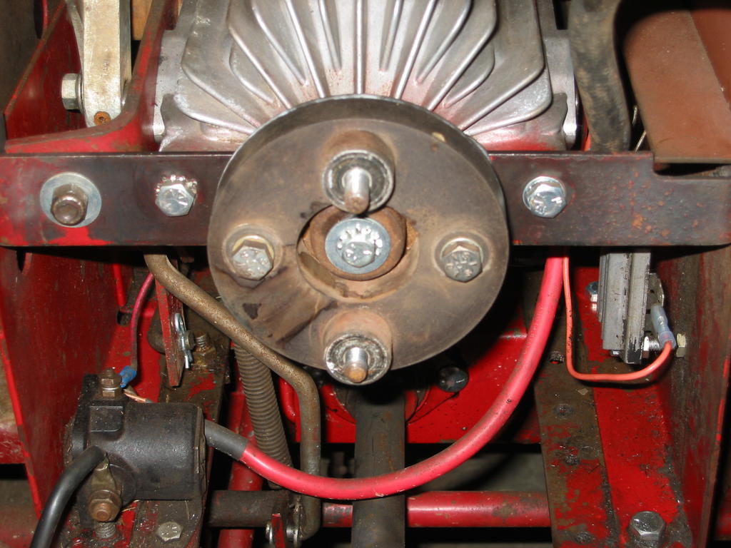

bo dawg 585 #20 Posted September 23, 2018 So does this look normal? Not flat. Share this post Link to post Share on other sites
pfrederi 20,226 #21 Posted September 23, 2018 The TSB on the coupling shows a slightly different hook up for Onan's compared to Kohlers. I have a Kohler my rubber donut runs flat... Do not know about Onan's Share this post Link to post Share on other sites
bo dawg 585 #22 Posted September 23, 2018 (edited) Yea Onan just had to be different so Kohler wouldnt get mad at them. Lol! Edited September 23, 2018 by bo dawg Share this post Link to post Share on other sites
pacer 3,179 #23 Posted September 23, 2018 "So does this look normal? " Looks can be deceiving -- If it shows signs of destructing then obviously it s going, but with spline wear its likely to not be visible. Get in there with your hand or long screw driver or wrench and see if you can detect ANY slack on either motor side of pump side. Even this isnt a very reliable indicator, as mentioned, one day it will just quit! Im in the Kohler engine group also and as far as extras you have the very best accessory of all and thats the 3 point. My D-160 and D-180 have it but my D-200 doesnt 1 Share this post Link to post Share on other sites

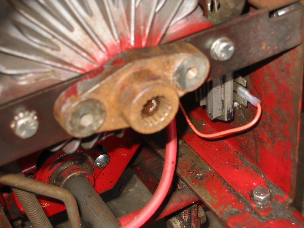

Sarge 3,470 #25 Posted October 1, 2018 Ok - from what I've learned with my own nightmare on the D's Sundstrand pump there is no Lovejoy coupling that will fit that shaft without a lot of machine work. The two main issues are the size of the shaft (9/16" or so) and 17 spline count. The other, the coupling itself - it's cast iron, not cast steel. So, over time, hard loading or shock loads - the splines will fail. That picture of the D-160 coupling is a red flag - either someone has had it apart and reversed it, or they moved the engine back tighter against the pump from a stripped shaft, or both. That rubber puck should not be flexed in that manner when it's right. The more I look at it, looks as though someone has put spacers on the engine flywheel side to shove it tightly against the pump splines - not good. Now, that said, it can be repaired - but there's a problem. There are no new couplings available unless you get crazy lucky and score a NOS one from somewhere. I found a "decent" used one that still had some wear already showing on it - very tough to determine if one is worn or not until it's in your hands and you can fit it against the shaft splines. Mine had failed miserably, blowing the teeth off both the pump shaft and internal splines in the coupling when I snagged the front blade on some concrete. Repairs were not cheap as I had a lot of machine work done to the repair to make it work - knock on wood, but so far it's holding well. LJ Fluid Power in Michigan is your friend for that pump and any parts needed. They even went to the trouble to have new shafts made to repair pumps that are stripped - $280 I believe. On mine, I sourced a good solid used pump, a C-1*1 model rear input pulley that is splined and spent about $400 at a machine shop. Had the shop machine a keyway into the pump shaft and wire EDM (look it up, cool process for cutting) a matching slot in the pulley center which has to be indexed/timed properly to match the splines. The old, stripped coupling was bored out to accept the C-series hub after I machined off the factory weld and removed it. That was pressed into the old coupling and welded, very carefully. So, now the coupling has a C-series splined pulley center with a key and a set screw in it to make a more robust connection. There is a chance a Lovejoy coupling could be used - but you'd have to machine that pump shaft into another shape to make it work, and that shaft diameter is already too small. The problem with the design is that shaft is sized to allow the pump housing cover to come off - so if you wanted to weld the shaft into a bigger diameter the aluminum pump housing cover would need matching work and its shape will really not allow that. Be aware that the shaft on that Sundstrand pump is some seriously hard material - the machine shop wiped out some cutters trying to get the key slot done. Also, the cast iron coupling is very high in carbon and does not weld very well nor is it easy to machine. I'd bet this process cost the 2 shops at least 5 cutters... Due to the location of the pump, coupling and associated hydraulic parts working on that D is a frustrating endeavor, but it can be done. I do love mine now that it's fixed, the extra weight, 3pt hitch and a frame that can withstand a tremendous load is nice to have around here. I have a fairly detailed thread somewhere around this site about the whole repair process - might want to check it out. Sarge Share this post Link to post Share on other sites
