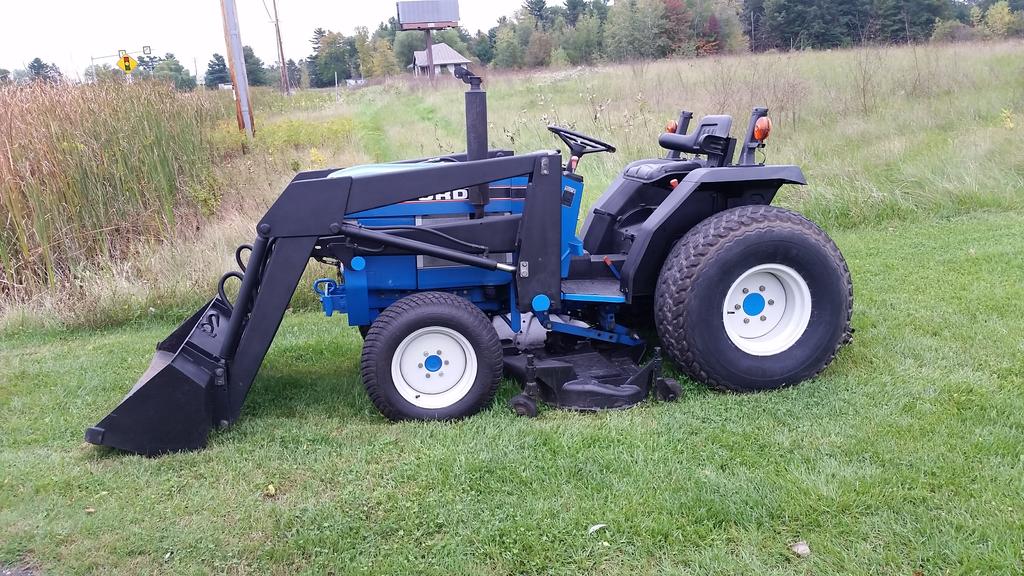

Saw this along the road the other day for sale. Since I am always in the market for a SCUT/CUT does any body know anything about these Fords? Seems like he is a little high on his price but not sure. Dan @Achto this is sitting at Milty Wiltys in Wautoma if you get that way check it out and see what you think. I really have no use for the belly finnish mower but it comes with it. Maybe use it for rough cutting the plow field?
Tractor Data says this is a Japanese made unit. and original price was 13k. Doest that sound right?
http://www.tractordata.com/farm-tractors/005/9/2/5927-ford-1520.html

I dunno Jim, I think the 1700 that you were looking at may be a better deal. It would be more tractor for less $. Both 1520 & the 1700 were built by Shibaura in Japan, so that aspect of them would be the same.
1520 - I have a love / hate relationship with a hydro tranny on a loader tractor. The hydro is handy for changing directions and adjusting speed but this convenience comes with a power loss. If you have to push into a pile or scrape hard with the bucket the power is not always there with the hydro.
1700 - This tractor looks like it is a gear jammer, not as convenient as the hydro for maneuvering but much less of a power loss. Add does not state if it has shuttle shift though. Shuttle shift is nice because you can shift on the fly, no need to come to a stop in order to change directions but it is still a gear jammer. Shuttle shift is kinda the best of both worlds in my mind.
Just some opinions to take into consideration.

Could open up a debate here as to which might be better in the woods. :think:
Ford 1700 - 2400lbs  + wheel weights + the block of cement hanging off of the 3 point. 2wd with a diff lock, ag tires on 24" rims on the rear.
Ford 1520 - 2200lbs + no extra weight that I can see. 4wd with turfs all the way around, & the rears on 16" rims.
:confusion-confused: Could be a hard call

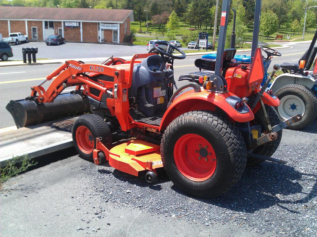

@WHX20, both of my SCUTs are gear jammers, the only issue I have is there should be a mid range sometimes high is too high as low too low but that's where JD or Kubota may shine better if you can find one reasonablely priced used, the Kioti I found as a trade in at the dealership less than 500 hours worn out front turfs good loaded rear turfs FEL and 60" MMM out the door and delivered for $6500, and IMHO it's bests to have 4wd and not need it than the other way, Jeff.

Jim, most of these SCUTs are Japanese or South Korean or at least powered by Yanmar Kubota Kioti(Daedong) or Mitsubishi ect (the Chinese would be like the NorTrac or Cabela's brand), any ways 20-27 engine HP hydros always have less Drawbar/PTO HP, other than some of the smaller ones today(BX Kubota has limited CAT1) both of mine have full CAT1 3PT, even CUB CADET had Yanmar build their last version of SCUT so they would be worth looking into, as well as Bobcat was built by Kioti for 3-5 years same as mine but 25 hp vs 22, as far as tires I replaced the turfs with R4s (because I didn't want to buy new rims as if you went with R1s) as far as traction it's really a toss between the 2 back home dragging logs (AG type "R4" are just a personal preference of mine, good luck with the hunt some the chase is as much fun as the acquisition, Jeff.
