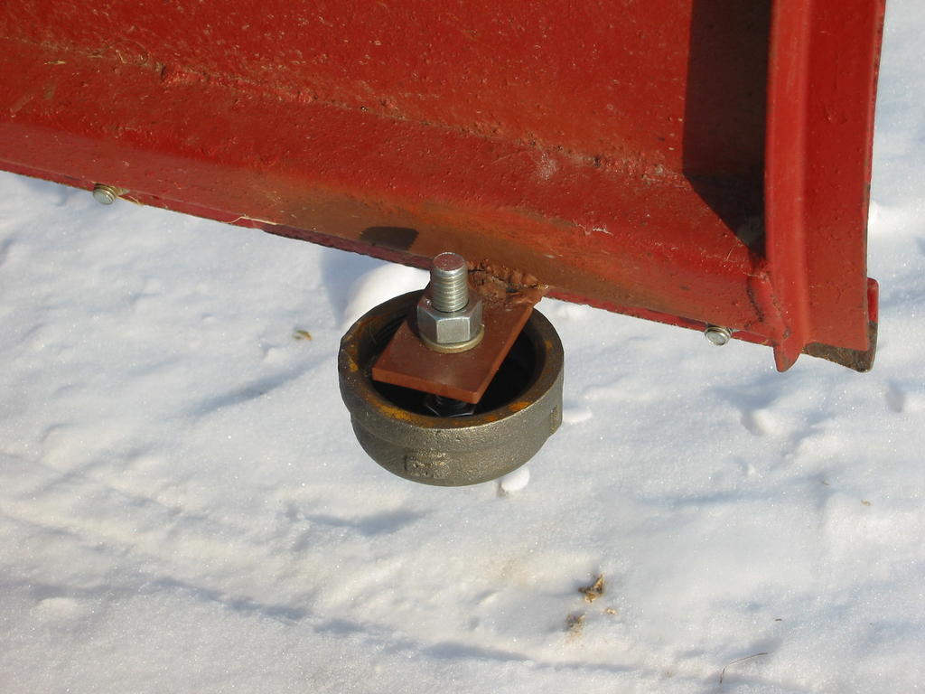

pfrederi 21,228 #2 Posted September 8, 2018 For something like $85 Toro will sell you some nice skids for your plow..but you have to have a newer blade with keyhole slots on the back to use them. I have made up skids using iron pipe caps and carriage bolts. They only last 2 or three seasons but they are cheap to make Share this post Link to post Share on other sites

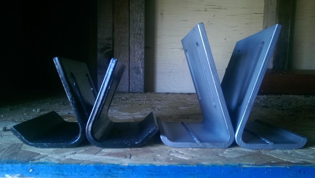

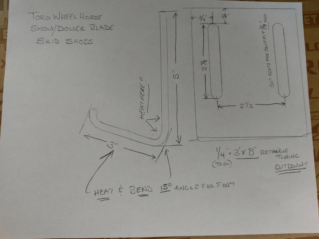

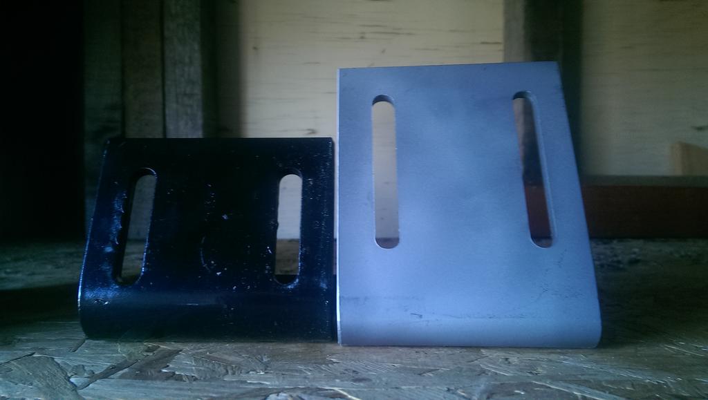

WVHillbilly520H 10,379 #3 Posted September 8, 2018 (edited) 6 hours ago, pfrederi said: For something like $85 Toro will sell you some nice skids for your plow Or you can make your own (black Torofactory raw steel my version) here's my blue prints ,and to answer your question, yes they do help. Edited September 8, 2018 by WVHillbilly520H 2 Share this post Link to post Share on other sites
Daron1965 644 #4 Posted September 8, 2018 Thank you very much. 2 Share this post Link to post Share on other sites
elcamino/wheelhorse 9,363 #5 Posted September 8, 2018 I bought a pair of @WVHillbilly520H skids from him and they are very nice. Just have to find the time to install. 1 1 Share this post Link to post Share on other sites

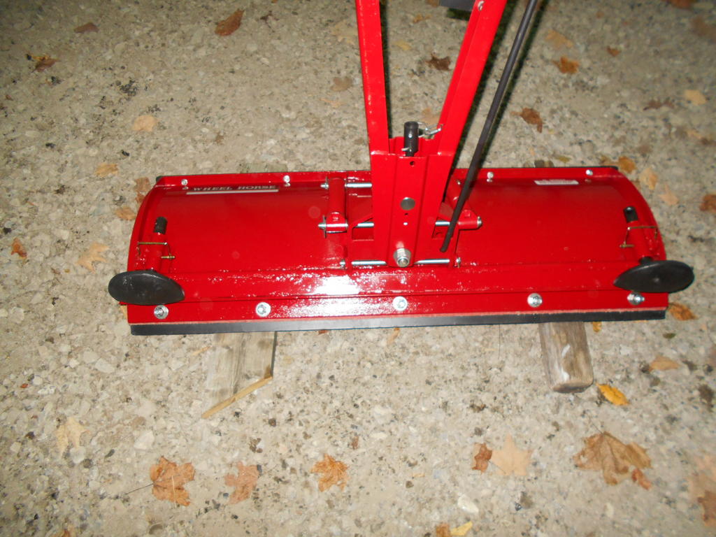

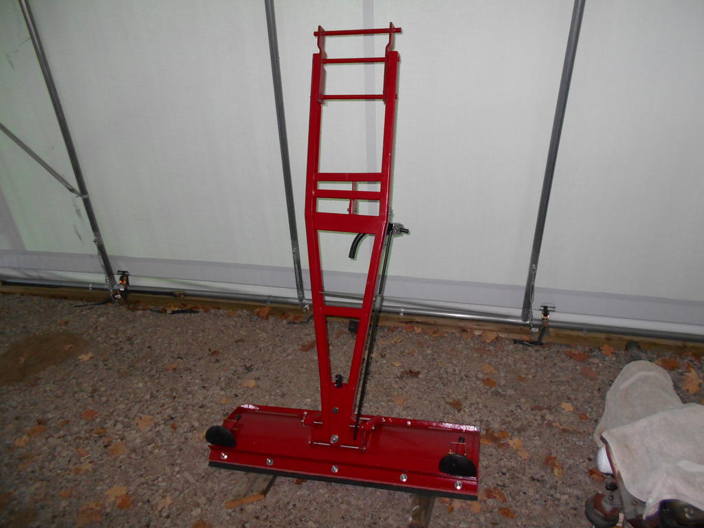

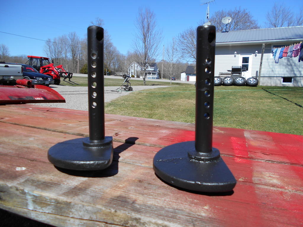

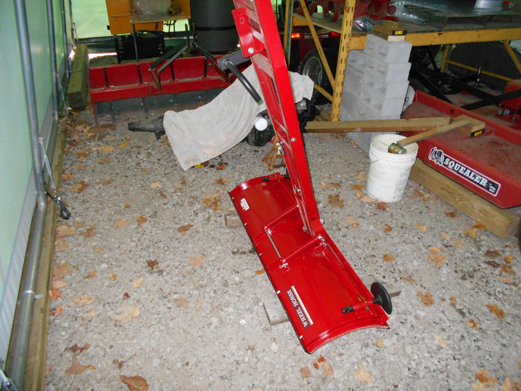

cleat 9,382 #10 Posted September 9, 2018 My blade has skids for a full size truck plow installed. It came that way, I just cleaned and painted it. You just install pin at whatever height you want it. Skids slip into a piece of pipe that has been welded to blade. One side has been cut off some for clearance. Cleat 1 2 Share this post Link to post Share on other sites
cleat 9,382 #11 Posted September 10, 2018 Here is a closeup of the skids themselves. Cleat 2 Share this post Link to post Share on other sites
