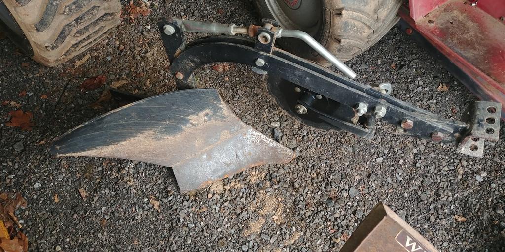

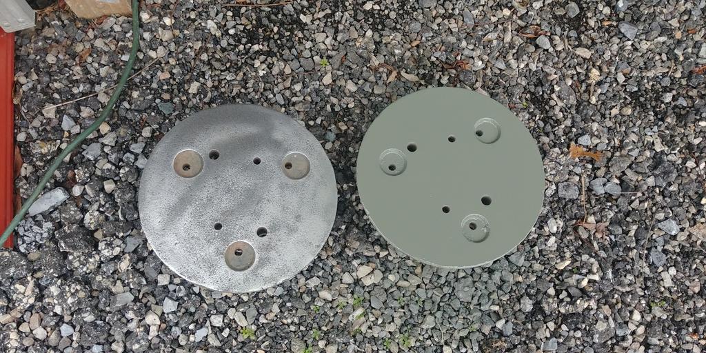

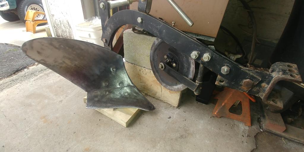

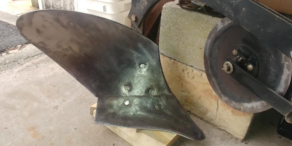

WVHillbilly520H 10,379 #203 Posted March 24, 2020 Got at it this evening with the "paint and rust" strippers on the moldboard of my $50 Brinly (not as shiny as Dan's) and a $35 set of front wheel weights and some self etching primer, next some paint on the weights and installed on the 315. 6 Share this post Link to post Share on other sites
WHX?? 58,075 #204 Posted March 24, 2020 (edited) Take a flap wheel on the 4 inch to it Billy then work it! Need I tell you to grease it down afterwards? Something looks fishy the way those share bolts are drawn or is just the pics?... Sounds like you had a nice score tho? Edited March 24, 2020 by WHX24 1 Share this post Link to post Share on other sites
WVHillbilly520H 10,379 #205 Posted March 25, 2020 9 minutes ago, WHX24 said: Take a flap wheel on the 4 inch to it Billy then work it! Need I tell you to grease it down afterwards? Something looks fishy the way those share bolts are drawn or is just the pics?... Sounds like you had a nice score tho? What grit do you recommend? As you can see in the 1st pic it was only used a few times then put up without cleaning/oiling so grease or as my dad used to do on the old Allis Chalmers afterwards was burnt motor oil. Yes those bolts are drawn bit deep I suppose I could go buy some new ones. I basically cleaned up all the rusted metal and peeling paint till I get going turning earth. Share this post Link to post Share on other sites
Achto 32,637 #206 Posted March 25, 2020 2 hours ago, WVHillbilly520H said: What grit do you recommend? 120 grit would work to shine it up. A Scotchbrite pad a on a grinder also works really well to knock the rust off of the share. The final shine on mine came from a few 1/4 mile long passes in some clay/loam mix soil. It's not often that I get to plow in such soil & end up with an almost chrome appearance on the plow, but it sure looks cool when it happens. Around home sandy soil is more of the norm, sand still puts a shine on but the share will have little more of a dull finish. 4 1 Share this post Link to post Share on other sites

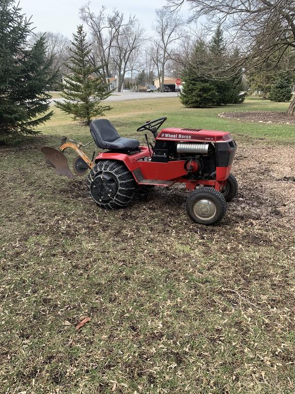

Andy N. 2,807 #207 Posted March 25, 2020 Thanks to the unexpected staycation (going on week 2), I was able to complete a couple major indoor projects that we wanted to get done (master bathroom and main bathroom renovations). However, today I had enough of the inside work and needed to get out and do something with the WH's. I removed the front blade from the 418-A and put on a Brinly plow that came with the 520-H donor tractor that I picked up last fall. It was a little wet, but I decided to plow the garden anyway. Here's a pic and a little slow motion garden plowing drive by. Garden_Plowing_Slow_Motion_Drive_By_3-24-20.mp4 5 Share this post Link to post Share on other sites

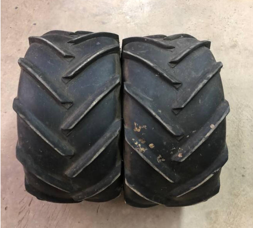

Pullstart 71,215 #208 Posted March 25, 2020 Any input as to whether these tires would be any good weighted down and pullin’ a plow? They’re Carlisle and have been cut for pulling. 1 Share this post Link to post Share on other sites
Razorback 1,370 #209 Posted March 25, 2020 I think those would be OK, but I get the best bang for the buck by putting chains on turf tires, or you can even put the chains on the bar tires. 1 Share this post Link to post Share on other sites

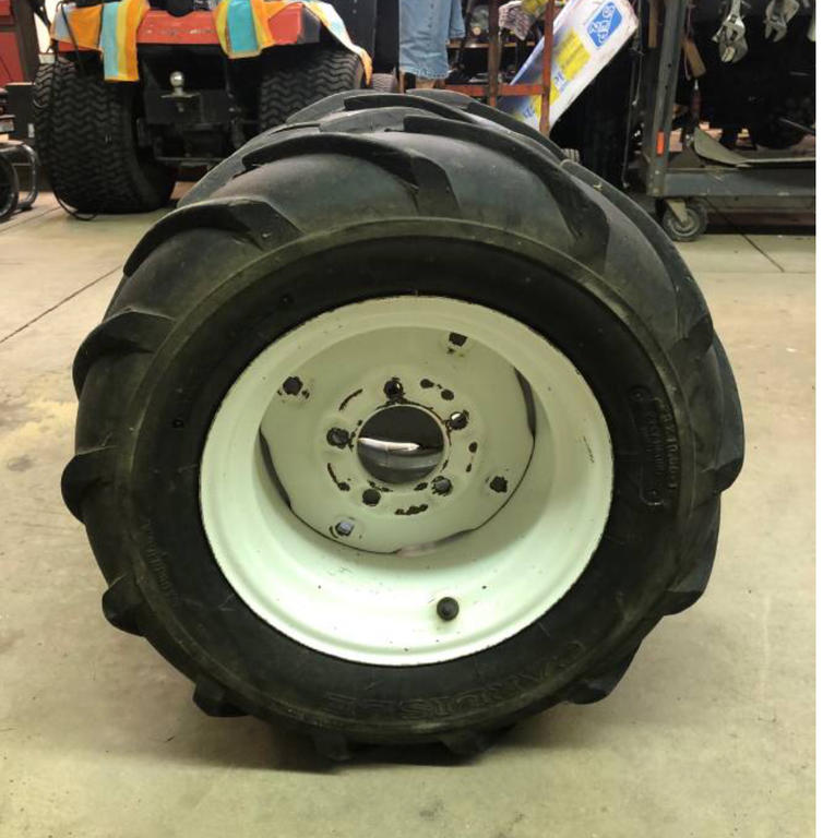

Pullstart 71,215 #210 Posted March 25, 2020 These are for sale locally, cheaper on rims than I can buy a set of Deestones for. I’d rather support local than overseas in this time of need if I can help it. 5 Share this post Link to post Share on other sites
Achto 32,637 #211 Posted March 25, 2020 (edited) 1 hour ago, pullstart said: Any input as to whether these tires would be any good weighted down and pullin’ a plow? I would think that those would work out good Kevin. The sharper lugs should give a good bite in the field. Edited March 25, 2020 by Achto 2 1 Share this post Link to post Share on other sites

WHX?? 58,075 #214 Posted March 25, 2020 (edited) I would get those if the price is right Kev. Loaded or with weights they'll work fine last a long time. Check the offset on those rims tho looks awfully deep …. IDK might just be the pic. Cool vid @Andy N. ….you just scored yourself an invite to plow day! Hey Dan is that yer wallet layin ther in Jack's pic??? Edited March 25, 2020 by WHX24 1 4 Share this post Link to post Share on other sites
Pullstart 71,215 #215 Posted March 25, 2020 3 hours ago, WHX24 said: I would get those if the price is right Kev. Loaded or with weights they'll work fine last a long time. Check the offset on those rims tho looks awfully deep …. IDK might just be the pic. Cool vid @Andy N. ….you just scored yourself an invite to plow day! Hey Dan is that yer wallet layin ther in Jack's pic??? They are centered. He said that’s their preference for pulling. Asking price is 120 obo. Think 100’s out of line? Share this post Link to post Share on other sites
roadapples 6,987 #216 Posted March 25, 2020 You may need spacers with that back set... Share this post Link to post Share on other sites
WHX?? 58,075 #217 Posted March 25, 2020 (edited) That's what i was thinkin too Jay...Problem ther is spacers may stuff the tire out of the furrow??? Especially as wide as they look. No way Kev... 100 is a smokin deal with rims. If they pulled on a track they'll pull a plow. Even if you have to peel them off and on other rims still a good deal. If they fit with no interference might be good to go as is. Edited March 25, 2020 by WHX24 Share this post Link to post Share on other sites
WHX?? 58,075 #218 Posted March 25, 2020 Maybe time to think outside the box here Kev... use one of those tires on the land side and weight the snot out of it. Use something narrower on the furrow side? Might work best with a 5060 or any LS tranny??? What say ye Jack or am I on crack? Share this post Link to post Share on other sites
Achto 32,637 #219 Posted March 26, 2020 11 hours ago, pullstart said: They are centered. He said that’s their preference for pulling Pullers want the back end of the tractor narrowed up, this helps to keep the diff from unloading on one side or the other. It also makes it easier to keep the tractor in a straight line. For the money I would pick them up, peel the tires off of those rims & put them on some rims with the correct off set. Weight them down & run 'em. If you don't have some extra rims laying around, you are capable enough to drill the spot welds out that hold the centers in those rims and move them so that the off set is correct. 1 1 Share this post Link to post Share on other sites

roadapples 6,987 #222 Posted March 26, 2020 18 hours ago, WHX24 said: That's what i was thinkin too Jay...Problem ther is spacers may stuff the tire out of the furrow??? Especially as wide as they look. No way Kev... 100 is a smokin deal with rims. If they pulled on a track they'll pull a plow. Even if you have to peel them off and on other rims still a good deal. If they fit with no interference might be good to go as is. The right size spacers would make the off set right... 2 Share this post Link to post Share on other sites

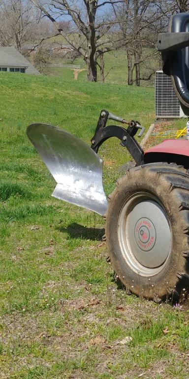

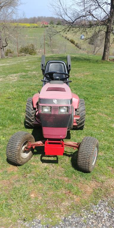

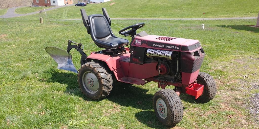

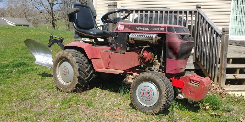

WVHillbilly520H 10,379 #223 Posted March 27, 2020 @PeacemakerJack, @WHX24, @Achto, @pullstart, think this will do as a start of plowing season? Josh for you a couple things, my last weight hanger and arm rests. Jim and Dan hope the plow is shiny 'nuff now, Kevin see there aren't no junk 520s ... Rollin' sod and dirt to come later. 5 1 Share this post Link to post Share on other sites

Achto 32,637 #225 Posted March 27, 2020 57 minutes ago, WVHillbilly520H said: Jim and Dan hope the plow is shiny 'nuff now, Looks like a right awesome rig Jeff. I'm diggin' the weight bar on the front, that should keep 'er from bucking on you. The mold board & share look great, they should scour off real nice in the dirt. Looking forward to seeing everything in action. 1 Share this post Link to post Share on other sites
