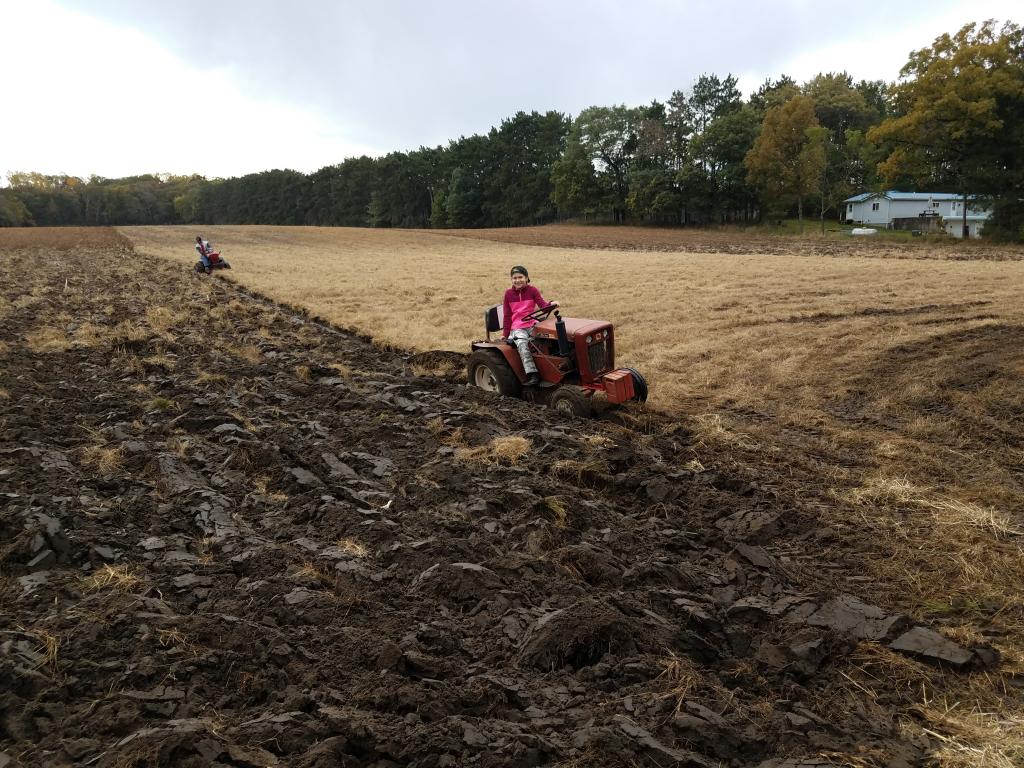

Pullstart 71,215 #182 Posted February 29, 2020 10 hours ago, PeacemakerJack said: I know Jim...once it gets in your blood...look at Kevin @pullstart One of these days we have to get to a serious “spring” PD. Something more than a few passes in a short field. It is too long to wait for October every year...good times! 10 hours ago, WHX24 said: Agreed Jack... maybe a field around here just to get our shine on ?!?! You guys are welcome to come over here and plow an acre or 20 👍 @Greentored these fellas are preaching gospel, best you listen up for some heavenly furrows! I drove my girls around the pond we call Lake Michigan just to attend Uncle Jim’s plow day last year at the J&C Stables and Homestead. We had a blast getting rained out and turning ground and will hope to attend annually just for the chance to stretch the Horses’ legs and see some good friends! 1 3 1 Share this post Link to post Share on other sites

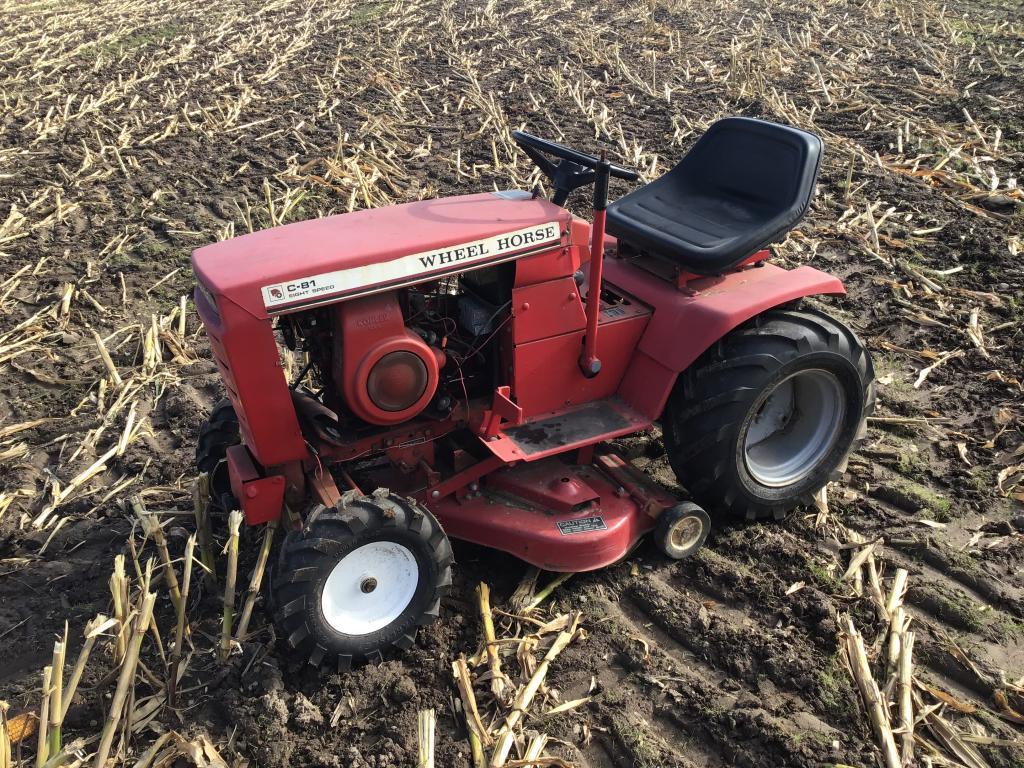

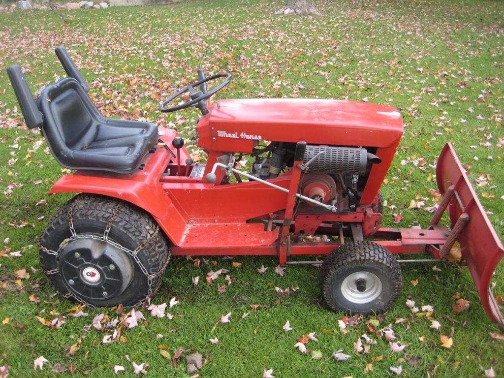

Pullstart 71,215 #192 Posted March 1, 2020 2 hours ago, Achto said: No prob Kevin, you just gotta focus. I have one custom paint job down this winter (not mine), just started mechanical / may be more resto on a tractor (not mine), have a Farmall H that I will be doing a top to bottom on (again not mine), & finally there is one of my tractors that I want to get done plus keep up a 40 to 58 hour work week. I've set my dead line to get all of this done for the end of June. My goal may be out there but like Yoggie once said " If you don't set goals, you'll never reach them. Or like they say in golf, if you aim for nothing, you'll hit it every time." The golf saying we go by is “swing hard in case you hit it!” We’ll see how far we get with a plow mule build. There’s the C-81 “Steve” that looks like it would do aright in a furrow, but then again “Stormy” The 1056 already has the plow dog seat with arm rests... and maybe a limited slip in that 6 speed? 2 1 Share this post Link to post Share on other sites

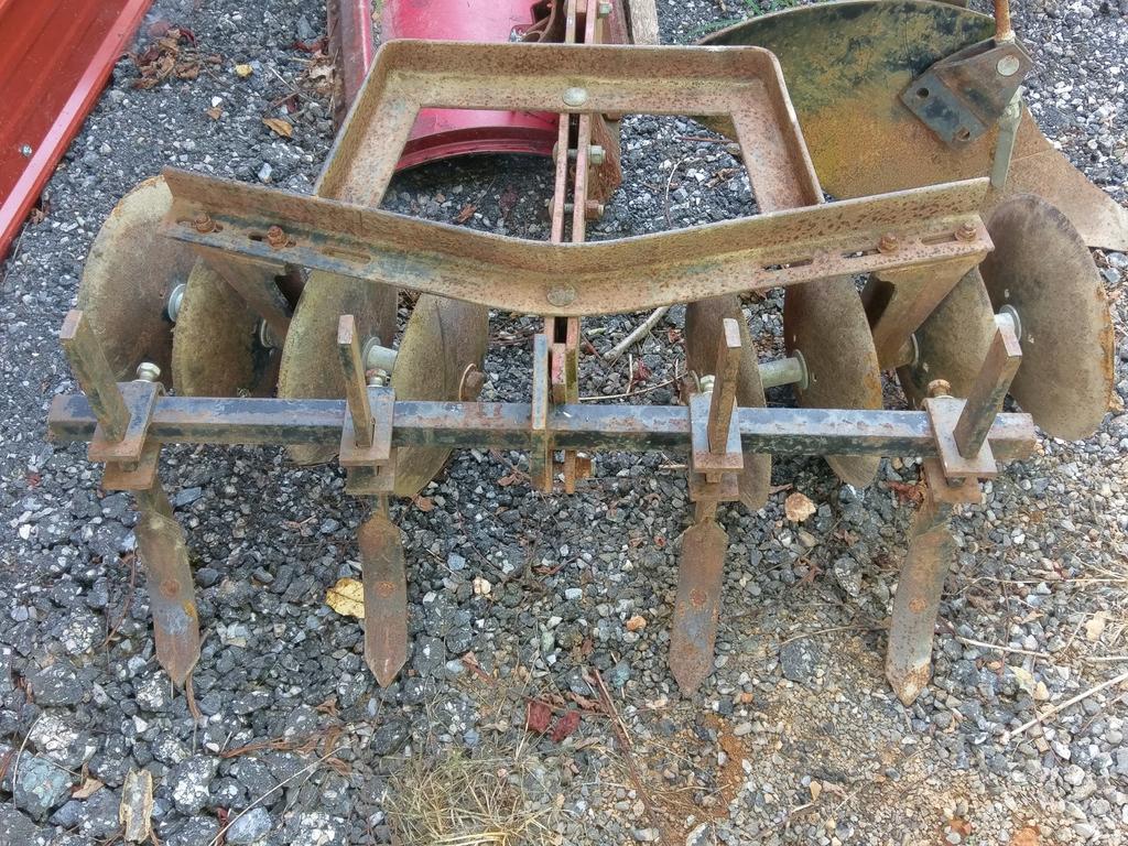

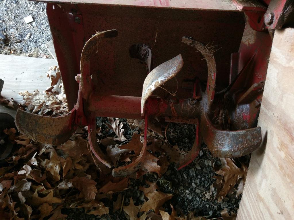

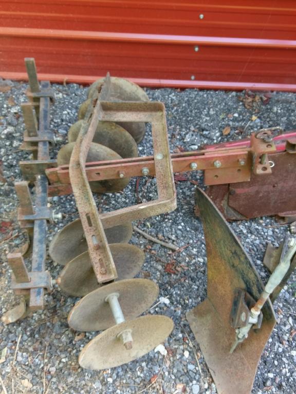

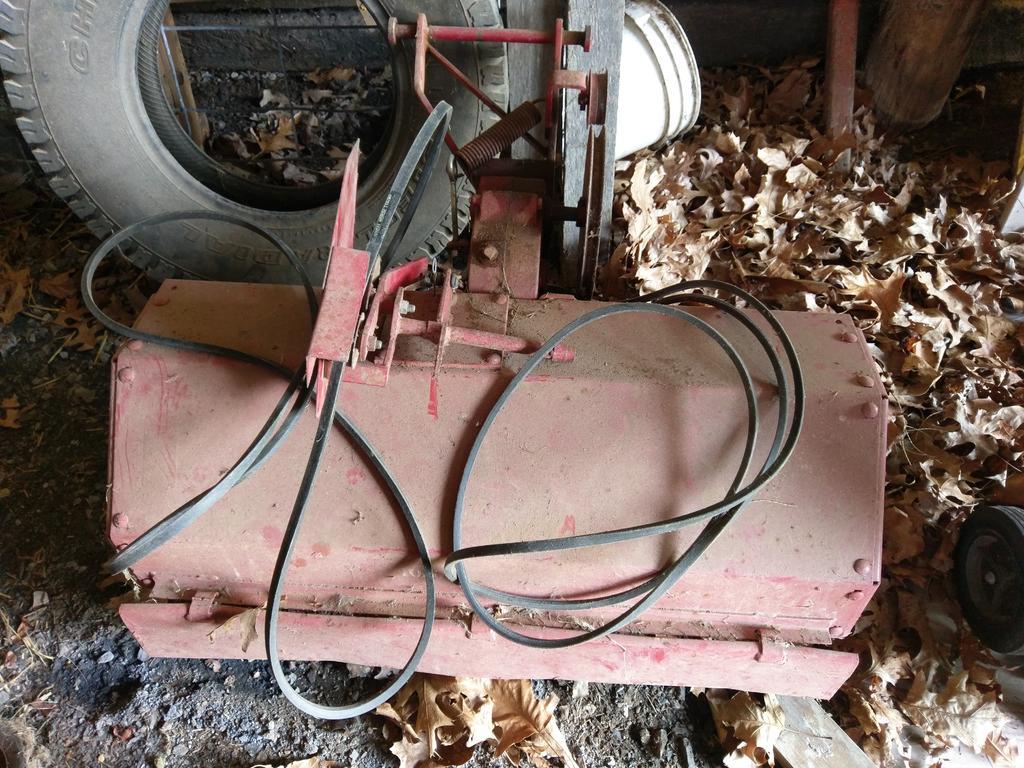

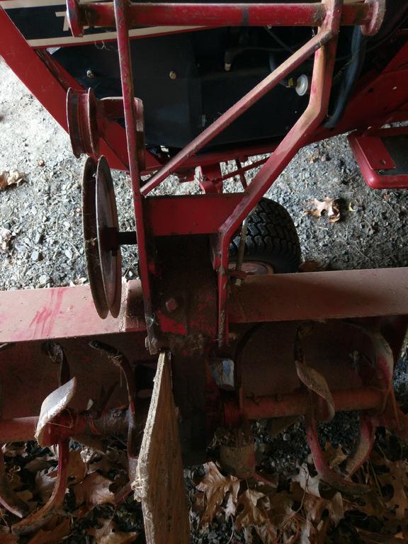

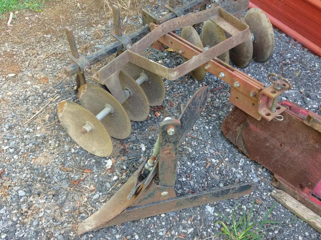

WVHillbilly520H 10,379 #197 Posted March 19, 2020 @Greentored you need you one of these "all in one garden tool"... And a tiller. 2 1 Share this post Link to post Share on other sites
Stormin 9,988 #198 Posted March 19, 2020 After ploughing/plowing and going over with the disc's, the ground can still be lumpy. It's a good idea to rotorvate, if you have a rotovator. 1 Share this post Link to post Share on other sites

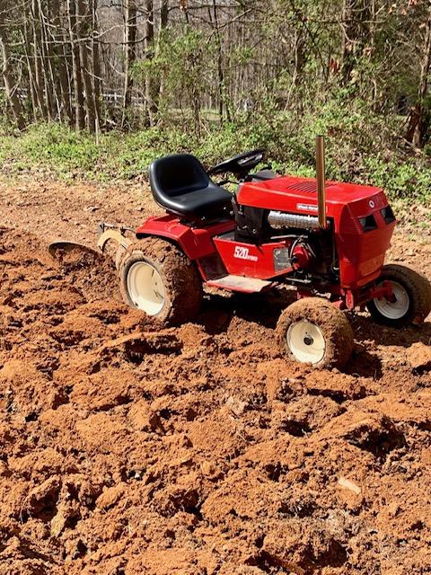

Greentored 3,221 #199 Posted March 23, 2020 Yep, I see a tiller attachment in the future for sure. We've had a lot of rain, definitely made the plowing a little tough but it is time to get some stuff in the ground so it had to be done. It disc'd up pretty good considering, certainly much easier when its a fresh turn. On a good note, you guys were a GREAT help getting this plow dialed in, but I was still having issues with depth and a clean cut. I found that when crossing ANY slight 'raise' in the ground, the chain from the rock shaft was still going into a bind and would lift the plow out of the dirt, even though I had slack when dialing in on blocks. I also noticed the plow 'tilting' back and raising the landslide 3-4" when digging in- I was not snugging up the jamb nut on the adjustment, allowing the adjuster to slide back n forth. That ol girl digs and snorts now ill tell ya! Taters, carrots, onions, beets and peas are in! Beans, squash, cukes and peppers next month. 1 1 Share this post Link to post Share on other sites
