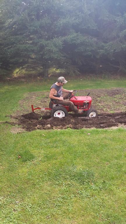

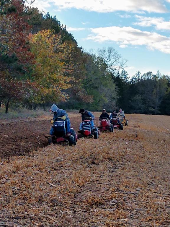

Rp.wh 1,104 #108 Posted July 16, 2019 I have done this 3 year in a row it's a blast!!! And like always great good and friends and plenty to plow. Couple pic from last year  3 3 Share this post Link to post Share on other sites
roadapples 6,987 #109 Posted July 16, 2019 Musta' had a laser on that lead tractor to get the rows that straight 2 1 3 Share this post Link to post Share on other sites

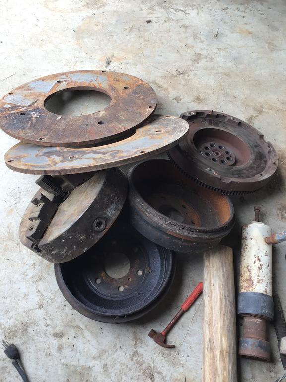

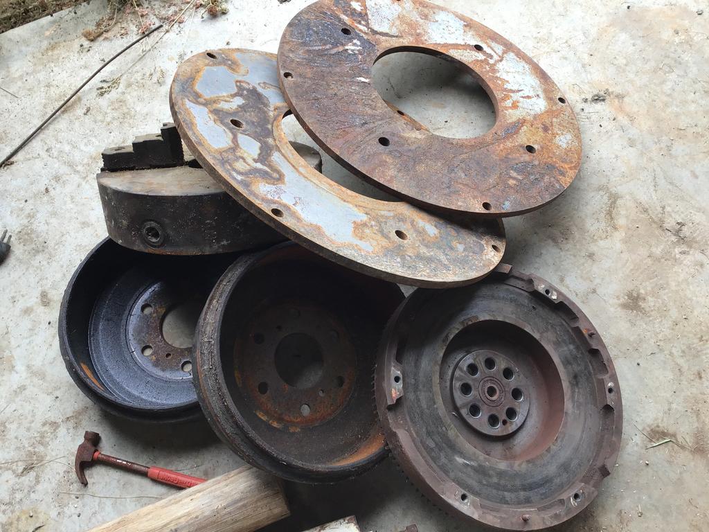

Pullstart 71,215 #111 Posted July 16, 2019 I found some heavy stuff... the flywheel and the lathe chuck would be cool, the drums fit in the wheel and would be practical and even allow the hub caps to remain, and the big 1/2” plates would about cover the wheels and tires! 3 Share this post Link to post Share on other sites
Tractorhead 9,217 #112 Posted July 16, 2019 19 minutes ago, pullstart said: I found some heavy stuff... the flywheel and the lathe chuck would be cool, the drums fit in the wheel and would be practical and even allow the hub caps to remain, and the big 1/2” plates would about cover the wheels and tires! Sounds interesting. i imagine, that the Brakedrums welded together with the Plates and filled with concrete.. before 2 or better 4 longer threads in and you be able to screw them outside the rims. shall be working.. and be usable wheelweights for nearly nothing. 3 1 Share this post Link to post Share on other sites
Achto 32,637 #113 Posted July 16, 2019 (edited) 1 hour ago, pullstart said: I found some heavy stuff... the flywheel and the lathe chuck would be cool, the drums fit in the wheel and would be practical and even allow the hub caps to remain Set the brake drums up with studs welded to the back for easy install & removal, fill them full of concrete and you'll have a cheap set of wheel weights. That lathe chuck has to weigh a bit, I think that it would look pretty cool hanging off of the front. Will the wheel weights off of that Sears fit on Hot Wheels any where? Or is the bolt pattern wrong? Edited July 16, 2019 by Achto 1 1 Share this post Link to post Share on other sites
Pullstart 71,215 #114 Posted July 17, 2019 4 hours ago, Achto said: Set the brake drums up with studs welded to the back for easy install & removal, fill them full of concrete and you'll have a cheap set of wheel weights. That lathe chuck has to weigh a bit, I think that it would look pretty cool hanging off of the front. Will the wheel weights off of that Sears fit on Hot Wheels any where? Or is the bolt pattern wrong? Good point about the hanging weight, I’ll see what Imcan come up with there! The Sears weights fit a 12” Wheel, maybe I could make the drums into an adapter between the truck wheels and the GT weights’ bolt pattern! 1 1 Share this post Link to post Share on other sites

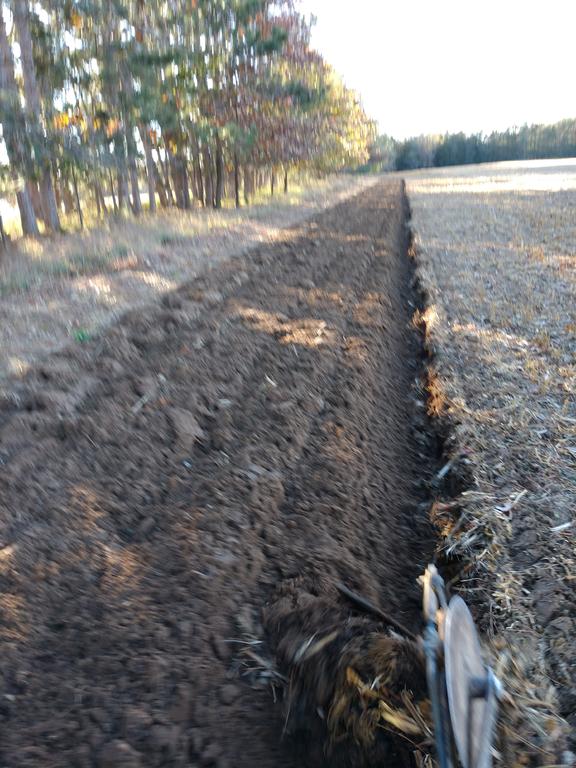

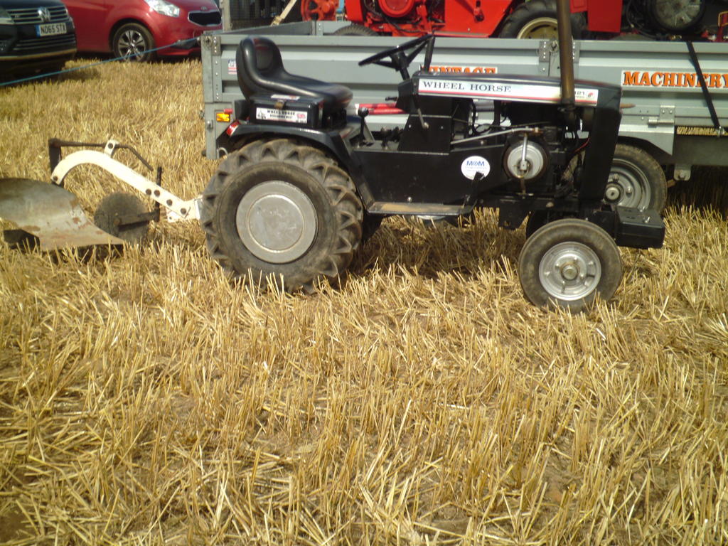

Pullstart 71,215 #115 Posted July 22, 2019 I found this in the videos section of @C-101plowerpower Koen running the plow. Is the un-used blade similar to a coulter wheel? When is it necessary to use a coulter or this type of blade? Only plowing virgin soil? Not really at all with a 4 wheeled tractor? 1 Share this post Link to post Share on other sites
Achto 32,637 #116 Posted July 22, 2019 (edited) 1 hour ago, pullstart said: Is the un-used blade similar to a coulter wheel? When is it necessary to use a coulter or this type of blade? Only plowing virgin soil? Not really at all with a 4 wheeled tractor? I can't say that I've ever saw a blade like that in use, not really sure of its purpose. The purpose of a coulter wheel is to cut through trash (corn stalks, wheat or oat stalks, sod etc) to give a cleaner cut & help prevent the plow from plugging. I've found that on a GT plow with a coulter wheel that they seem to plug up more often. This is not true in all cases though. I may start with a coulter and then opp to take it off if the plow is plugging up frequently. I have also heard of cases where the ground was partially frozen, that the coulter would prevent the plow from sucking into the ground. Edited July 22, 2019 by Achto 1 Share this post Link to post Share on other sites
WHX?? 58,074 #117 Posted July 22, 2019 I seldom run the coulter. At my plow daze the type of soil and beans coming off a coulter is just not needed. 1 Share this post Link to post Share on other sites
C-101plowerpower 1,606 #118 Posted July 22, 2019 3 hours ago, pullstart said: I found this in the videos section of @C-101plowerpower Koen running the plow. Is the un-used blade similar to a coulter wheel? When is it necessary to use a coulter or this type of blade? Only plowing virgin soil? Not really at all with a 4 wheeled tractor? the unused blade where the coulter usually sits? normally these are used on bigger plows in combination with the coulter to roll under manure and stubble. on these little plows they dont do anything other than scratching the surface and cause a build up of stuff thats otherwise plowed under. my plow came with some sort of coulter replacement welded to the plow shear 1 1 Share this post Link to post Share on other sites
Pullstart 71,215 #119 Posted July 22, 2019 5 minutes ago, C-101plowerpower said: the unused blade where the coulter usually sits? normally these are used on bigger plows in combination with the coulter to roll under manure and stubble. on these little plows they dont do anything other than scratching the surface and cause a build up of stuff thats otherwise plowed under. my plow came with some sort of coulter replacement welded to the plow shear Good to hear from you, Koen! It looks like you’ve been busy with your car adventures! Share this post Link to post Share on other sites
C-101plowerpower 1,606 #120 Posted July 22, 2019 6 minutes ago, pullstart said: Good to hear from you, Koen! It looks like you’ve been busy with your car adventures! have been quite busy with all the car related stuff and havent been doing much with the horse of lately, but im getting back into the swing of things 1 1 Share this post Link to post Share on other sites

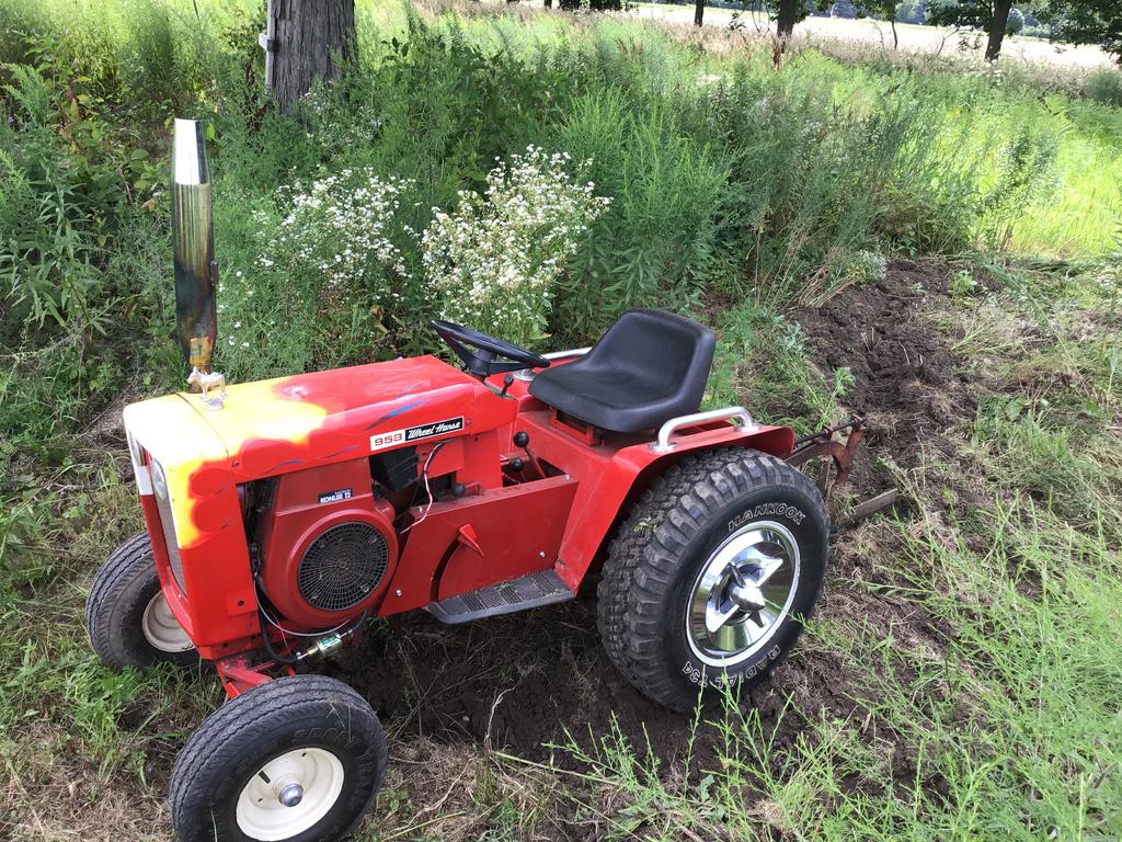

Stormin 9,988 #122 Posted August 9, 2019 I got myself a Brinly 10" plough/plow a while back. Made a hitch to fit the Black Horses slot hitch.. Thanks to Squonk for sending me the measurements. Tried it out a couple of weeks back. Did three decent furrows then the lift linkage broke. Went back to a manual lift early this year, as the electric lift was to slow. Looks like this now, though the plough, due to the broken lift, is cocked up to clear the ground. 2 Share this post Link to post Share on other sites

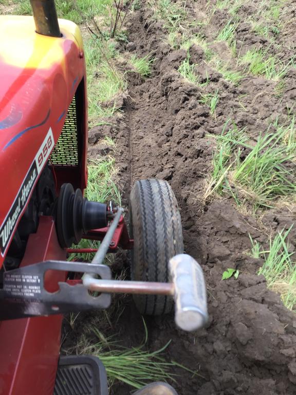

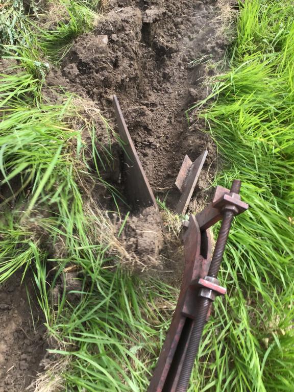

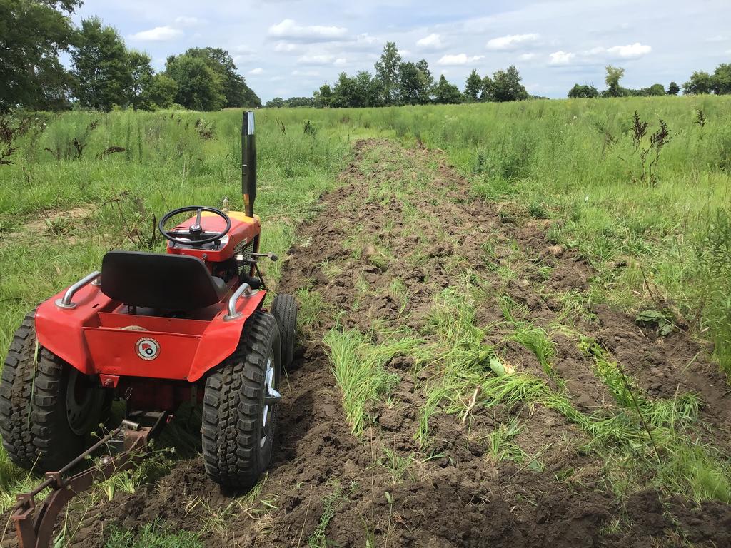

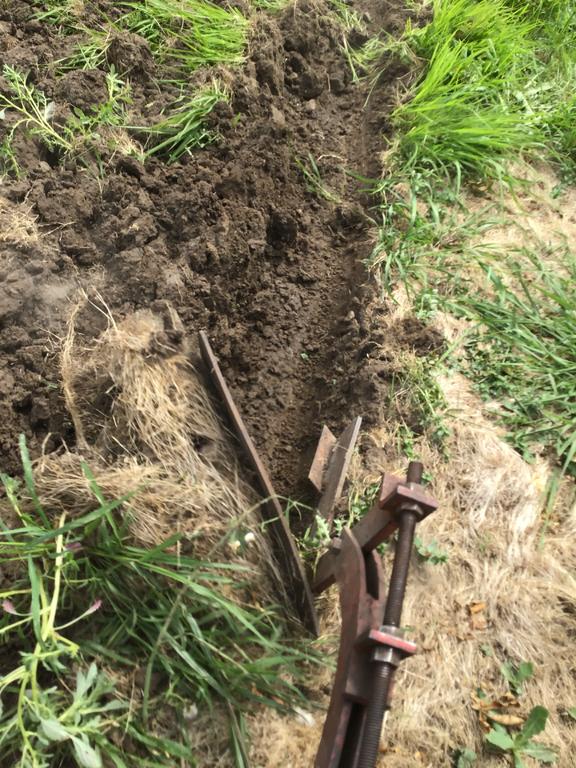

Pullstart 71,215 #123 Posted August 12, 2019 For record keeping here, I attempt to do some plowing with Hot Wheels yesterday! I think the ground was too hard to get a great furrow, but it was decent at least! The share? (back tail piece) was sticking way up, which tells me it could have dug deeper, but it just wouldn’t dig much. I settled with the fact that I wasn’t getting any deeper and started to adjust the plow so the share was closer to the ground. Once Hot Wheels started acting up a bit, I decided another day would be alright... but improvements were made along the way! 2 2 Share this post Link to post Share on other sites
WHX?? 58,074 #124 Posted August 12, 2019 Ya you need to come to plow daze and get educated! Looks like your angles were not quite set up with the rear end, properly called the land slide, up like that. With well rooted grass/weeds like that it might have been best to use a coulter but a application of round up a couple of weeks ahead might have been preferably. Was the share nice and shiny? Looks like the furrows weren't rolling as should but real tough to do in that kind of soil with out a good setup. Looks like ya got seat time anyway! 2 Share this post Link to post Share on other sites
C-101plowerpower 1,606 #125 Posted August 12, 2019 a nice shiney plow shear will help alot, looks like the plow is rolled to much towards the land side, ie set up for a deeper furrow and thus more angle on the tractor. once you've fixed that the plows heel, the sticky out bit should be prettymuch flat with the ground. even in hard soil it should work 1 Share this post Link to post Share on other sites
