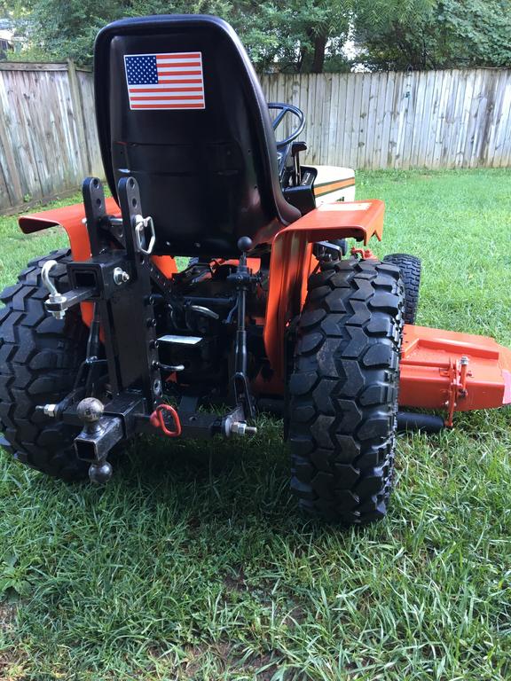

Tankman 3,528 #1 Posted September 2, 2018 I have a very nice set of 12" cast rear wheel weights. Allergic to the plastic thingys. For my '90 520-8, snow plowing season, would like to find weights for the Horse's 8" front wheels. Any good sources known? I keep finding plastic but, need my iron. Have made rear weights in the past. Posted pic for the do-it-yourselfers. Lots of brake drums at the junque yard. 1 Share this post Link to post Share on other sites
