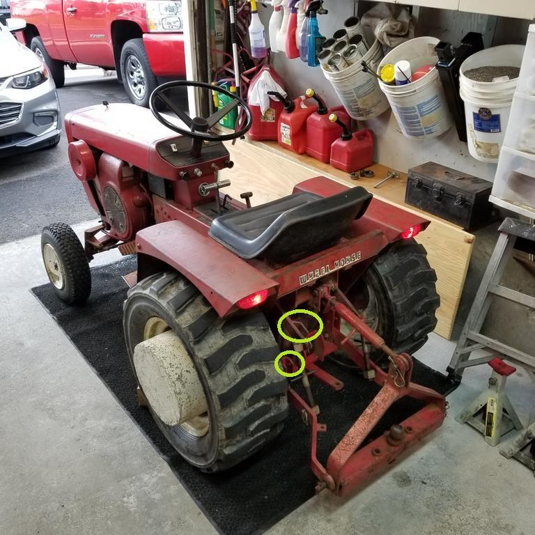

HorseWhisperer 243 #1 Posted August 31, 2018 Picked this up a couple months ago and was sceptical as I am of most Hydrogear Sunstrands.I have gone through all fluid/filter changes and got to the hydro inspection/tune.No relief spring issues,no broken pawl.This stud will climb a wall.I picked up several cat 0 implements but I just noticed there is no down pressure on this three point.Is there supposed to be?I had a 69 electro that had down pressure.Why wouldn't this beast 3 Share this post Link to post Share on other sites

KC9KAS 4,744 #5 Posted September 1, 2018 There was another option for the GT-14....a 2nd hydraulic cylinder on the 3 pt lift with a 2nd control valve. This allowed you to have mid AND rear hydraulic lifting capabilities at the same time. 1 Share this post Link to post Share on other sites
HorseWhisperer 243 #6 Posted September 1, 2018 15 minutes ago, KC9KAS said: There was another option for the GT-14....a 2nd hydraulic cylinder on the 3 pt lift with a 2nd control valve. This allowed you to have mid AND rear hydraulic lifting capabilities at the same time. Omg,I dont jow how it would be better 1 Share this post Link to post Share on other sites
953 nut 60,382 #7 Posted September 1, 2018 13 minutes ago, KC9KAS said: There was another option for the GT-14....a 2nd hydraulic cylinder on the 3 pt lift with a 2nd control valve. This allowed you to have mid AND rear hydraulic lifting capabilities at the same time. The unit @HorseWhisperer has here is set up for that type hook up. The cylinder would connect to the two points I have circled in green. 1 2 Share this post Link to post Share on other sites

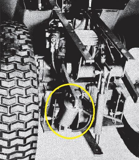

ztnoo 2,300 #8 Posted September 1, 2018 I don't see the second control valve handle on your machine either....... Cylinder needed is outlined in yellow. 1 1 Share this post Link to post Share on other sites
HorseWhisperer 243 #9 Posted September 1, 2018 1 hour ago, 953 nut said: The unit @HorseWhisperer has here is set up for that type hook up. The cylinder would connect to the two points I have circled in green. Sweet lord you guys are getting good at this technology stuff 🤣🤣🤣 1 Share this post Link to post Share on other sites
HorseWhisperer 243 #10 Posted September 1, 2018 44 minutes ago, ztnoo said: I don't see the second control valve handle on your machine either....... Cylinder needed is outlined in yellow. I thought that was for a 12v actuator option.Now I see the light.I had a commando 8 years ago that had a 12v electric brinley hitch much like that. Share this post Link to post Share on other sites
