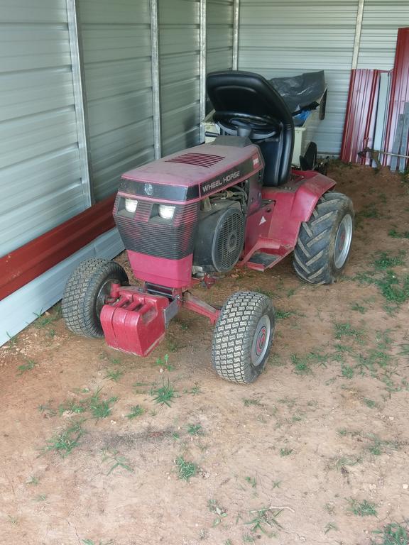

Tankman 3,528 #3 Posted September 2, 2018 Be sure to have front weight. My first plow, wheels off the ground. Fab’d a front bumper, added suitcase weights. Share this post Link to post Share on other sites

Daron1965 644 #5 Posted September 2, 2018 6 hours ago, Tankman said: Fab’d a front bumper, added suitcase weights. How did you make the bumper? Looks great. Share this post Link to post Share on other sites

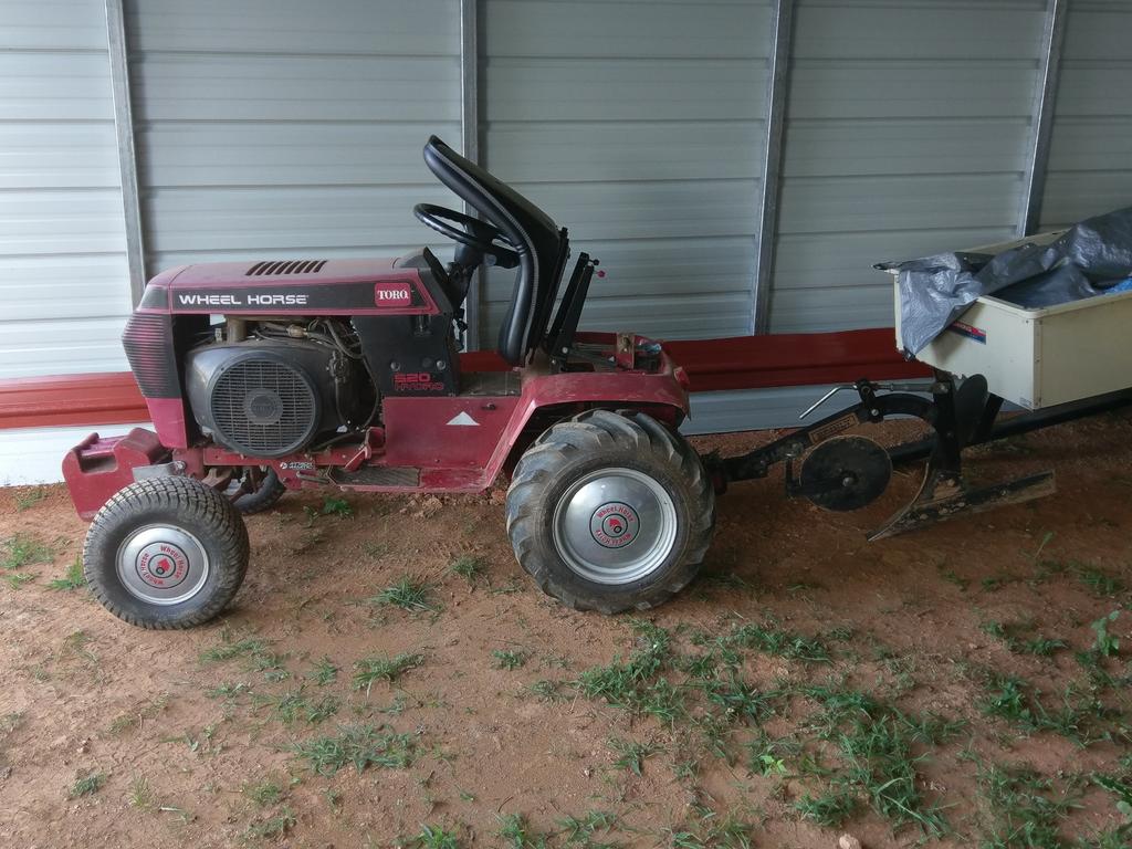

Daron1965 644 #6 Posted September 2, 2018 Just installed my plow today for the first time. It's a 10 inch plow, so I lifted the left side 5 inches and then adjusted plow. 3 Share this post Link to post Share on other sites
Tankman 3,528 #7 Posted September 2, 2018 3 minutes ago, Daron1965 said: How did you make the bumper? Looks great. Fab’d 10 ga CRS, welded. Bolted to existing frame bolt holes. Pic is a son, 40 years ago, 1 Share this post Link to post Share on other sites

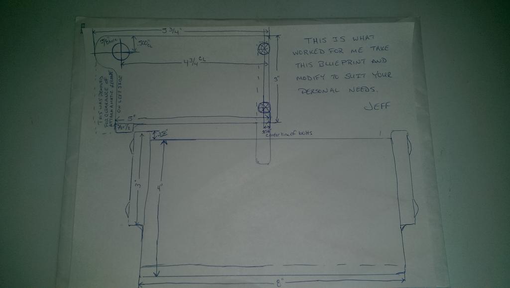

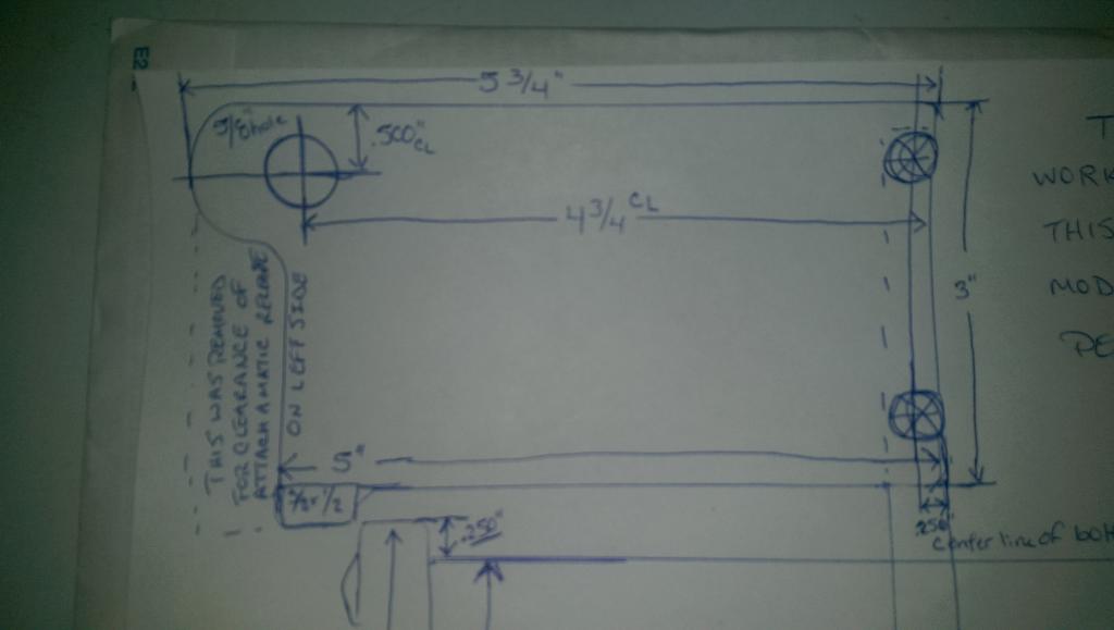

WVHillbilly520H 10,378 #8 Posted September 2, 2018 1 hour ago, Daron1965 said: How did you make the bumper? Looks great. Here's my blue prints... I don't have ability to make anymore, but a decent machine shop shouldn't have any problems. 2 1 Share this post Link to post Share on other sites
Daron1965 644 #9 Posted September 3, 2018 Great info. Thank you 1 Share this post Link to post Share on other sites
