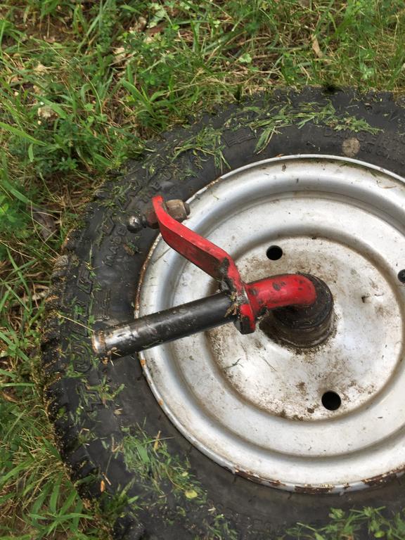

bigcreek 205 #1 Posted August 27, 2018 (edited) Good afternoon I have a new to me, 314-H, crossing a small ditch I broke the front axle down low on the right side where the wheel spindle comes out the bottom. Not fixable ordered and received a replacement. Is this a fix I can do remove and replace, or do I need a shop to do this, I would like to try it have a place to do the repair. Side note another tractor, 417 - 8 with snowblower has popped up local for 700, it also has the side discharge deck, he is asking 700. I may grab it for the extra attachments Thanks Edited August 27, 2018 by bigcreek Add images 1 1 Share this post Link to post Share on other sites
WHX?? 52,898 #2 Posted August 27, 2018 Should be able to do it yourself but many of us here are well rounded backyard mechanics. We wouldn't be afraid to coach you on it. 1 Share this post Link to post Share on other sites
Pollack Pete 2,273 #3 Posted August 27, 2018 (edited) Is it the axle that broke? Or the spindle? I've seen lots of spindles break but never an axle.Easy fix as long as you have the parts. Edited August 27, 2018 by Pollack Pete Share this post Link to post Share on other sites

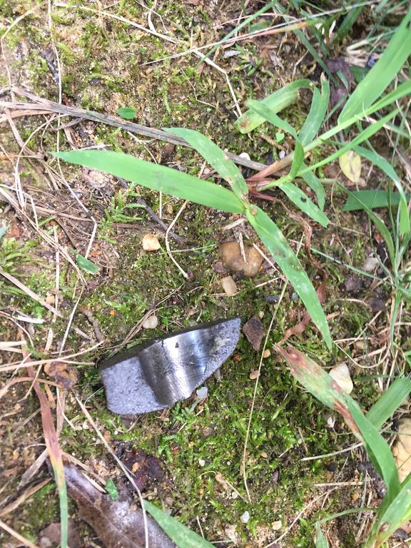

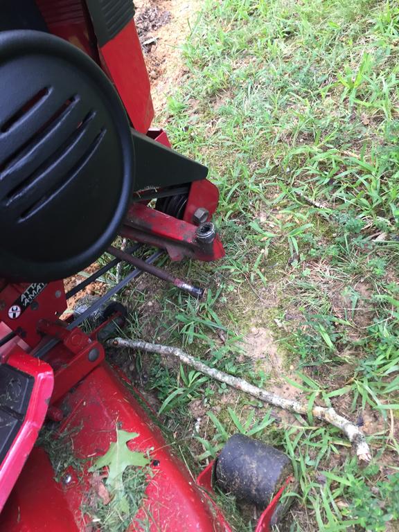

bigcreek 205 #4 Posted August 27, 2018 (edited) Here are some views of the axle ive got a used replacement in hand be glad for any advise, keep it clean please these old mowers are a father daughter project. She is interested in a trade school. Nice opportunity to fix something and keep em mowing Edited August 27, 2018 by bigcreek 1 Share this post Link to post Share on other sites

Pollack Pete 2,273 #7 Posted August 27, 2018 Looks like your tie rod is broken too.Ouch……... Share this post Link to post Share on other sites
bigcreek 205 #8 Posted August 27, 2018 I think the tie rod went and the impending toe out put too much pressure on the axle. I have ave not ordered the spindle yet Share this post Link to post Share on other sites
Skipper 1,790 #9 Posted August 27, 2018 Perhaps the spindle is OK. Check for play on the new axle. It should be a snugish fit. I would recommend changing tierods in both sides. Rod ends are a good, cheap and stronger solution, and real ball joints is the best solution 1 Share this post Link to post Share on other sites
WHX?? 52,898 #10 Posted August 27, 2018 but no problem, see @wheelhorseman for a replacement. 33 minutes ago, Pollack Pete said: but never an axle You have now Pete 24 minutes ago, bigcreek said: keep it clean please these old mowers are a father daughter project. Only way we will have it Are you saying you got a whole new axle? If so replacing it is easier than you may think if you have even just basic hand tools. I would hold off on a spindle although they are readily available. You may not need one. 4 Share this post Link to post Share on other sites

953 nut 62,157 #12 Posted August 27, 2018 1 hour ago, bigcreek said: keep it clean please these old mowers are a father daughter project. She is interested in a trade school. Nice opportunity to fix something and keep em mowing This is a family friendly site and we enthusiastically support the younger generation becoming involved in . As others have said a few hand tools will get this job done. The pivot pin that retains the front axle is held in place by one 3/8" bolt (9/16" wrench) The tie rods will require a 1/2" and a 9/16" wrench. That and a couple of jack-stands and you will be in business. Feel free to post any questions you may have. This manual should come in handy. 1 4 Share this post Link to post Share on other sites

JAinVA 4,638 #15 Posted August 27, 2018 (edited) On a more serious note the damage to the front axle and tie rod could have also damaged the fan gear or steering shaft pinion. The steering wheel is attached to a shaft which travels down towards the frame.Check to make sure none of the gear teeth are damaged.You can see the meshing gears with a flash light and no covers need to be removed. Edited August 27, 2018 by JAinVA 1 Share this post Link to post Share on other sites
