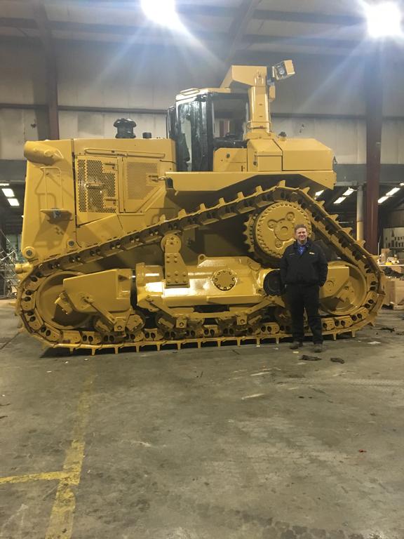

Machineguy 877 #18 Posted August 24, 2018 (edited) At work this very task is the first step in a very large job. Sometimes the undercarriage and roller frames of D11 Cats can be carrying a ton (literally a ton) of grease and dirt buildup. For Cat certified rebuilds such as the one I’m standing in front of in the picture below, cleaning and disassembly are a huge task that is often the most laborious. Most folks don’t have an appreciation for the amount of work involved with this. We do have solvents and washing equipment that work well but aren’t delicate and it’s still tough work. I know you guys can appreciate the effort that goes into jobs like these and on our red machines we enjoy so much! Just for scale, that’s me standing in front of our latest D11 Certified rebuild and I’m 6’2” Edited August 24, 2018 by Machineguy 11 Share this post Link to post Share on other sites

Jerry77 1,218 #21 Posted August 24, 2018 4 hours ago, Machineguy said: D11 Cats Watched a D 11 Cat with a clamshell work it's way thru a farm ( making way for a highway) with barns and an old house and some of the biggest trees I have seen...MY oh My...what a powerful machine..every boys dream of course is to tear up stuff...I wasn't a kid at the time, but it sure was a spectacle - especially walking huge trees out of the ground... 3 Share this post Link to post Share on other sites
Machineguy 877 #22 Posted August 24, 2018 9 minutes ago, Jerry77 said: Watched a D 11 Cat with a clamshell work it's way thru a farm ( making way for a highway) with barns and an old house and some of the biggest trees I have seen...MY oh My...what a powerful machine..every boys dream of course is to tear up stuff...I wasn't a kid at the time, but it sure was a spectacle - especially walking huge trees out of the ground... Thanks for sharing that! The power is unbelievable as you said. We see parts come in off these machines that are so wrecked it’s unbelievable. You just can’t hardly imagine how such massive parts can be pulverized!! 1 Share this post Link to post Share on other sites
